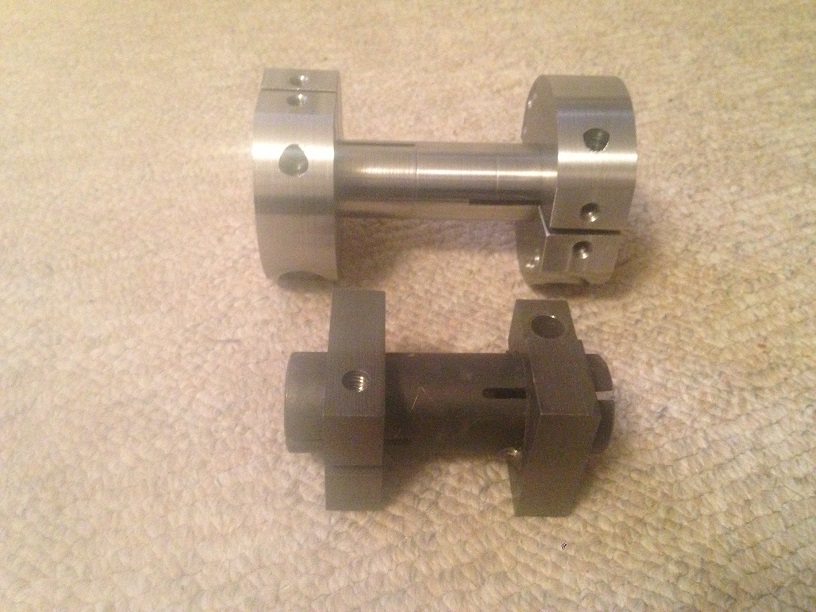

Time for an update. Unfortunately it’s only a tiny update, as my other project car (a ’98 V70R) had raised a finger and demanded attention. Lots of attention. Bloody saffron princess of evil.
Anyway, last week I could finally collect the new, stronger flange that I had made:
Looks like an Arnold Schwarzenegger-memorial-dumbbell.
Quite likely it is now the strongest part of the drivetrain. And yes, it does fit into the torque tube, with about 1mm to spare all around.
Comparison to original part:
Measurements:
Length: 120mm (original part: 80mm)
Diameter: 73mm (original part: 64mm diagonal)
Weight: 1.499g (original part: 457g)
The length might be a problem when assembling the drive train. On the plus side, the contact surface is a lot longer.
The weight difference is significant, but I have been assured that it’s not a problem. The diameter is small enough. Of course it has been balanced.
Changes are:
- Only two slits instead of three
- Two bolts per clamp instead of one
- M12 screws for the clamp instead of M8
- Two grub screws per M12-Screw to lock the screw instead of ...err… none
- Stronger clamps
- Stronger stainless steel
To access the screws, I will have to drill new holes into the torque tube.

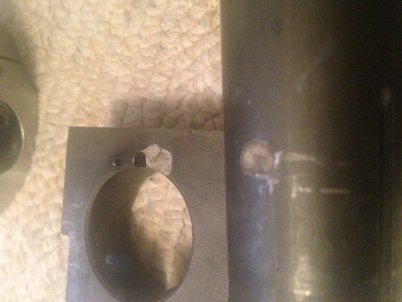

The welding point of one of the original part’s clamps has broken, taking a chunk of cast iron with it:
This won’t happen with the dumbbell…
Measurements:
Changes are:
- Stronger clamps

Re: Project: Volvo 360 GLT for the Volvo-Trophy
Interesting clamp, have you got a price and supplier? Very interested to hear how it holds up.
I did think that normal steel was stronger than stainless, stainless is brittle, but the oversize may compensate, and the bigger bolts less critical on torque. We need an aftermarket part anyhow. I do wonder why Volvo didn't use a sleeve with maybe a locating bolt. Works for the clutch and diff!
The original clamp is certainly tightly engineered howver I believe it works when used as the designer intended with new bolts and an accurate torque wrench, up to around 250bhp. The weld is just to position the clamp, I presume it broke when the bolts failed.
