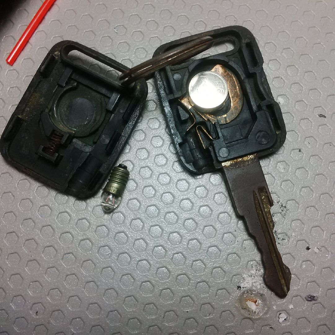

Battery or bulb. If bulb, convert to LED > http://e30.bmwdiy.info/key-led/

Thanks, i'll refer the thread. It's very coated with carbon.. but the battery size looks different..

Although the detail may be slightly different, the principle is pretty much the same. A lot of cars in the late 1980s had these wee light up keys. I think the BMW ones were made by HUF too.

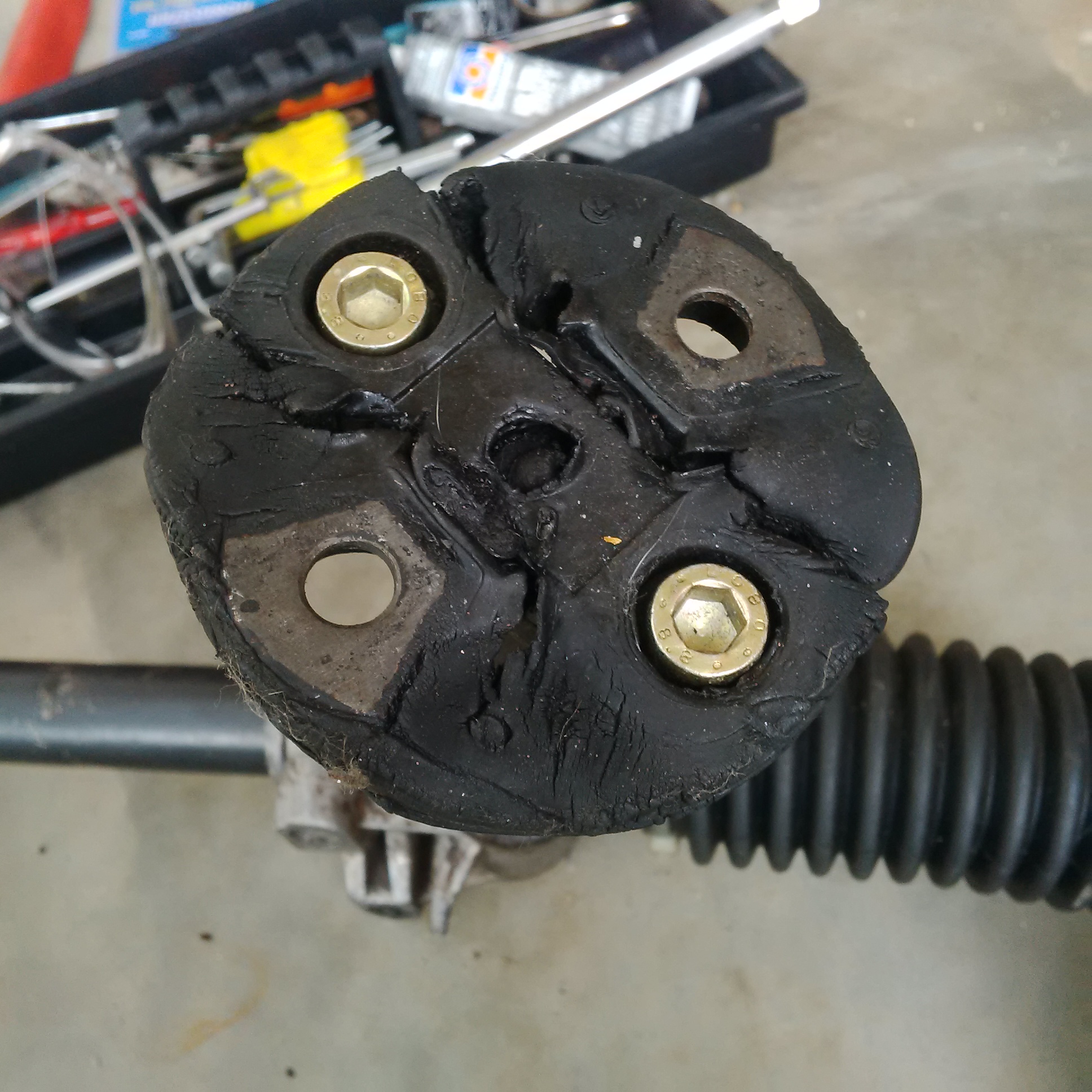

At last i completed the job, took me 3 hours. I only need to tighten the coupling joint. The trouble is when i tighten it clockwise the steering turns..a sign for good steering rack..need some friend to hold the steering. Next is to do the allignment.
Zack
checked..good to go..
New coupling that i bought, torn from heavy steering turning.
coupling from the evil car
Job well done
Job well done

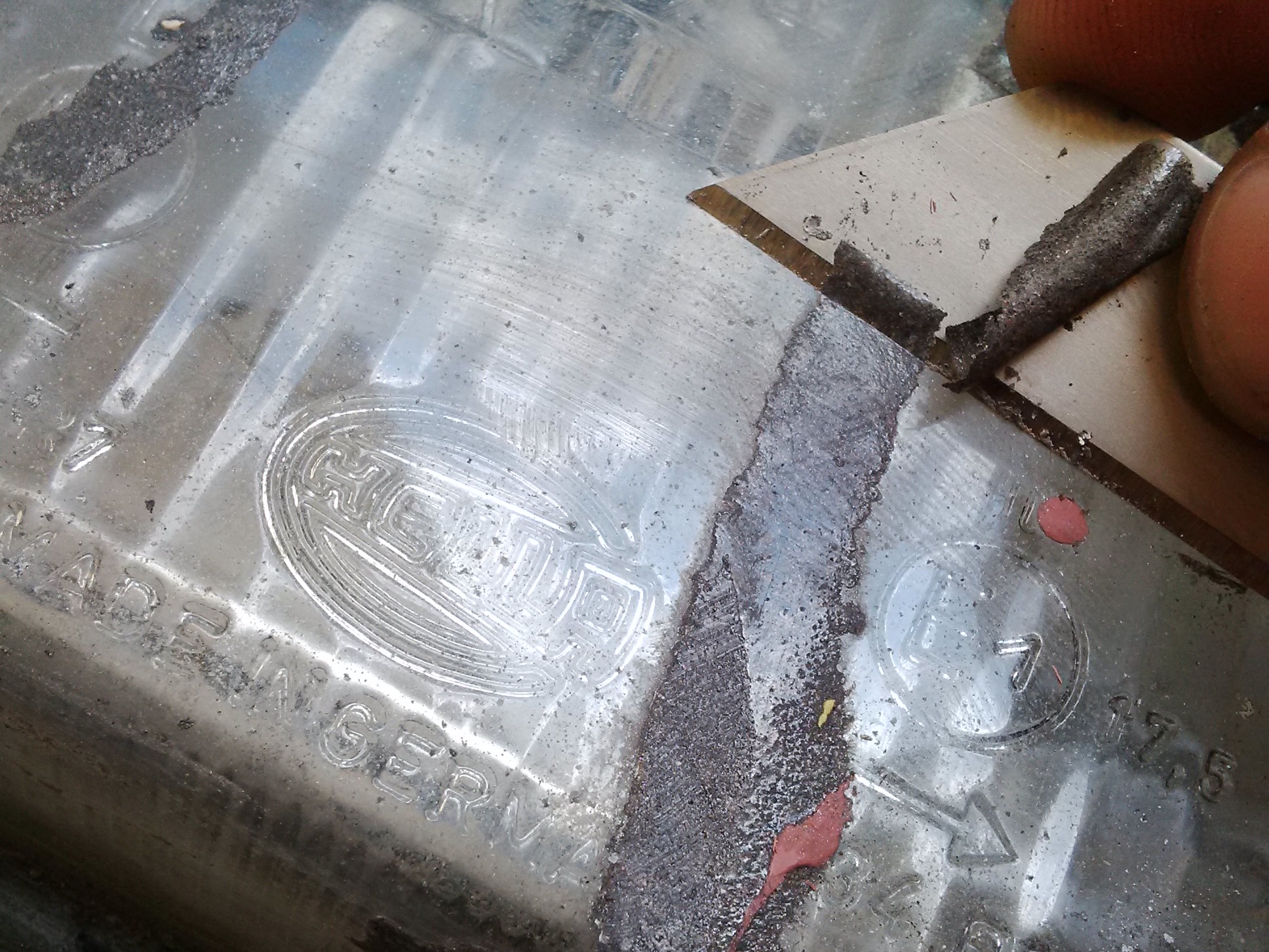

Still a lot more to do to restore this orange i called it..i didn't know why i have interest in 360..most of my buddy play with 240,740, 940 and S series..the 360 seems to have a life of it's own. No i'm gonna create a blog here... sm6 FYI local foreman / mechanic will avoid to repair volvo 360. Maybe it's not as easy as other continental car and the parts too..very hard to get. It's not interchangeable with other volvo maybe a bit engine parts from 940 and 240. Now back to orange, i'm going to replace the headlamp i got from the evil car.. :lol:..yes it's evil..i opened it up..the clip that hold the glass is full of rust. The reflector inside starts to wear, can i repair it? what is the material that they use? i saw one in classic swede still available for 20pound, do you have a pair of it? classic swede? Any way, i cleaned it, removed all the evil dirt. Reassemble it back and see if it shine brighter..shine on you crazy diamond.!! :D
Who on earth would want to restore that?? I would..
The lense is good condition..only the housing is plastic and have been aging
Walllaaa...
Walllaaa...

What on earth have they put on there? I have cleaned the lenses with some water and soap, and they where as new. The reflector a gently cleaned with some toiletpaper and glass cleaner, they are very fragile so take it slow and watch out for the chrome flaking off.

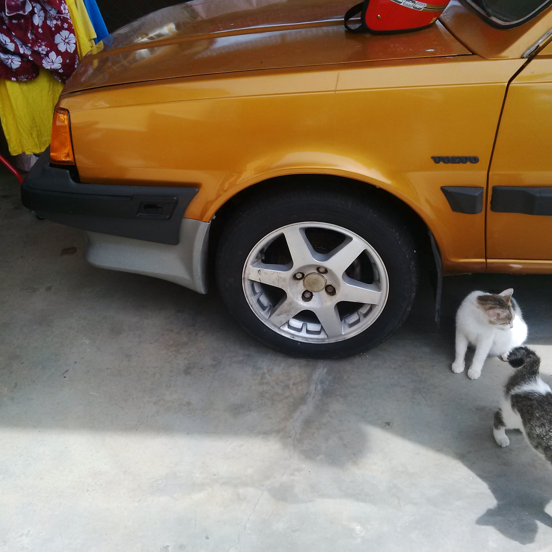

Post by bogbasic »
Man, you need a big socket on the steering wheel nut and open the driver's window so you can stop it turning. The cat looks lovely. Ta bog.
