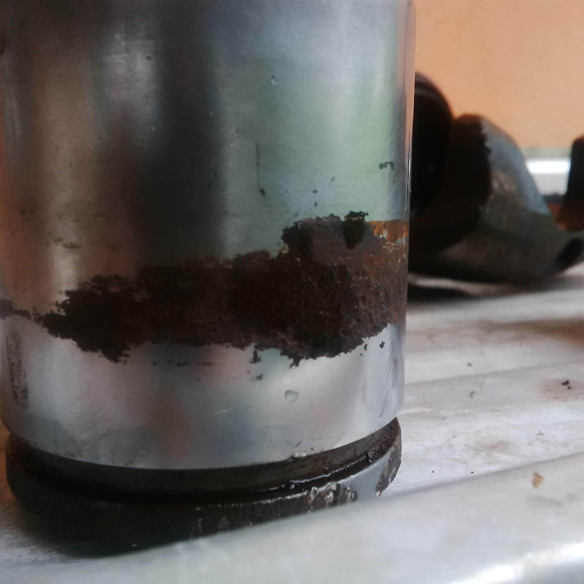

Good Morning, it's 7.28 am here..it should me midnight at UK and europe..so good evening..i removed the servo finally..the hole was too small for my wrench. The solution, a 12 T wrench..cut in half and make it longer by 10 cm, my own special tool. . I Replace the servo from scrappy..servis the brake, and now i'm working on the front brake..man my caliper piston wall is rusted in side. Hey Bogbasic and mac, are those piston the same size as 240's? I'm going to visit the scrappy again if it's not..
