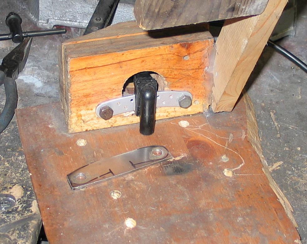

So after some further removal of starter moter and squeezing in the massive 360 starter (orginal seemed a bit slow), rechecking the cam timing I was about to start checking the flywheel when I decided to just swap the coil trigger wires and she burst into life.
I'm using the hot glued 940 CPS at the moment but it seems to give the same electrical results (when turning over) as the 360 one so I am still assuming the 360 one will work, going to order a jetronic connector for it. A good bracket for the 940 CPS can be made fairly easily, but hot glue won't hold for normal running.
If I just shake it will it sort itself out?
Making a jig to make a bracket for the 940 CPS.
