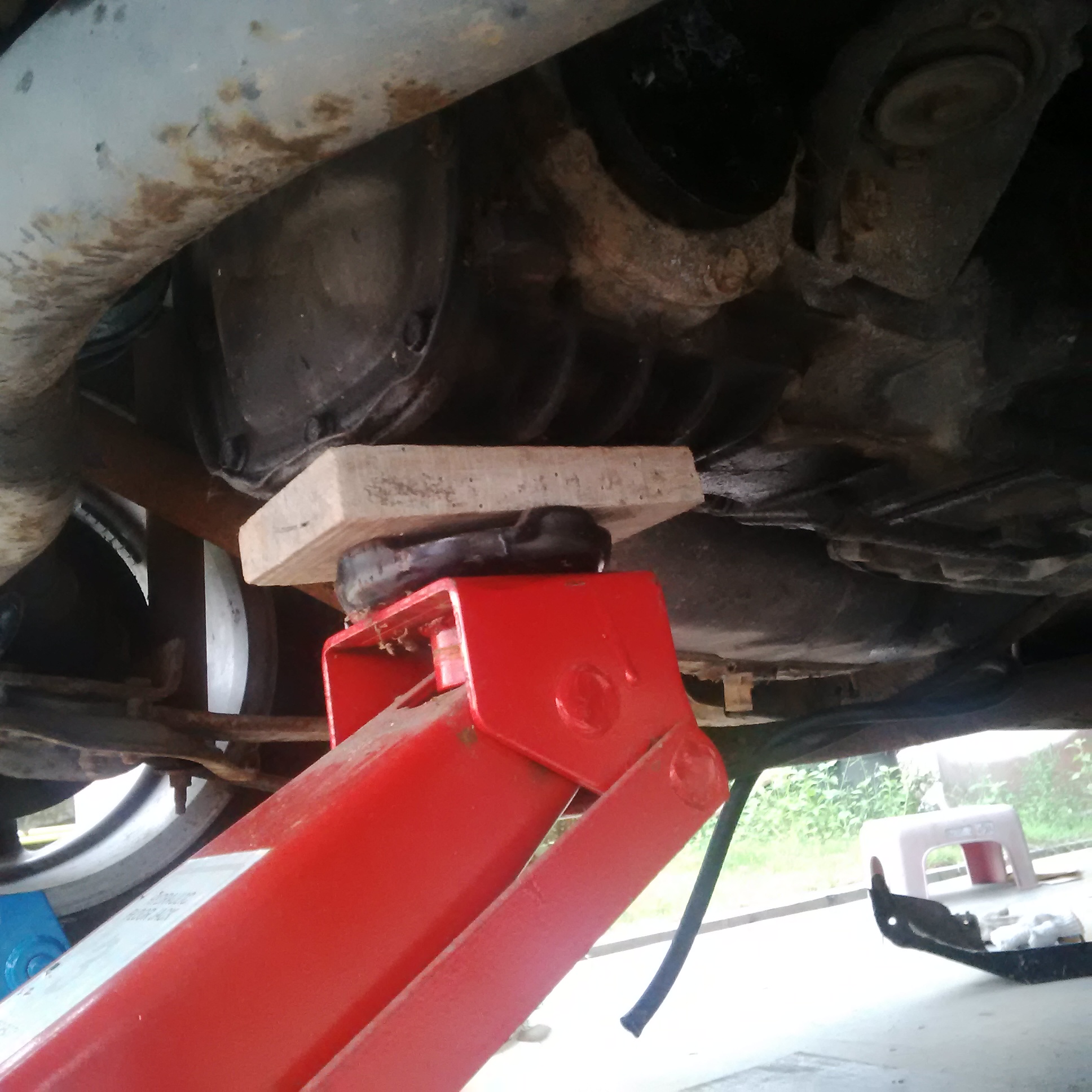

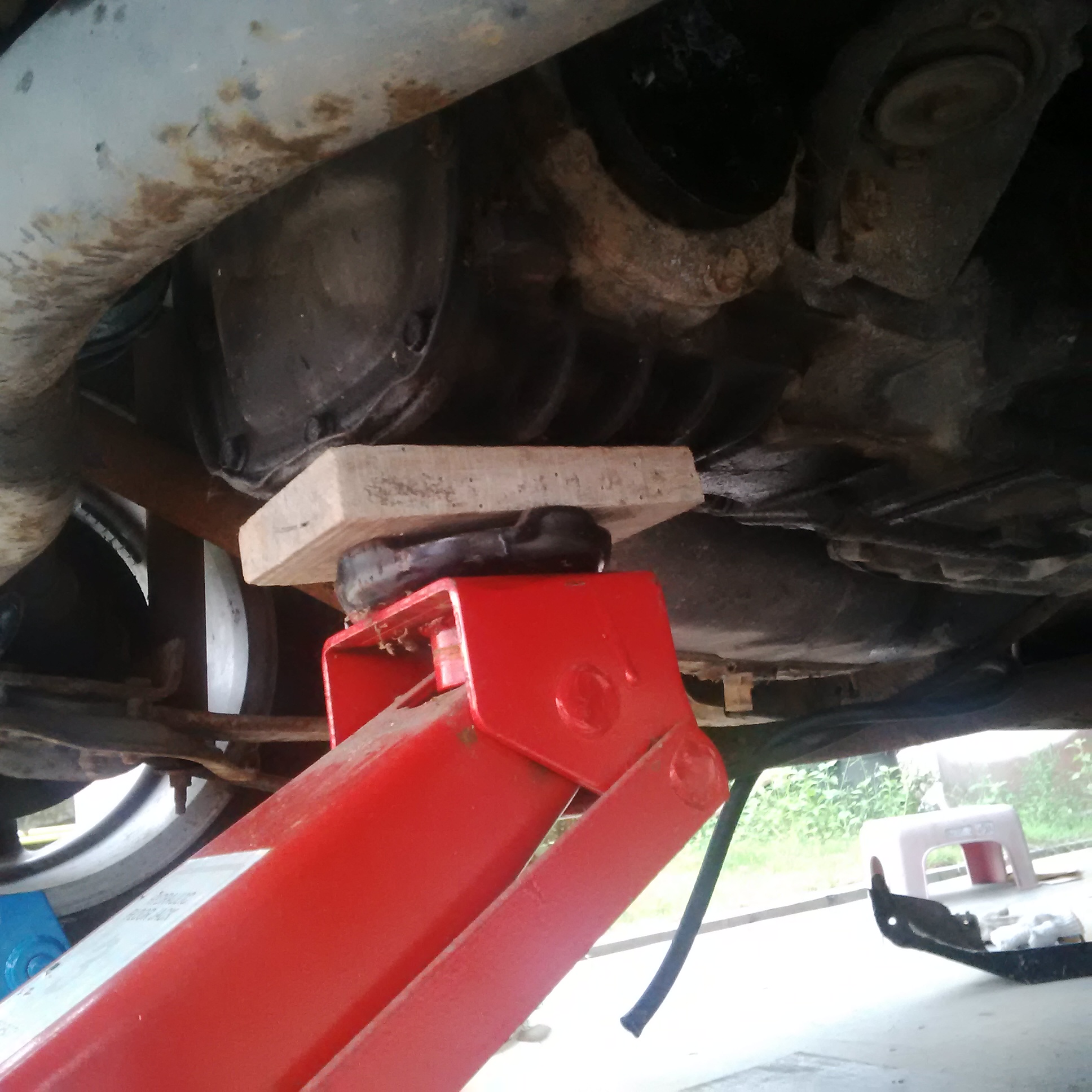

Hello bog, i'm not sure i can find the right size of the bolt if i cut it. Maybe i'll try to apply ride on method. I wasn't sure which bolt that you mention man.. is it number one or number 2? please refer attached picture, i mark the picture with yellow and red, 1 and 2. Please tell me which bolt i need to remove first. Thanks..

Posts: 2240
Post by Ride_on » 30 Sep 2015 08:32 pm
I was suggesting yellow 2 (if you mean the pipe clamp) then yellow 1(there are 2 on each side). I'd also change the metal filler pipe to a plastic one otherwise you'll end up leaking fuel from rust holes, although looks OK at the moment.
If you go the red method, Red 1 will not undo without getting a spanner above and gadget arms :), easy enough to get replacements. Red 2 will unbolt from the diff and you can drop the diff below the dedion tube and pull it off (easier to say than do, but keep wiggling). Diff/gearbox and torque tube can be pulled off all at once if you disconnect the gear lever.

Posts: 2240
Post by Ride_on » 04 Oct 2015 01:37 pm
If you are pulling the gearbox off the propshaft you need the jack in the middle of the weight you need to balance. You can move it around but taking the full weight is not really feasible. It needs to come off straight, ie not trying to sag in the middle, the pressure needs to be off the joint.
One more thing, make sure you remove one of the propshaft clamp bolts completely, it won't come off otherwise.
If you are just pulling the diff off, its simpler but from memory I seem to avoid this, it may be a tighter fit as there are no clamps.
