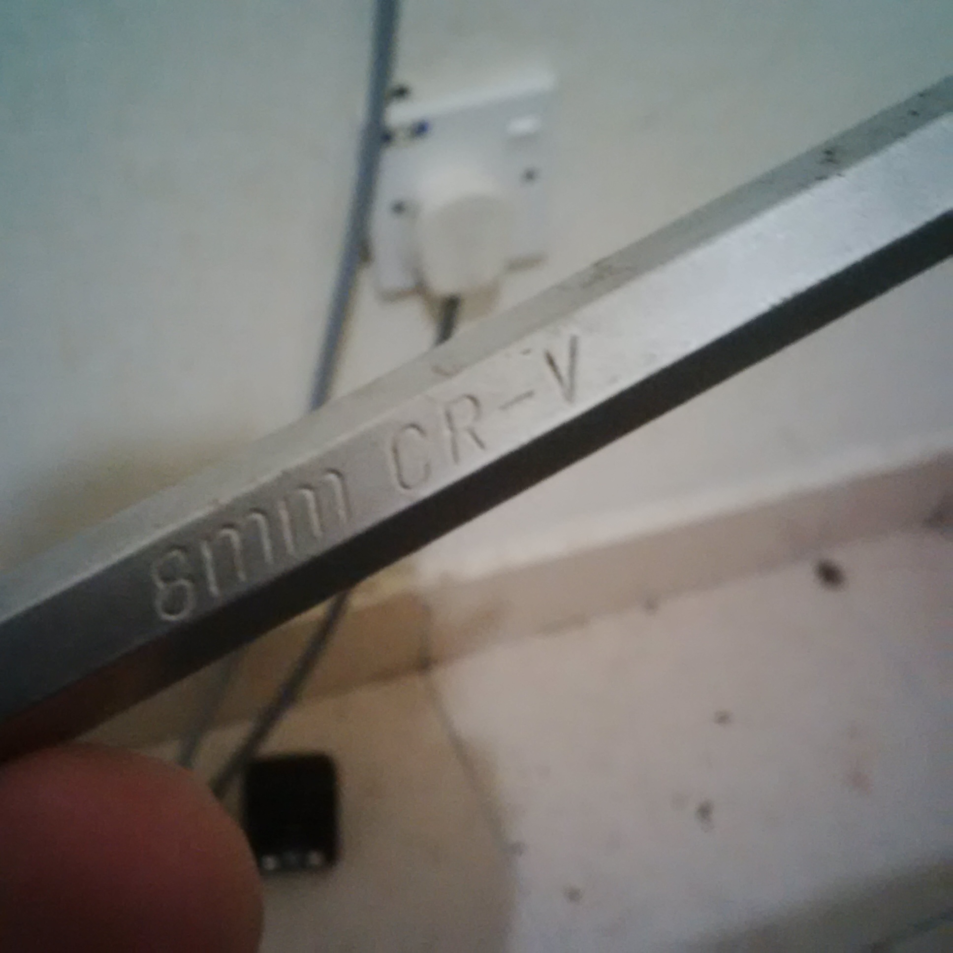

Hello ride on, I just came home yesterday, today, I removed the clamp hose by sawing it of, then I removed the bolts that hold th cross member..it started to fell down bit by bit. Now both sides of the cross member is free, I should have removed the 4 allenkey bolts first right? Otherwise I can' pull th gear box out. Do you have the Allen key size? I'm sure it's more than 8mm. Thanks man.
