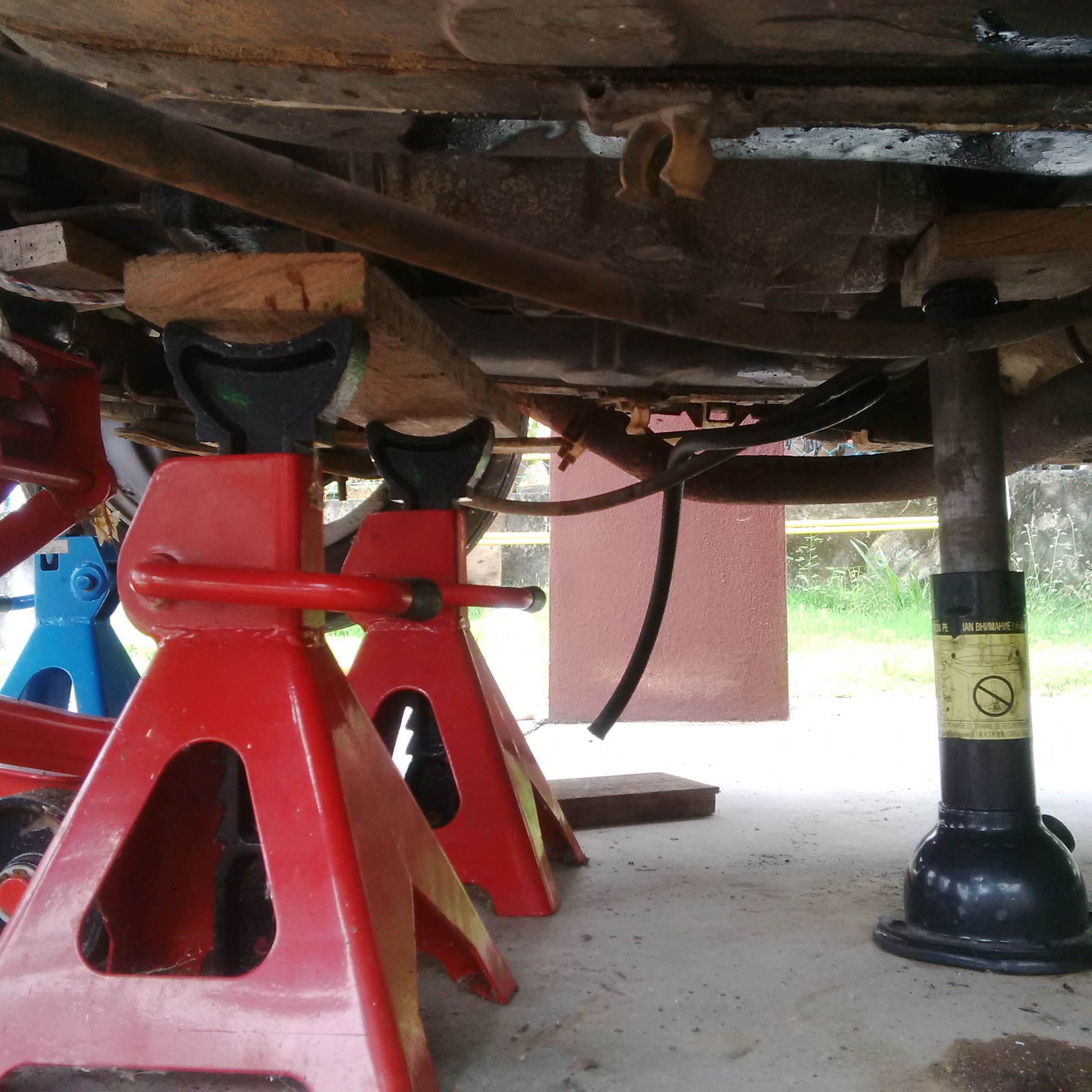

Hello, I figured It out, it's 10mm box allenkey.
I placed the jack in the joint.
Final step

Good stuff, nearly there. But I think you may need to let it dangle downwards to get a good pull on it while supported in the middle. May need kick thumped and wiggled alot. Looks like you've removed the rear axle.
The engine will sit on steering rack, but make sure the engine doesn't hit the bonnet or radiator. Also may need some bits removed at the gear lever to let it drop down.
