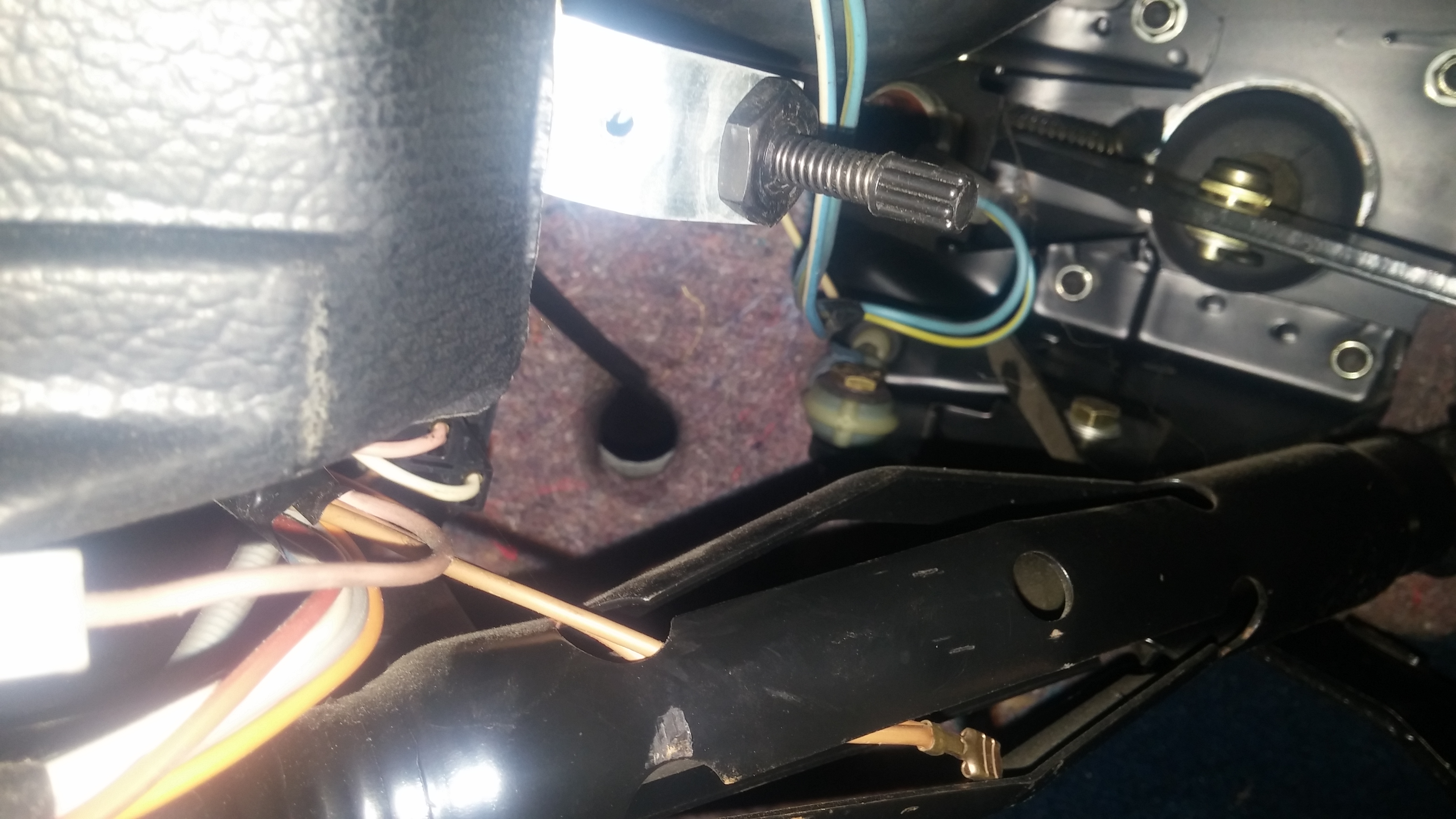

														Just checked the part number for the clock reset wire 3276809volvodspec wrote:also missing the adjuster cable but that's another problem (or if someone has a spare...)
Not as well as it should do these days, no great feat as I'd checked yesterday morningmacplaxton wrote:Your memory serves you well.
														Quick check on my GLS, the brown cable is connected to... nothing! It's simply hanging inside of the steering column.trabitom99 wrote:I'm not sure where this brown cable came from (on this pic between the steering column and the mounting for the clock adjuster cable). We searched for any missing spade connectors, but couldn't find any. The only think I could thing of was that it could have come from the blower switch (it only work's on "3", but I'm guessing that's the usual resistor pack problem) but at 11pm I couldn't face taking that part of the facia panel out as well ...
