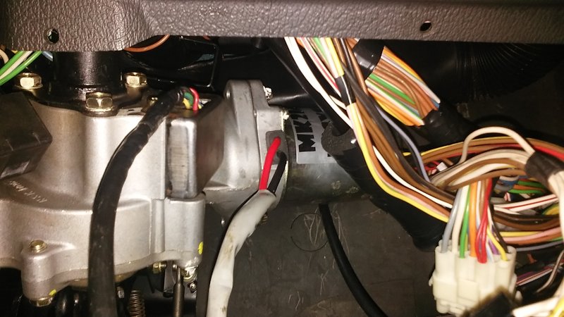

Part way there...
... and here are some views of the underside of the steering column...
... hope this helps. I took the car through a couple of three-point turns in the garage yard and it does work well with the rheostat set about half-way or more.

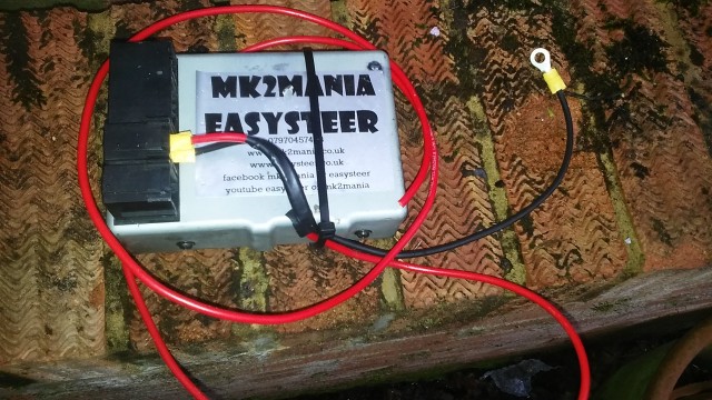

One final technical trick that I forgot to mention is attaching the ECU box to the wiring loom with a couple of Wilko's best self-releasing cable ties (;-0) and note also the intervening bicycle handle-bar grip as a bit of padding to protect the wires which is held on with some tape for good measure.
Another quick check today in the yard showed that it all works well and the Sugru seems to be holding fast.

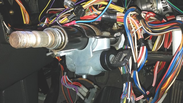

Post by bogbasic »

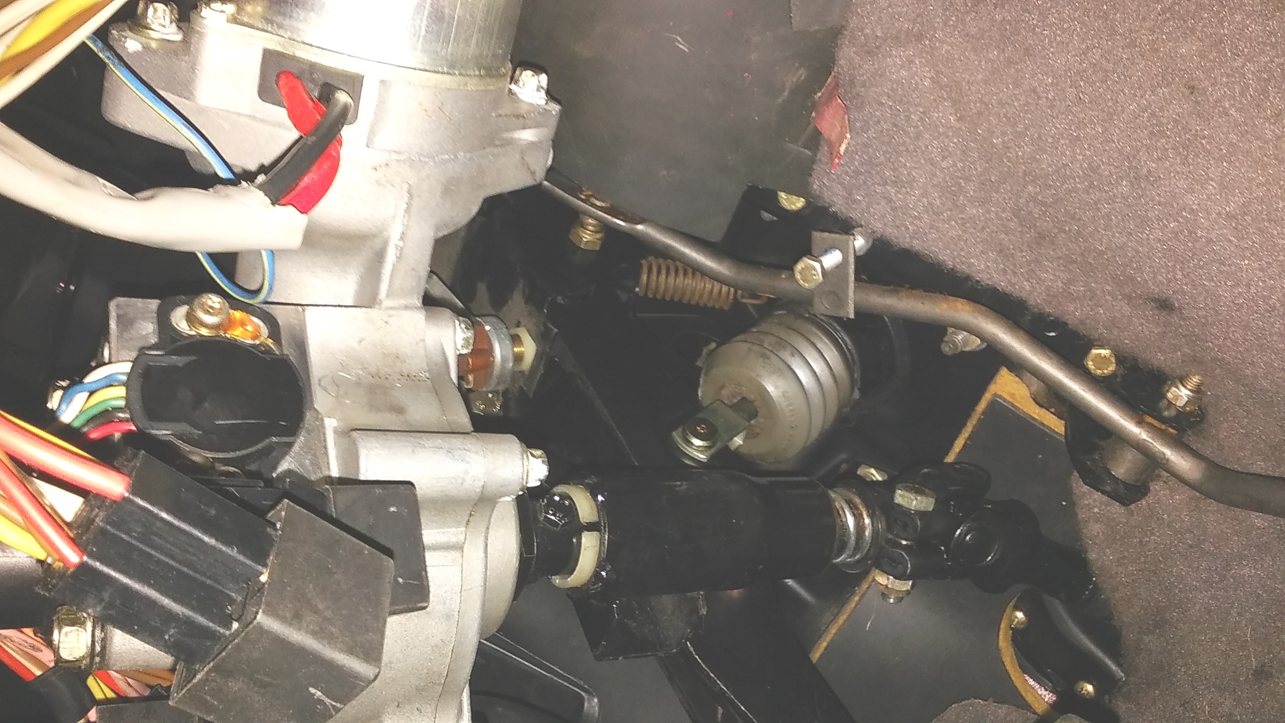

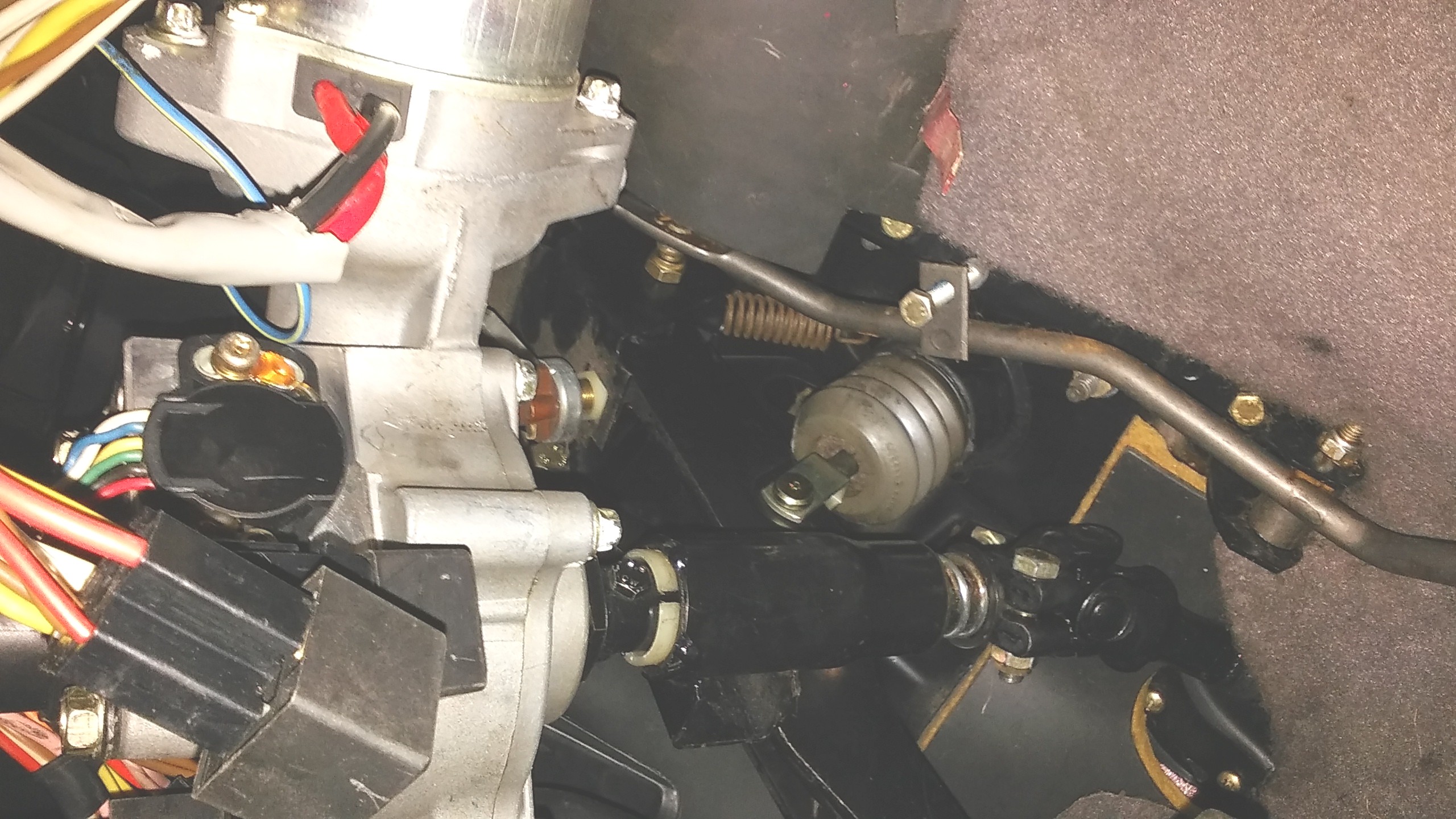

Its all a bit more apart now with the ignition switch and column bracket removed.
ultrablue_column_out 029.jpg (86.65 KiB) Viewed 97438 times

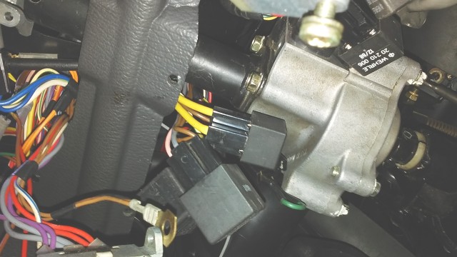

For replacing the relays, here are some notes.
ultrablue_column_out 033.jpg (41.35 KiB) Viewed 97438 times

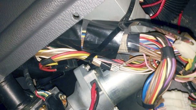

Hello again, long gap in comms. Here is the latest set of photos showing the new EPS being fitted to the beautiful deep blue 1.7...
... so far so good.
Re: Electronic power steering progress.

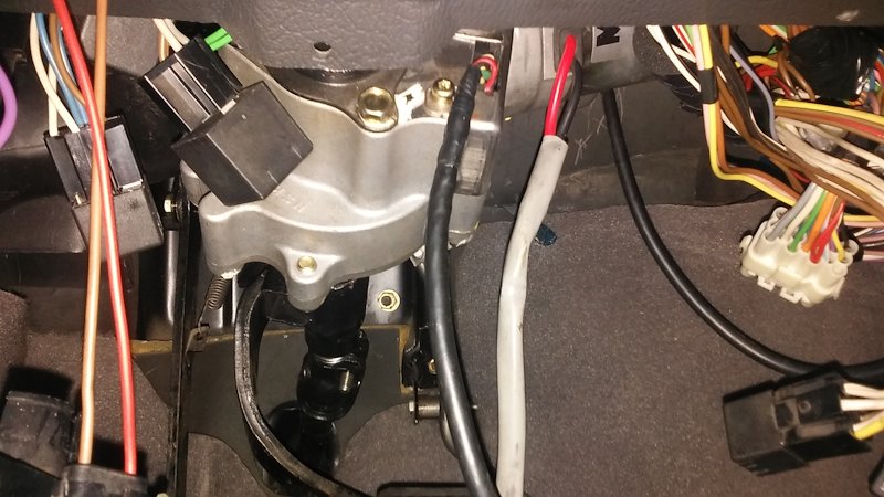

Post by bogbasic »
Hello again folks, a bit more progress on the power steering for the deep blue beastie.
It is all wired in and seems to work well when tested, so it shouldn't be long now.
N.B. I think I had the black and white wires the wrong way round at this point which causes the power steering not to work. I also remember that one of them had to be connected elsewhere in the end to make sure that the PS only came on when the ignition was switched on, otherwise it stays on all the time and presumably drains the battery or knackers itself in no time at all. So whilst the black and white wires look wonderful slotting into that connection block, it is actually incorrect to wire it this way, sorry!!
