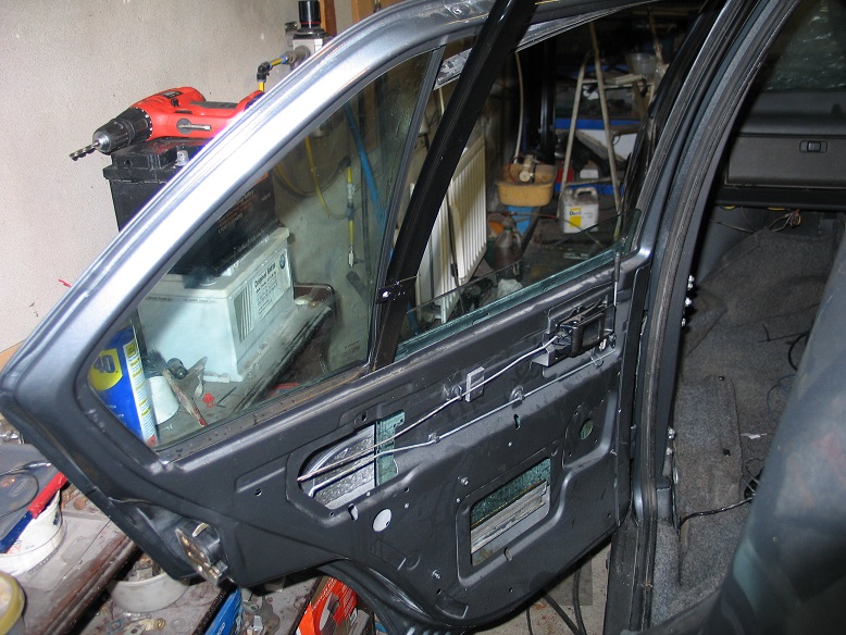

Question for you guys, I have put the rear quaterlight glass back in and the metal strip, but now i can not get the glass to go in, how the hell do you reassemble the rear doors, is there a guide out there?

Assume you got this sorted but for the record I think the key is to put both windows in first, then the middle channel which gets riveted at the top.
Put the window in first
Then put the channel in
Sorry I didn't did this out earlier

Ride_on wrote:Assume you got this sorted but for the record I think the key is to put both windows in first, then the middle channel which gets riveted at the top.
Yes configured it out, but thank you.
