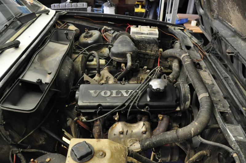

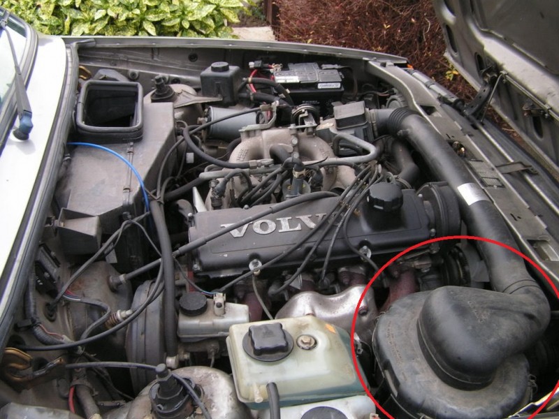

Hi, my VOLVO has a big empty space under the hood and I found a picture of a car with something in that place.
I wonder what is that piece for and if my car is either missing it or it is just a version that didn't come with it, since I also found another picture that looks just like my car. I don't have my car here to take photos but it has some marks like saying that something used to be there.
Thanks in advance
Mine looks like this
This is the part
This is the part

The top one is a carb model and the bottom is injection.
Re: What is this piece for?
Post by bogbasic »
Its the air filter housing.

What Bog said, you will have a carburettor so have a panel filter and the injection one has an oval filter the other side of the engine bay.
