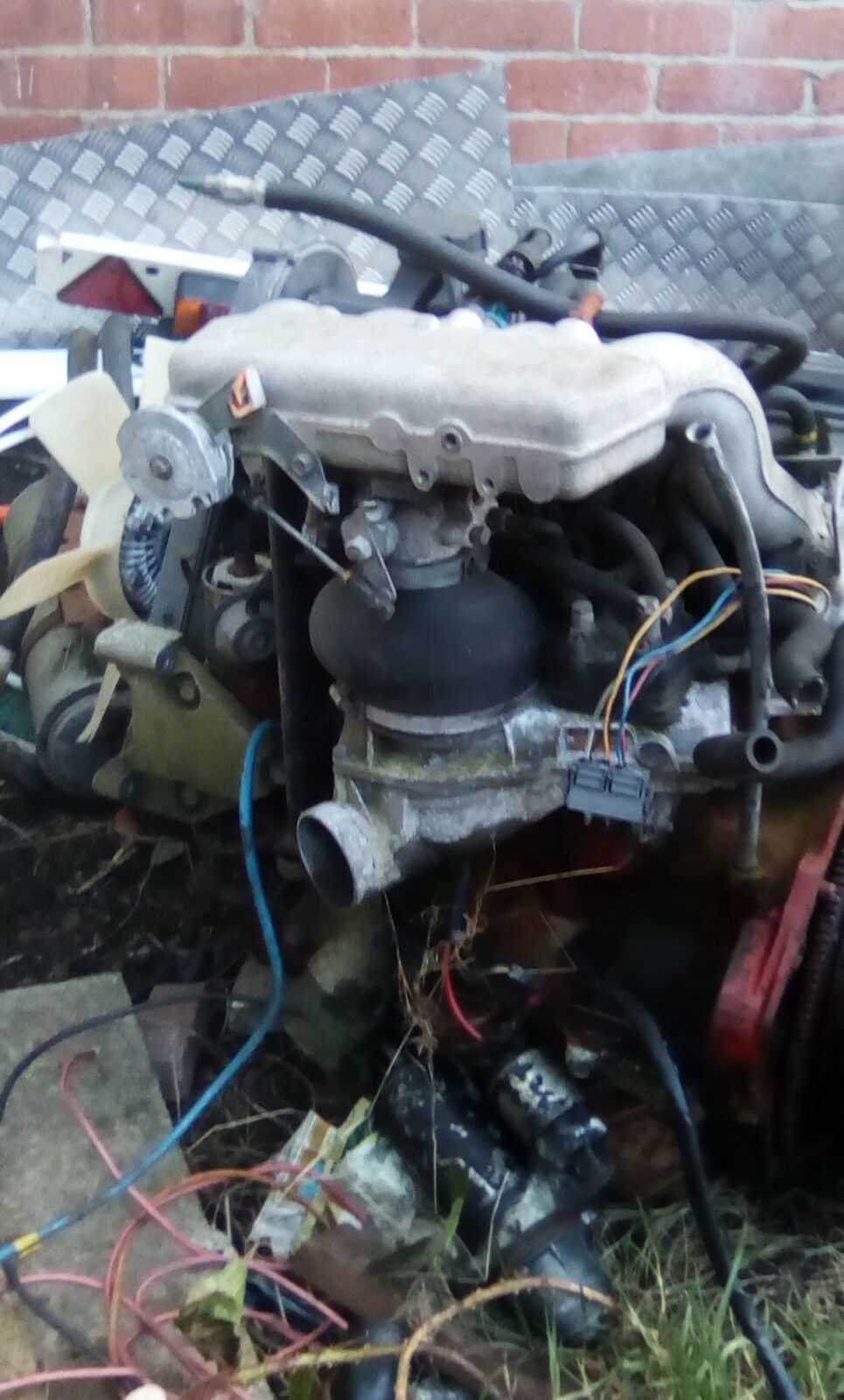

Like this one?

No that is a B200E or B230E from a 240
The B20F was found in 440/460/480 models. Looks exactly like a 340 1.7 from the outside
