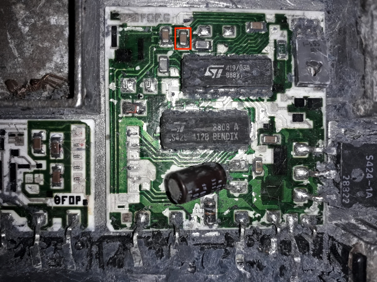

Right, a very big right and a curse, because this is where it all went Pete Tong. The plan was to gently, gently lift up the circuit board to see if we can see any signs of heat under any of the components, so here we go, prise in one corner, prise in another corner, prise here, prise there, prise everywhere and... swear... *snap* ! !
Yep, OK, so most of the circuit board did lift up (that's the good news, ever euphemistic, decades of experience making excuses for my incompetence comes in handy here) but one of the corner's didn't want to budge. Bah humbug ;-(
I can kid myself that it might be possible to glue them onto a piece of plastic and then use a fine nib-pen with some conducting paint to join up the borken tracks but there's about 10 of them to repair so I just don't know if its worth it or possible, fffmmfff. Anyway, here is a view under the circuit board which does seem to show a burn mark under the Bendix chip, which suggests it may be a complete write-off anyway, but I just don't know enough about electronics, etc, to judge.
Finally, in the great breakage this tiny little resistor (I think) popped loose but its possible to make out where it should go in the pictures. I will mark them up better in the near future.
What does anyone think? I might try to repair the broken board?? I might give up?? I could probably do it better next time but I don't have any more renix's that are deffo broken. Anyone willing to help on that front?? What do you think?

Thanks for digging into yours and the decent photos. A hot air station really helps with softening that awful rubber potting compound. Really annoying stuff!
Since it was already not working, I'm not sure I'd bother repairing it really. If it was working, I would attempt repair if you've been able to solder a surface mount component before. I wouldn't use conductive pen to join the broken traces though. Soldering wires on to the pads/components they connect would be far more reliable (with a dab of something to help deal with vibration), just like what you'd do with the broken board-to-board interconnect.
That loose cap looks like it's from here on the board split:
IMO the best use for this unit is sacrificing it for further reverse engineering! :D

Post by bogbasic »
Cheers very much for that, oh dear, thanks about the cap and I thought I could recognise components. ;-0

The custom Bendix IC will likely be impossible to find (unless there is a surplus shop with a box of 1000 that has been gathering dust for 40 years) but the rest of that doesn't look scary. The device with a hole looks like a TO-126 package to me, used for various things with 3 legs so likely a transistor or FET.

Cheers, yes, TO-126 looks promising for this thing:
https://en.wikipedia.org/wiki/TO-126
Nice one. All the way back from 1968. I was 5! The big S424 thing with the heat sink in a recess on the side comes up on google as a £5 transistor!
I haven't done on-board soldering before, only under-board butter fingers stuff, sorry. The tracks that broke are way too thin and close together for me to repair by hand, I fear. Likewise for sticking on those teeny-tiny caps!! Must watch some videos on how to do that stuff but I fear its for pro's only!
I can't see a vast amount of similarity with the picture in MAC's thread, to be honest. That one doesn't seem to have the board covered in sealant, just a metal cover plate. If only...
I haven't done tons of searching on the web for renix circuit diagrams, etc, but I suspect most of what's there will be from the Renault 5 community rather than Volvos!!??
Anyway, I tested my collection of 4 or 5 renixes a year ago or so and that one definitely didn't work and it was one I had tested before and decided it was a broken!! I am intrigued by the idea of further reverse engineering. What did you have in mind? The custom programmable electronic ignition stuff I found on the web is all in the £500+ region and that's a bit beyond my budget at the moment, as its not something that really grabs me, to be honest!!
