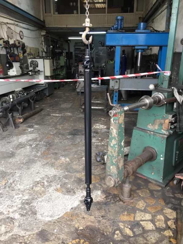

clean shaft. It was very nice. no vibration. no vibration. no sound. no balance. it's number ten. engineering wonder. I would recommend it to everyone. Turkish master. Turkish technician. I have been using it for months, no problem.

Wow! That looks really cool! How do the fittings compare with the standard shaft which has allen key bolts, I think. How much do you charge?

I am very pleased. I got $ 300.

Hello again, thank you for your reply. Is that a 4-speed or 5-speed? I think the automatic has the smallest shaft. Do you have a website with some more photos and contact details?
I might be looking for a 5-speed propshaft... actually I am looking to get an interesting spare one. Would you need a broken propshaft as part-exchange? I do not have one because I have never broken one - I don't do drag racing, or other monstrosities....

used the ends of my old shaft. the rest produced from scratch. 5 speed manual car. I've never had any problems so far. the car is driving very well. I'd like to help you, but I need milled ends of the shaft.
