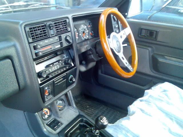

Jesus...you lucky git! Any more of those lying around?! All I have so far is the R-Sport boost gauge. I'm guessing you're in the UK...

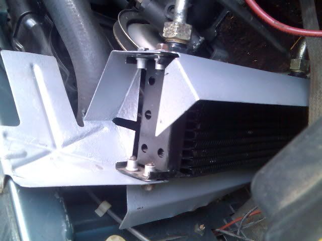

Interesting oil cooler placement...where are you feeding air to it from...through the stock round hole there?
I'd definitely consider upgrading to an intercooler in the fullness of time by the way - and do yourself a favour and go straight to a 'large' one, rather than adapting a Volvo one to fit.
Yeah, chinese full aluminium, bar and plate intercoolers are very cheap nowadays and those are enough for few hundred hp so there's no point to adapt an ancient Volvo one.
For example KL-Racing in sweden sells those.
http://www.klracing.se/
The largest one, 78cm wide costs ~200euros and smallest is below 150e so kinda cheap.. Though you can find those on ebay even cheaper sometimes.
Even though those are made in China, they are proven to flow and work good.
Edit: And btw that's VERY clean setup! Good work. Could you take some more photos of the oil cooler and it's mountings as I am about to relocate mine in GLT. My oilcooler in the GLT is currently behind the front grille but as I'm about to fit an intercooler, I must put the oilcooler in somewhere else to make a room for the IC.
