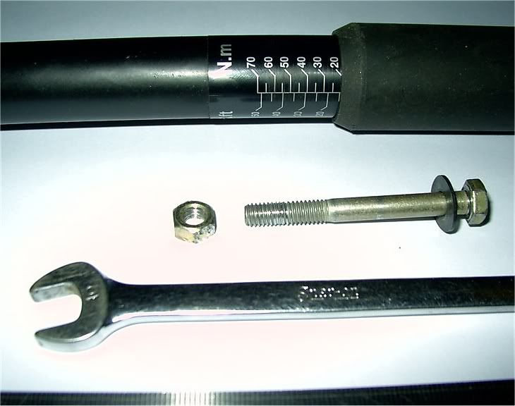

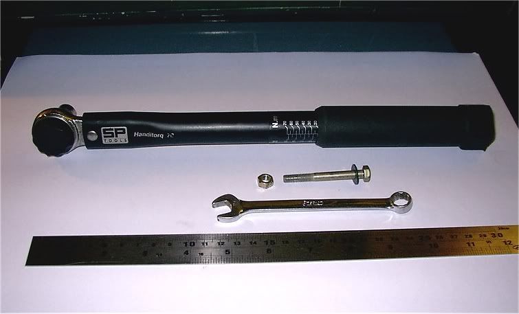

Just to amuse myself I carried out a simple test. I took an M6x1.0 bolt to thread failure using a 5" spanner only, in stages measuring the torque. The bolt was spaced and threaded into a steel nut. The thread failed at just above 20Nm (which as I said I was applying with a 5" spanner - probably smaller than the average DIY tool). The torque specified for the water pump bolts is 8Nm. The point here is not so much that the thread failed (the thread engagement was much less) but that over 20Nm could be generated by such a short lever - and that would certainly be above the yield point of the thread in the aluminium head !!!

Just to add a drop more - the max recommended tightening torque for an M6 bolt in a steel fitting is 16Nm - rather less than I generated with 5" long spanner - nuff. said !
