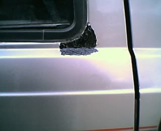

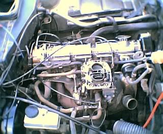

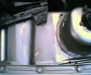

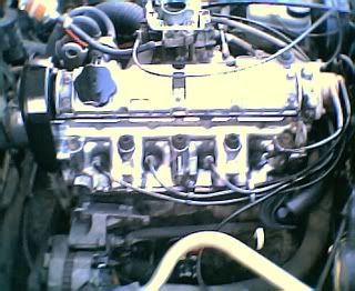

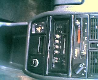

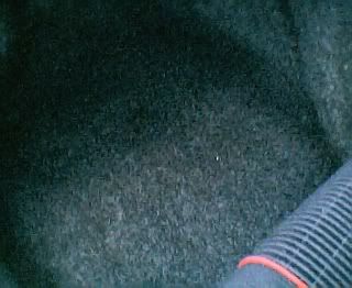

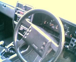

Right i have done a lot of interior cleaning yesterday and today and i looks quite good. i spent a day and a bit cleaning the engine but it still needs more! and i fixed a rust patch on a rear door. so here is some low quality pics from a 340x240 camera :? but at least it doesent take all day to load.
i then dremeled it. then paint
interier
Engine
Well thats it for the moment.

Very nice indeed, shame about the rusty bits but looks like you've started on it the right way.
The engine bay looks very tidy. If the carb was genuinely that clean inside before you started on it, then it looks very well looked after, and I suspect you'll have a very nice running engine. Interesting that its got the water heated baseplate, must've gone over to the electric preheaters in 1989 then (the water ones imo are better)....I need to get out more :?

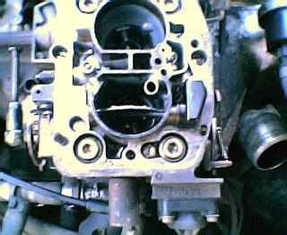

Yeah thanks i havent touched the carb as it was coverd with a plastic bag for obvious reasons (when Cleaning With water and engine cleaner)
The engine is running really well @ 500rpm :? :roll: (ideling)
but....(engine running )when my dad opened the oil filer cap after saying what a good job i had done oil spluged all over his sleeve :? and he says this is caused by excese presure in the engine :? as it is worn and old is this normal / a problem? and can it be fixed?

Post by pettaw »
Possibly excess blowby yeah. And that's a fairly high mileage engine you've got there too.
However, the camshafts are very close to the cam cover on that engine, so they will throw oil around the place if you lift off the cover whilst the engine is running.
Another thing to check is all the crankcase ventilation hoses are clean and clear. I'd take them all off the car and give them a good spray through with some carb cleaner.
As to the idling issue. I'd check for air leaks, carb base is a bit of a favourite on these ones. There are other threads dotted about with the procedures on.
