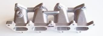

i guess if the worst comes to the worst i can sell my manifold onto one of the clio boys then buy a cheap ebay twin carb manifold and cut the standard clio manifold and weld the carb side straight to it.
Hopefully though, having looked at pics of the one i'm waiting for it might be straight 8)
Here's a pic....
