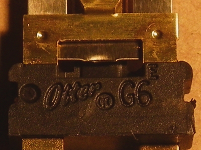

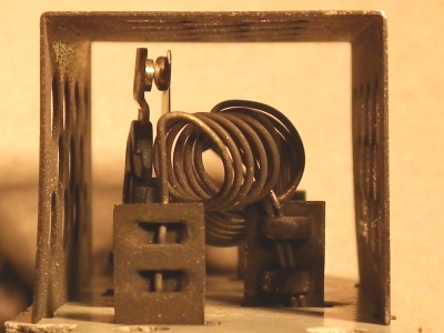

I can confirm that the inside of a new Otter G6 looks suspiciously like the old one, but not exactly the same.
Now...
then...
now...
then...
... Geddit?? I guess that's a bad sense of humour these days ;-)

Down by the resistor side...

Rattle, rattle. I have soldered in the Otter G6 and it fits perfectly, looking small, neat and absolutely gorgeous...
... however, testing it on the car today with the cover off merely reproduces an effect that was reported earlier - it switches on and off every second or so at full fan-speed. It does seem to work OK on slow and medium speed though, which might be alright if you were desperate, but not ideal really.

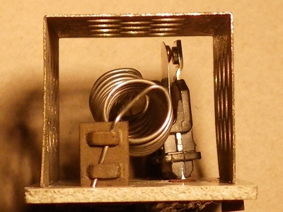

I went for the ETA switch and its feet seem to fit through the holes in the floor panel reasonably well....
...with a bit of bending about here and there. More jingle jangle jewelry to fit to me motor car...
