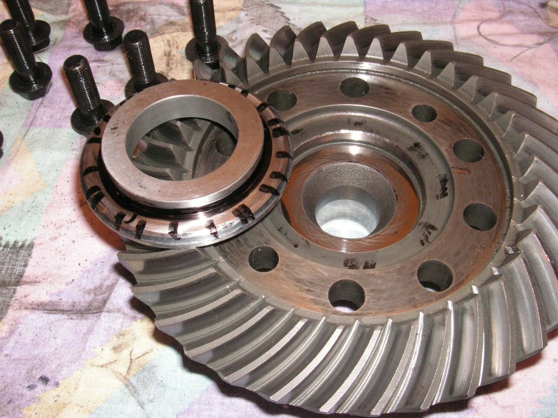

I just installed my LSD (bought it at along with Peter about a year ago but haven't had time to fit it yet); installation was pretty straight forward, but not quite bolt on...
Diff gear disc with markings for sanding/milling
First of all, the tolerances between the disc that forms the thrust bearing for the spiral gears of the diff and the crown wheel were slightly off. With a belt sander (might have worked with a good lathe and sharp tools), the outer diameter, the radius of the first edge, the height of the first flat part and radius of the second edge had to be adjusted slightly. Being hardened, it took a while to get everything to fit!
An important notice; if the disc is a tight fit, think twice before pressing it in since it is very difficult to get it out once pressed in if the fit has to be adjusted to make sure it sits flush with the surrounding area of the crown wheel. Peter made that mistake with one of his diffs, it took three 5mm drill bits and a lot of time to drill through from behind and press the disc out again!
Shortened crown wheel bolts
The next thing that needed adjustment was the length of the bolts for the crown wheel; they were all bottoming out in the threads. Another trip to the beltsander and that problem was gone...
All in all, fairly straight forward, but not quite bolt on...
I managed to reuse the old bearings which were in good order, all I had to replace were the seals and gaskets and one of the shims to get the bearing preload right (the backlash between crown wheel and pinion was OK, it is generally not changed when changing the diff).
