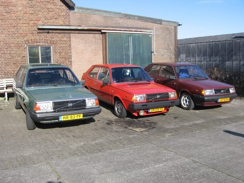

Some plans changed.... The 343 turbo isn't anymore. Been putting the turbo engine and gearbox into the 340. Probably some people don't understand me, but this was the only way in getting better with the 340.
Thursday first driftcompetition.
Been driving it a few days now, its really awesome! No problems yet.
The green one will be sold probably, or break down for spares. It was hard to deside you know. But when the 340 drove, it was all good again.
And yes, I toke the engine out of the 343 and put in the 340. The 340 has a 5-speed gearbox from a 1.7 now.
Mainly, I can pay attention to one car now.. Building two same volvo driftcars is stupid, especially if you don't have money at all.. (and not much time)
The 340 will only get better and better. I want to win some competition :] Beat BMW's and Nissan's hehe.. Must do anything what's possible to getting better. Whish me luck
