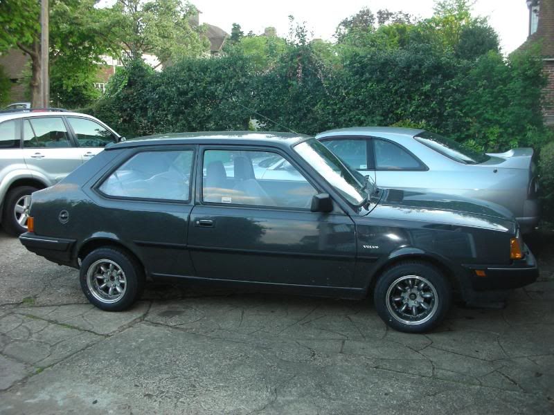

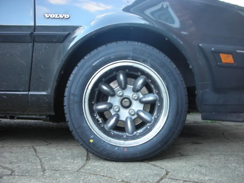

Got some pics with the new tyres on now, i'm just a picture whore
For anyone who was interested, i'm fairly impressed with them, give good grip but smoke up nicely too, not been out in the wet with yet so will report back at a later date.

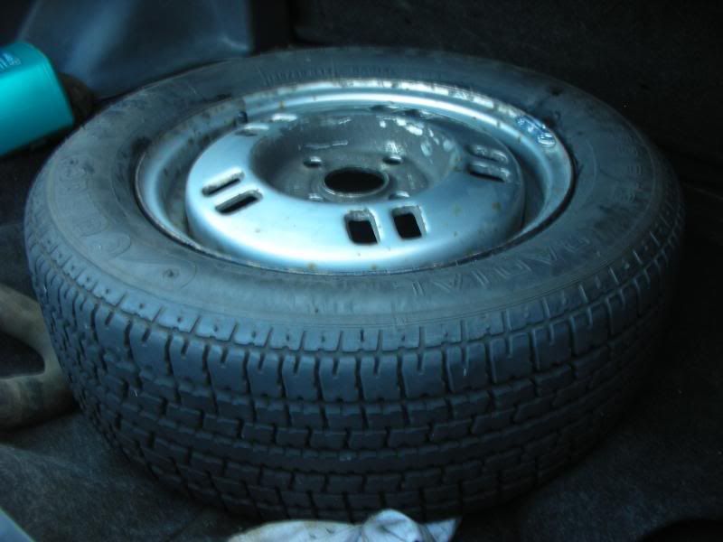

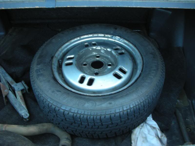

Plus the stock steel with one of the wider tyres fitted, was feeling lazy, couldn't be bothered to take it out the boot

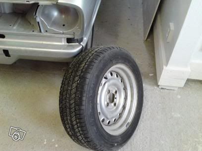

So thoughts on these then please people, 7"x14, but would i still have the offset issue of not being able to lower it?

Oh those steels up there are 4x100 BTW.

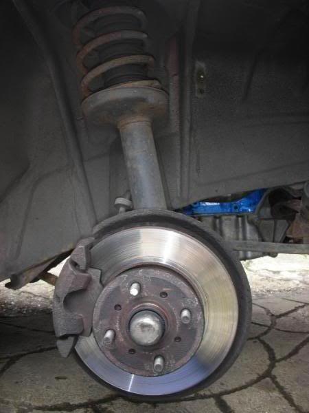

Any way onwards with the pics:

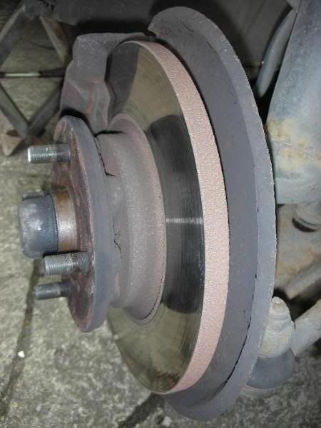

old stuff
Yeah the brake pads are in there somewhere

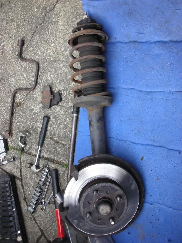

Old stuff out
New stuff, turned up friday mid day hence why i started it all then:

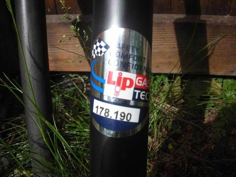

Old original shocks next to new sealed units:
No suprise the brakes were pretty shocking really

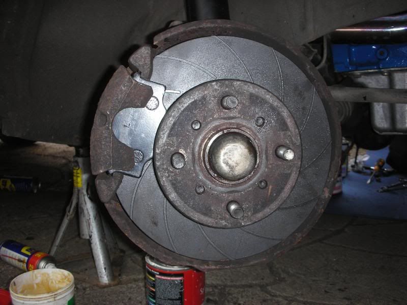

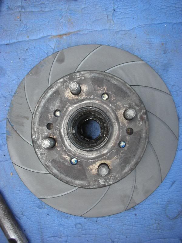

New discs, got to be an improvement over the originals, but my budget didn't stretch to the drilled or combi ones:
New bits on, missed the build up but meh:
Note different coloured springs, meant to be 2 1/2" lowew, and laid next to the old ones i can beleive it, but once fitted only seems a smidgen lower than it was. I can only pressume the old springs and shocks were totaly kippered so it was effectively lowered already?
I've got a little knock coming from the drivers side suspension now, so will have to investigate that, but nothing is loose, i've already checked. Well i went to a car show in it today, a good 20miles or so with no problems. It only seems to do it on full lock when parking, or hitting big pot holes. Other than that it's fine, a lot stiffer than it was. Just need to put the new shocks on the back now.

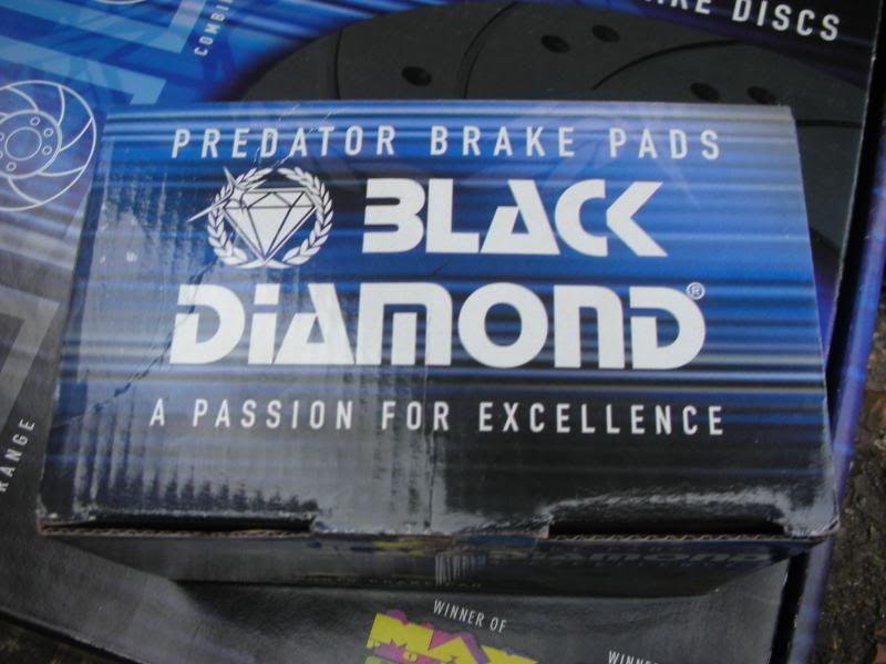

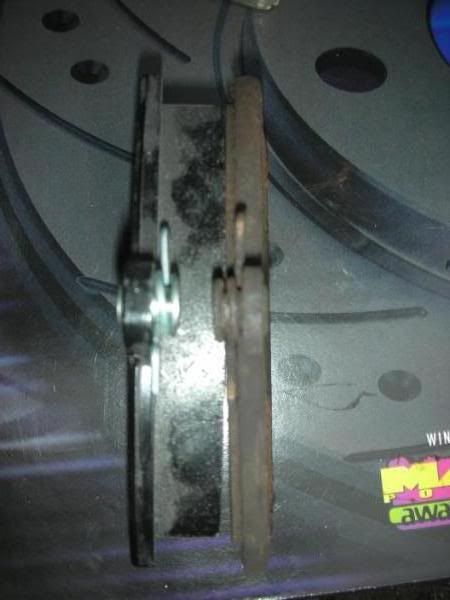

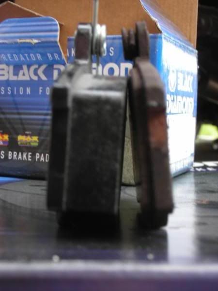

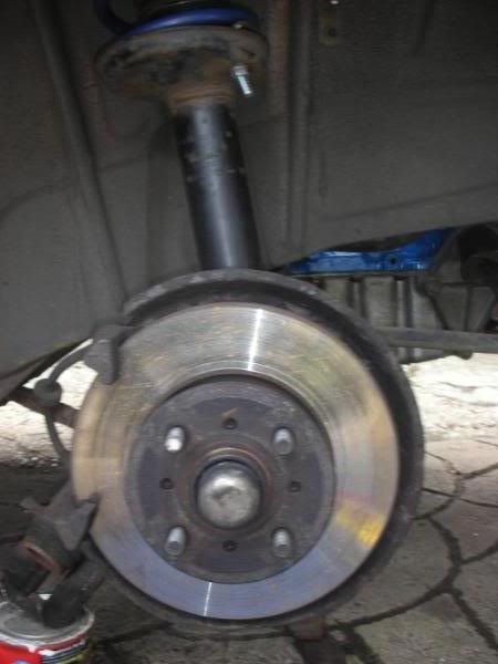

Check the inserts arent moving slighlty inside the legs...
Adam
Adam
Re: The Battleship, Williams, lowering dilema??
By inserts do you mean the new shock in the leg, if so i doubt it's that as i couldn't physically do it up any tighter than i have? I've got a feeling it's the spring, although i've held them in with bolts and plates, it still seems to move about a little.
I'll give everything a check over when i get in from work tomo eve though as whatever it is, it's slightly annoying.
- Posts: 5469
Re: The Battleship, Williams, New bits
Check the top bearing
What do i have to check with regards to the bearing, they seemed to be in ok condition so i just cleaned them up and re greased them.
The cars looking great man, those brakes look awesome. What kind of improvement do they make?
