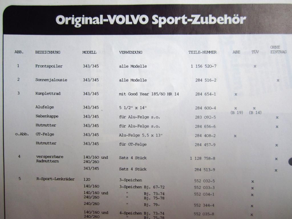

I had another look at the tyres/wheel sizes. As far as I can tell, B14 343/340s never got 14" wheels as standard, including the special editions. Volvo did "allow" it though, as shown by the documentation I have which you need to show the German TÜV if you don't have the "correct" wheels fitted. Essentially, the following letter says:
"Volvo Car Germany GmbH confirms that there are no technical considerations against mounting the wheel / tyre combinations listed below on vehicles listed above."
... or words to that effect.
The tyre combinations they allow is interesting, including 195s with an asterisk to say that only summer tyres can be used, and that no snow chains should be fitted :-) Odd is that they don't list 155-width tyres, and some of the combinations are weird as well, on which standard wheel would you fit a low-profile 195/55 tyre?
This second document is also interesting, particularly if you live in a country with the some of the strictest MOT-testing (TÜV) in the world and where documentation and paperwork (if modifying a car) mean everything. It's taken from an R-Sport accessory brochure from around 1980/1981 (click on the picture so you can see the full width):
It says that 14" alloys can be fitted to B19 cars if you carry an "ABE" with you ("Allgemeine Betriebserlaubnis" a manufacturer document) but no change needs to be made to the car's papers. B14 (TÜV) means that you need you go to the TÜV first (with all the necessary documentation), they say "OK" (hopefully), give you another certificate, and then you can go to the German DVLA equivalent who add it to the car's papers for you.
Complicated :-) I think things have changed in recent years (no more "adding to papers" etc., manufacturer documentation is sufficient) but it still means fitting the wrong wheels to your car in Germany without checking back with the manufacturer first can invalidate your insurance.

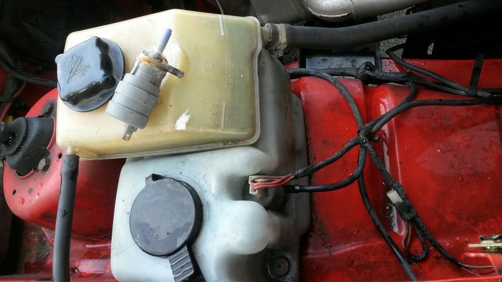

9 months of standing still aren't too great for any car I guess, so on go the plates and after a few small checks and a bit of minor work (a new gas-filled strut for the rear hatch: Triscan 87102711, some bulbs, a replacement windscreen washer pump), a mate and I set off with the DLS for a 450km round trip. The longest journey since I got the car, nearly 6 years ago :shock:
Pump (now the windscreen washers squirt again):

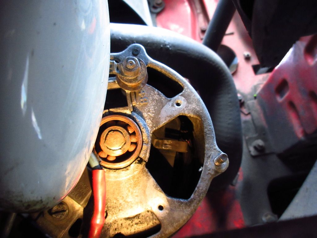

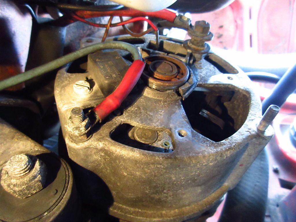

But then: oh dear! The fuel and temperature needles start to drop, the horn sounds weedy and after a stop, the car won't start. Empty battery!
Out come the tools, and oh dear again, this doesn't look good, the carbon brushes are definitely under the 5mm minimum:
and look at what's left of that bearing!
Coaxed the carbon brushes out a little bit more, push started the car, and limped back home. It was enough to charge the battery again (and we measured 13.5V - 15V arriving at the battery today), but clearly some work needs to be done.

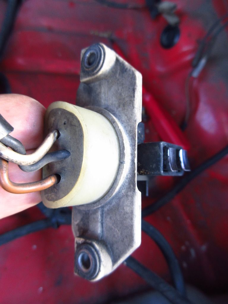

This early B19-engined car still has an external voltage regulator fitted to the inner wing. According to the green books, 60 cars further down the production line (B19 cars from CH 629518) would already have been fitted with a carbon brush kit, that has the voltage regulator (charging relay?) already integrated.
My question is this: do you think a later-type alternator will work without any trouble? The green books and the Bosch online "ecat" catalogue seem to think so.
I have a Bosch 0 120 400 932 fitted (apparently only manufactured until May 1982), this was superceded by Bosch 0 120 489 065 and should be more readily available (manufactured till 2012). Both were fitted to Volvo 240s of that era.
Does anyone have an opinion on these external "voltage regulators", does it make sense to go for an alternator with an "all-in-one" carbon brush kit? There is only one (3-wired) cable leading from the plug fitted to the carbon brushes to the external regulator. I'm sort of hoping the replacement alternator will be "plug and play", cheaper, and more reliable in the long term.
I'm looking forward to your opinions :-)

Cor blimey! That bearing is just a tad on the dry side! :D

I'm not sure, but I think the alternator housing is cracked too ... And there must be some kind of backing plate missing from that bearing:
Here's another pic:

Well, I'm going to give it a go with the follow-on Bosch part, with the built-in electronic voltage regulator. Here's a pic comparing the two parts:
The connections look the same - and it's a lot easier to find a replacement carbon brush kit in future than for the "old style" generator with the seperate voltage regulator mounted to the wing. The part's in the post already, I'll report how I get on.
Re: '82 343 DLS with an alternator problem
That bearing pic is both scary and epic in equal quantities. Definitely looks like it's eaten a chunk of the casting, there isn't enough seat for it and on the bottom of your first pic it looks like a rattle fit which it shouldn't be!

Well, I'm glad we made it home :-) The new part should arrive tomorrow, I'll probably fit it some time next week.

The mountings look the same as a B200K/E. I just got a reconditioned 55A replacement for my 45A B200K unit (reconned after 200k miles) for £35 delivered. There are a few of these on eBay and not much demand. I just waited for one to go 'make offer' and jumped in with a cheeky bid.
I'd send you mine but I'm sure you could find one locally.
