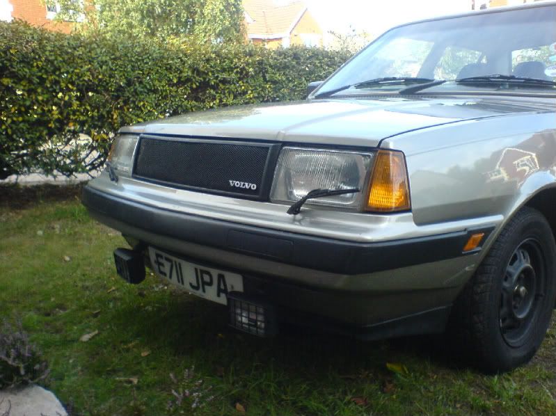

I do like that grille, its what i am planning to do after my fail at making one from orig. volvo grilles.

cool, that looks ace! where did the 'volvo' bit come from? i like adam's with blue 'volvo' on it too.
Re: new member with a 360
It's one of the wing badges. Shamelessly stole this idea from Adam as well as his black headlight surround idea :lol: I'll keep the pictures for when I've got the wheels I want though, it'll all look right then.

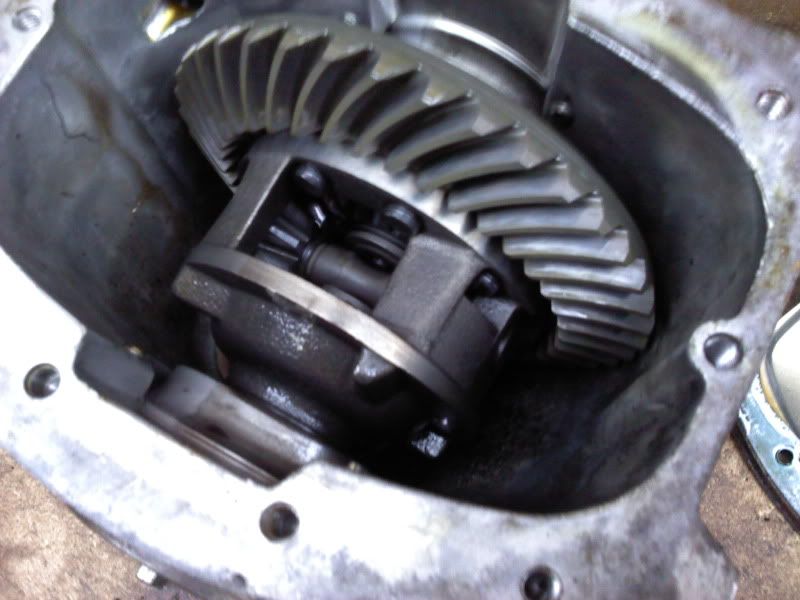

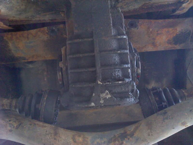

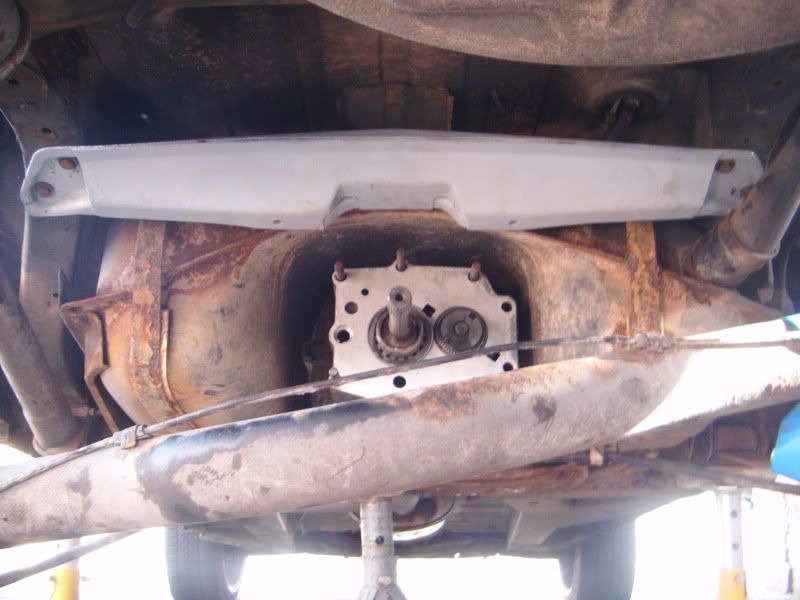

started on my diff today, but got stumped by one bolt although most were difficult and required more leverage using random metal tubes i could find, this one was just in a difficult place. tomorrow i should have the whole diff off and welded up.
spot the difference :lol:

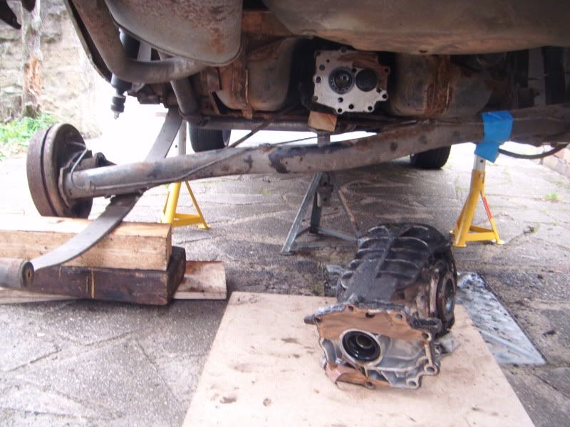

well diff removal was harder than i thought but finally got it off today, been giving it a clean up before i head off to work.
going to need a new gearbox to diff gasket, thanks to Mac for giving me the part No.

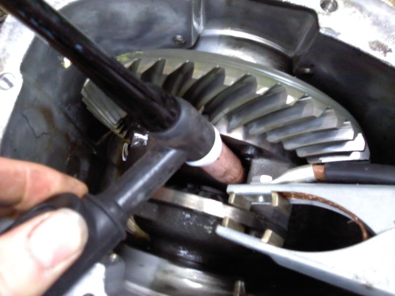

Post by slideway »

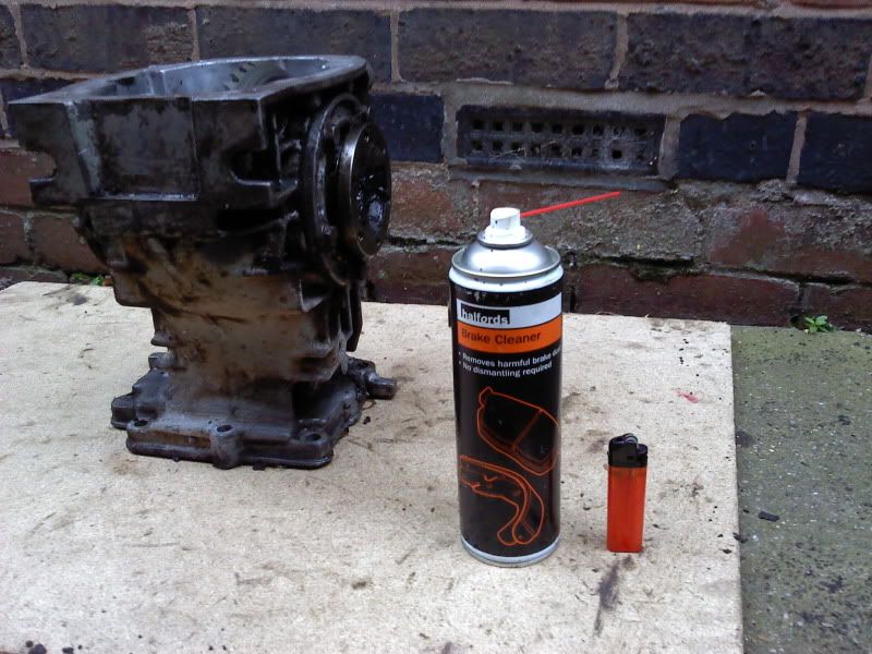

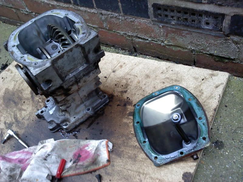

took my diff coverplate off and that gasket was fine
to clean the oil off the gears i used brake cleaner then decided to set it on fire with a lighter rather than with my welder :lol: that wouldn't have been a nice surprise!!
then welded it up, and i'll finish the job on saturday :D

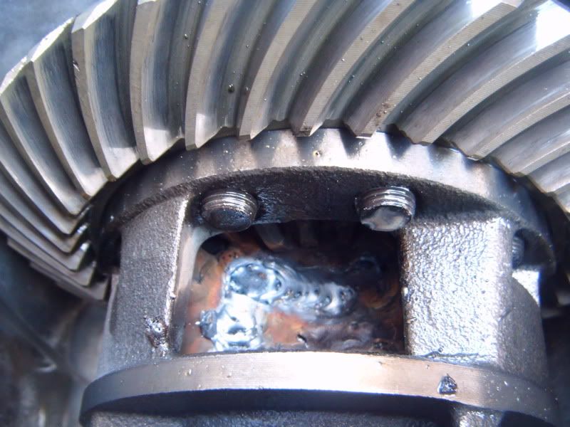

Post by slideway »
Thanks Fuse.

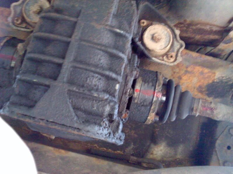

Today i got my welded diff on the car, everything went well, I took it for a little test drive and it seems fine for normal use.
bit of porosity in the weld but my tig'er was set high for good penetration so it should hold,
i had a bit of trouble filling the diff back up with oil but did the best i could, i'll try and find a better technique of doing it.. any suggestions?
cleaned and sprayed up. it also has underseal on it now :)
