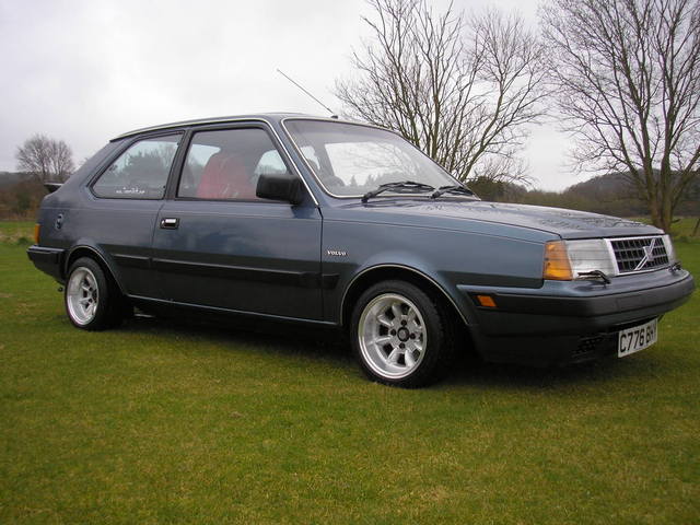

You can get a 300 to sit nicely without coilies on 7x13's with 195/45/13's by simply dropping it on the bump stops and putting 3 inch blocks on the back. Like so:

One other thing... How are these two sitting? 3" blocks and 3" lowering springs? Then is the 340/360 on the grass on 2"? Also what do you mean sitting on the bump stops?

The first two pictures, the same car, i believe is sitting just off the front bumpstops, using lowering springs, and 3inch lowering blocks on the back. The greeny/silver saloon is sitting on the bump stops on the front, and the rear is on 4inch blocks (but you cant go 4inch blocks, it doesnt work even on 13's)
