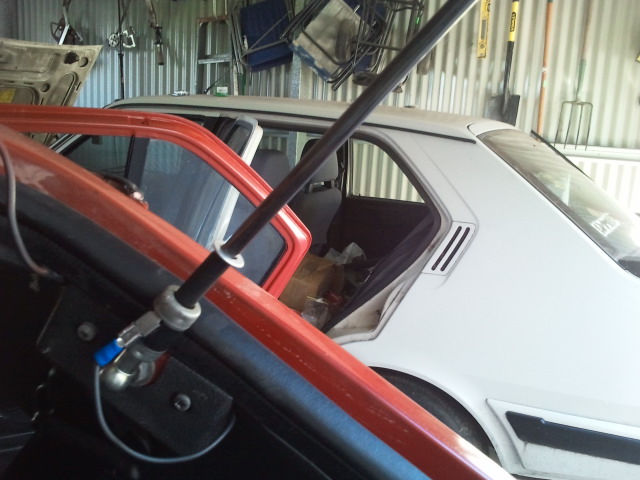

Success at last. Fixed by putting a couple of washers on the strut, therefore pushing the plastic bit further in.... light is fixed

Picture of fix
