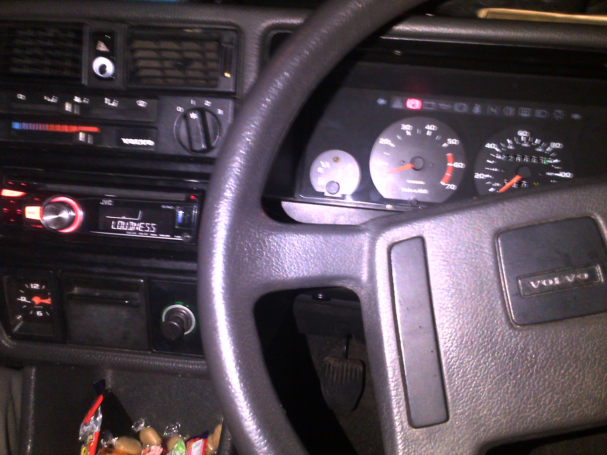

If all the dashboard lights have gone, maybe its a fuse or two. The Haynes says that number 5 does the instrument lights but there's loads of different fuses for all the switches.... Anyhow, I have some secondhand bulbs if its them - just lerrus know which ones you need.

Bulbs:
Gotten some temporary light for the clock and enough of the dash.
Need pretty much all of them, 2 clocks bulbs work, one dash warn-indicator doesn't. Neither does the lighter socket or ashtray, all the heater control bulbs don't work,
Can modify some to fit others so the more the merrier.

The fuses+wiring are faultless. I've not tested a single bulb that was out and found it to actually work.
Got a few fuses left too, everything is powered up.

A handful of 12v white leds might be on the cards..

If it's going through bulbs, you have an earth fault. First one I'd check is the engine block to battery.

Great point, earth worth checking. Actually, I think it was getting like that when I had the car, so it might be a historic problem! I just let the bulbs fade and fade and then never noticed that they weren't working. I'll pop some bulbs from the roof in the post this week. Keep up the great work.

it hasnt blown any more bulbs while ive had it, theyve all worn out naturally: the heater lighting is slightly suspect to be earthing itself unorthodically but i think its the 1/4 million on the clock thats killed off the bulbs if I'm honest.

It's be blown bulbs. Usual story, nobody can be arsed pulling the middle bit of the dash apart to get at the bulbs and just do without.CBA wrote:theyve all worn out naturally: the heater lighting
