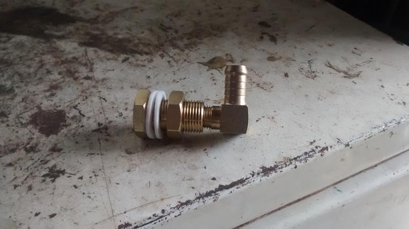

I think I have found a way, I am going to drill a 20mm hole in the tank, directly underneath the fuel sender and use a brass bulkhead fitting with a 1/2" hose from that to the fuel pump. I will use the original feed pipe that goes to the existing mechanical fuel pump as the return line back to the tank
Re: carb to injection
Posted: 21 Dec 2014 11:22 am
by Ride_on
I would say that will sort the flow issue, but you don't want to be too close to the bottom of the tank and you should have a gauze filter in the tank.
