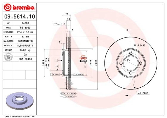

While I'm waiting for the body work to be started, I'm trying to figured out how to upgrade the brakes to match with the (hopefully) higher performance.
I'm planning to use some sort of ventillated discs in front. So I was looking for discs of the same size more or less as the stock one, and I found an intresting match. The AE86 corolla disc has mostly similar dimensions. The different bolt pattern would require some machine work, and the center circle as well, but It's not a big deal.
The real question is, that the toyota caliper might would be fit. I'm sure, that it'd need a console/spacer, but I don't know how its shape is different.
Do any of you have experience with the interchangeability?

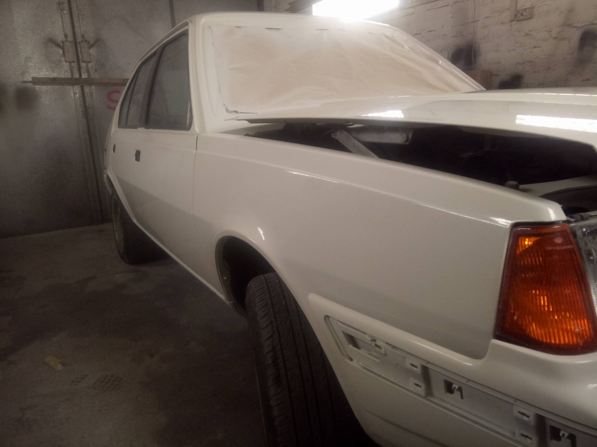

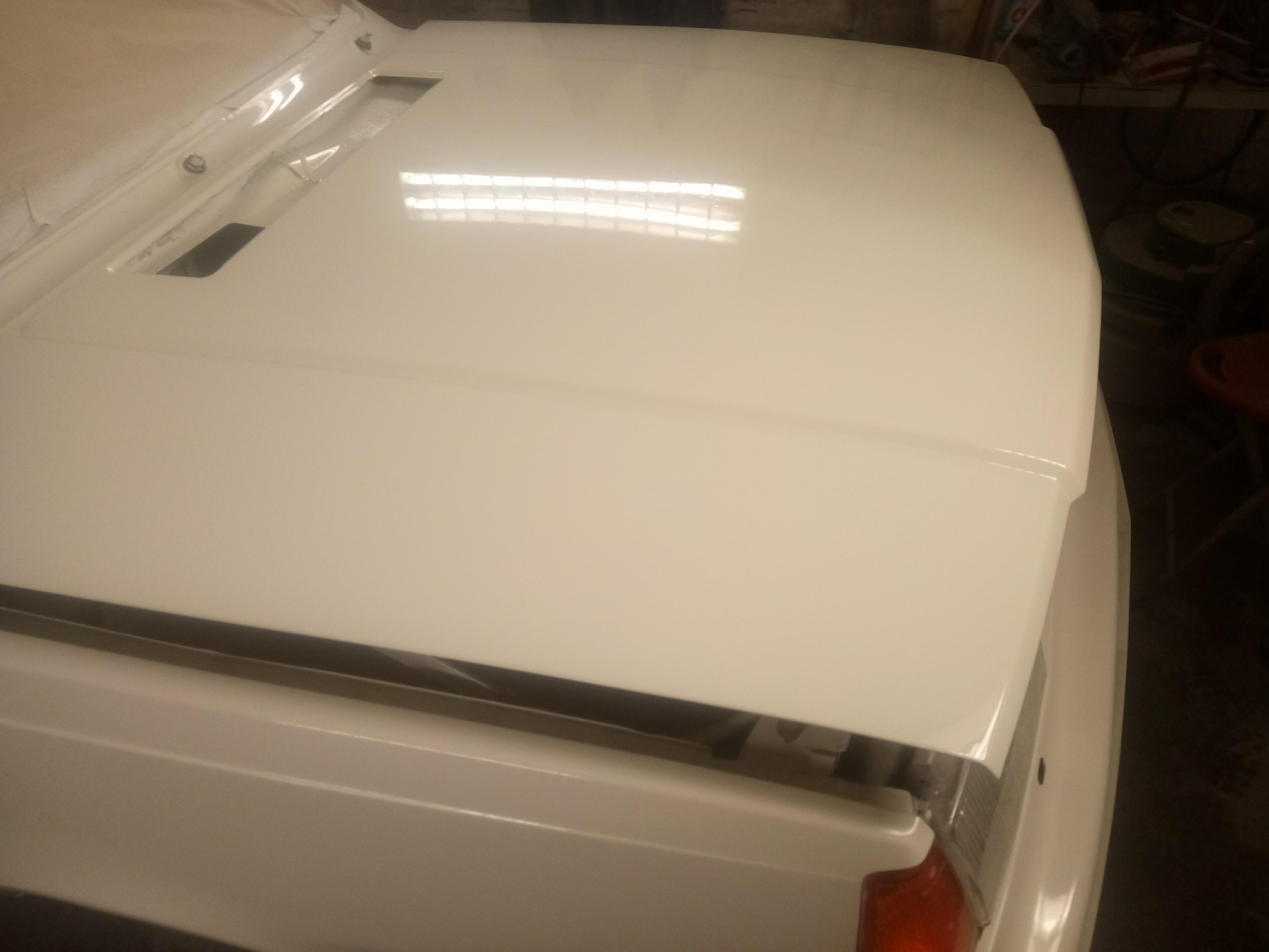

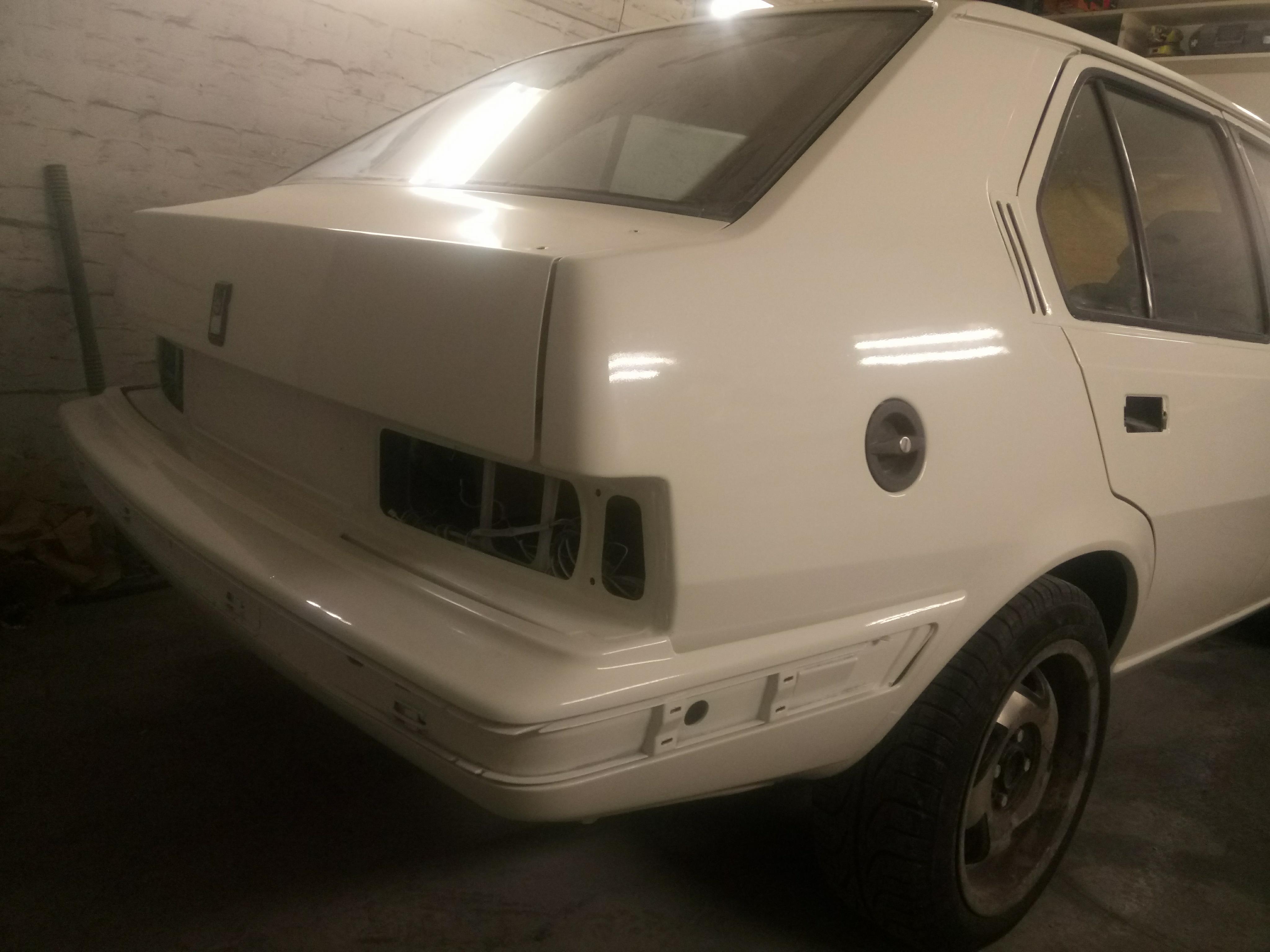

After many theoretical work, I can finally present some practical step forward!
Today my 360 comes home from the body shop.
- Posts: 5471
Re: speciale 25 glt+T
Looks like a nice job on teh paint
