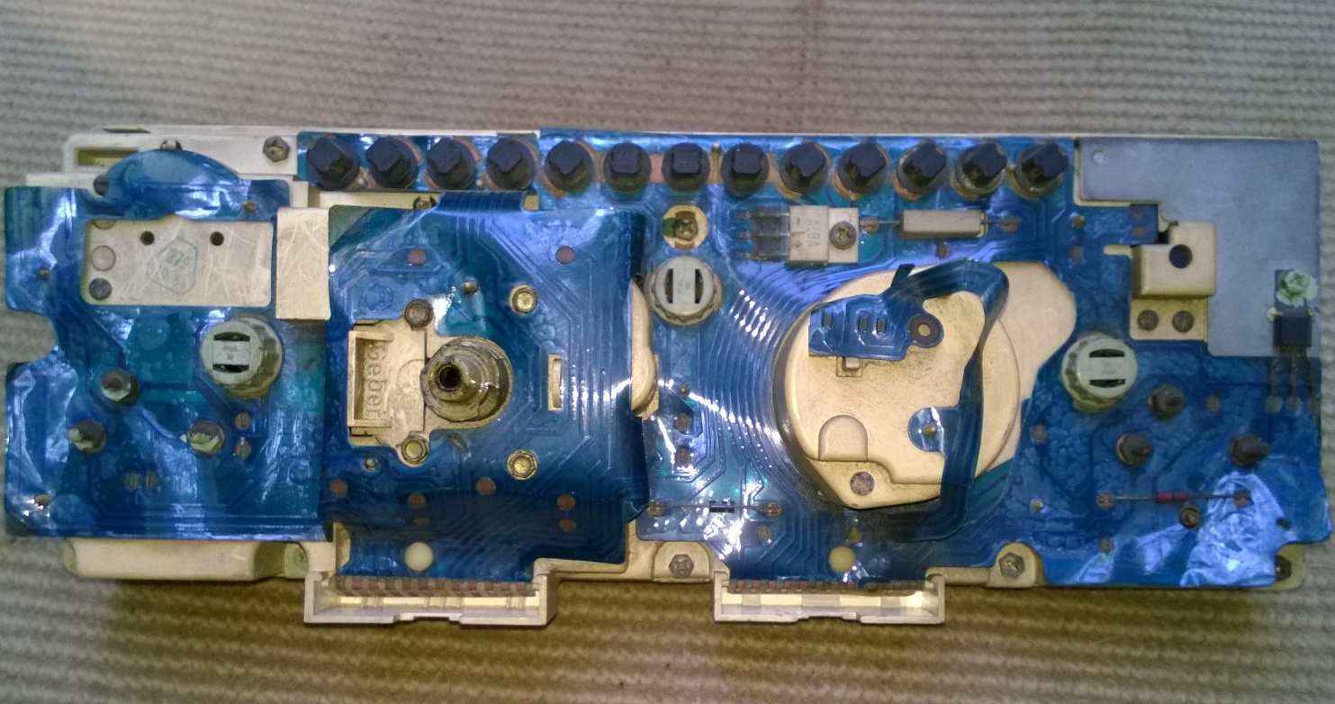

i think the PCB wiring of the Smiths unit is not compatible with the VDO tachometer.
either V+, ground or signal are not coming through, thats for sure.
Post by foggyjames »
Agreed, they're totally different. For a start, they connect to the housing differently.
But the tacho under the bonnet is a Smiths one isn't it?
Yes....I think Wouter might have been puffing the 'erb a little ;)
mac
Posts: 1403
Joined: 19 Apr 2006 11:02 am
Location: Needham Market U.K.
Tach troubles
Post by mac »
Tacho in Omars pic is a Smiths unit so we know he's trying to fit the correct unit.
Omar, Forget the 'regulator' it has nothing to do with the tacho. It's actually called a 'Multi Function Unit' and controls the following:-
It provides a stabilised 10v+ supply for the fuel and coolant temperature gauges.
It provides 'flasher' relay function for the indicators.
It operates the low fuel and high coolant temp.warning lights.
The dash warning lamps operate through it.
It provides needle dampening for the fuel gauge.
They were known to be troublesome BUT it not your tacho problem.
If you have visible damage to the printed circuit that is a likely cause so correct that first (or by-pass the connections from the wiring at the plug direct to the tacho - don't connect direct to the accumulator - you need the 12v+ to be ignition controlled).
This should get it working in the cluster, but the start delay still worries me - that does rather sound like a problem in the unit itself (but you won't know unit it's all fitted in and working).
Good luck, Mac.

Omar
Posts: 101
Joined: 13 Feb 2005 04:48 pm
Location: Russia Moscow city
Post by Omar »
Thanks all for the help guys.
I have connected a tachometer.
At me it was not simple a signal with RENIX .а when I brought it a separate wire simply did not wait the moment of inclusion. The tachometer joins in 5 seconds after start-up of the motor and in panels of devices and when I separately connected it. From RENIX the plait from 4-5 wires departs including grey (pulse) here it has appeared cut off and two more what that brown wires with tips near to it from a plait leave. I have connected a wire to it and on a nut in.
