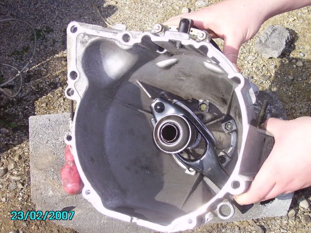

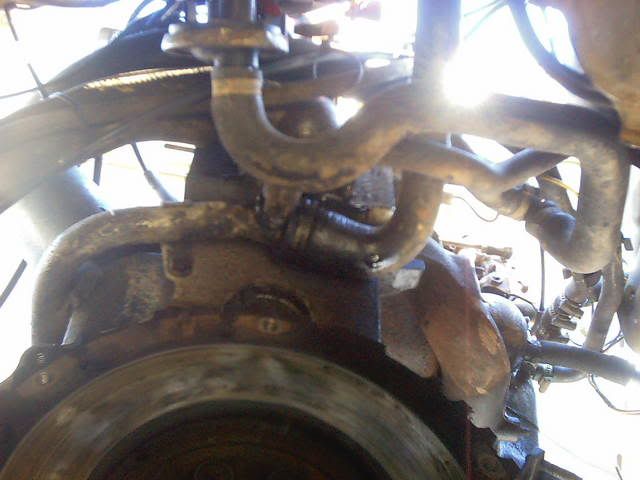

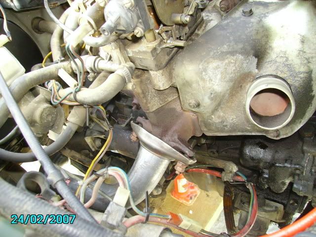

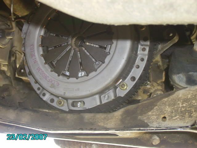

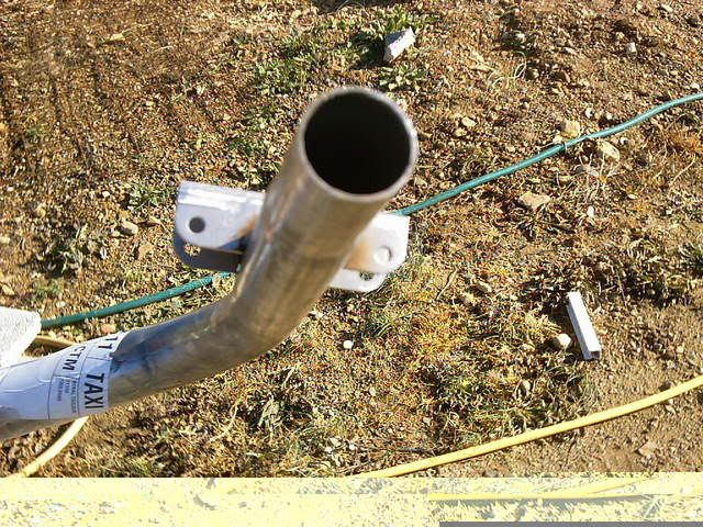

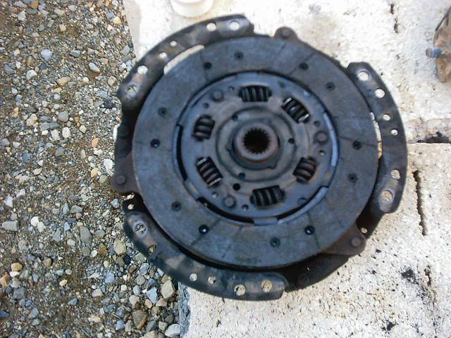

I have some more pics of what ive done today.

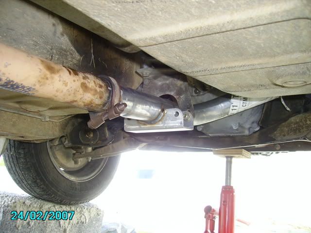

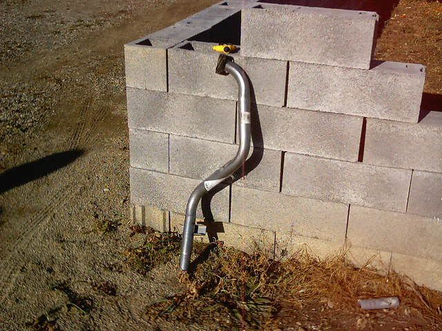

^^My New Down Pipe Made By Bossel Its About Ten Times Thicker and Stronger Than the original.
^^wall thickness

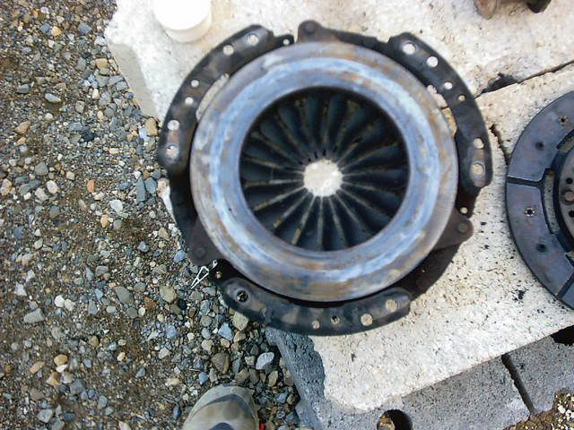

^^Clutch plate and stuff

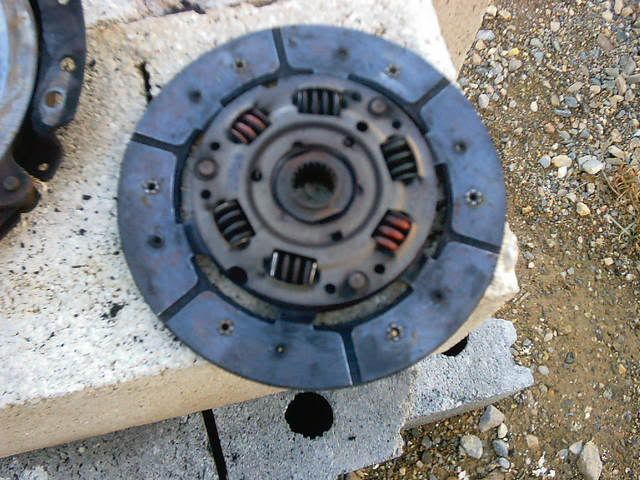

^^Totaly worn with no lining.
^^Friction plate thingy not too worn

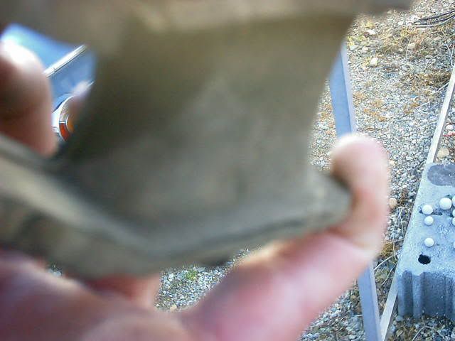

^^Engine mount with big cut through it (this isnt clear in pic)

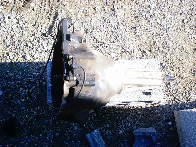

^^ Clutch Housing.
^^Shoot through the engine bay.

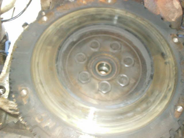

^^Fly wheel 1
^^ fly wheel 2

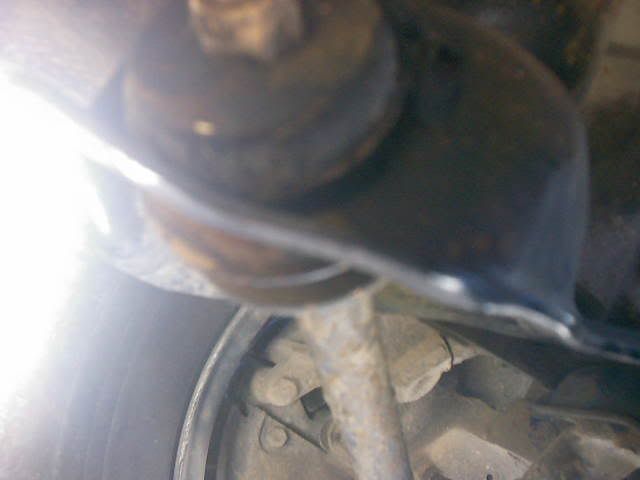

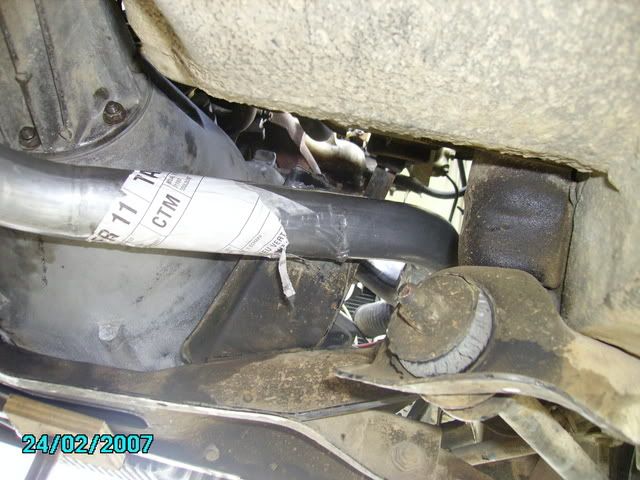

^^ A suspension thing that looks dodgy :S

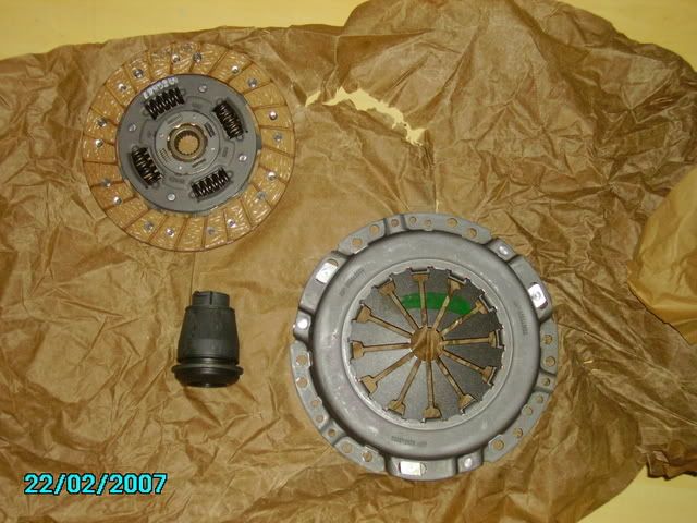

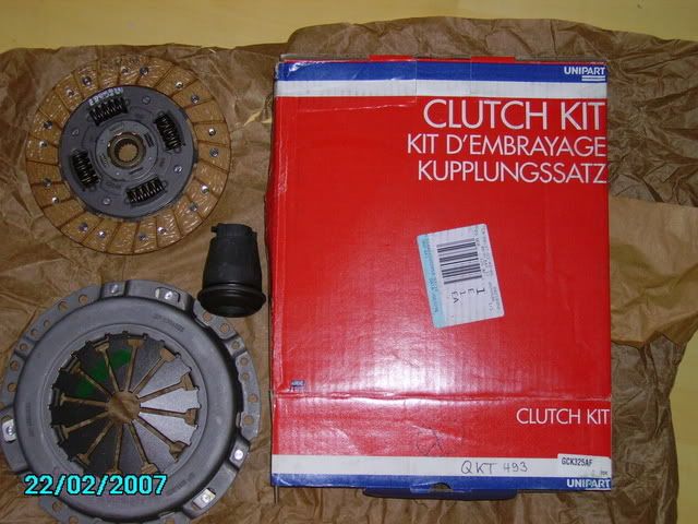

My New Clutch Kit Arrived Today!!
Borg & Beck

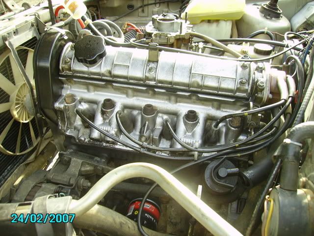

Finished! :D
^^ Nice and clean
^^New clutch assemble bolted on.
^^Down pipe
^^Down pipe and clutch housing
^^Down pipe connection

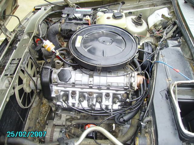

^^Engine-- Cleanish :?
so now i just need engine mounts and its done :D

Great work...You'll be rolling soon. But what about that suspension? It does look a bit dodgy or it's just in the pic ?
BTW I'd like my engine to be THAT clean. Anyway it look like brand new for 10 eus :D

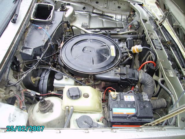

have you had any luck getting an air filter housing and pipework yet Will ? you do not want to run it for too long without those fitted. also dont forget to reconnect the hose from the engine breather, (bottom right of last picture )

redline :roll: ofcouse i have the filter housing etc on and yes i put that oil pipe thingy on too ill take another pic if you want with it together :D

The suspension is very dodgy but i wait for MOT man to tell me if its really bad. in which case dai will have more buisness :D
Volvo 340 Image 1988
Posts: 5471
Post by classicswede »
It's very rare for those bushes to fail an MOT as you tend not to get play with it as such. The problem with leaving them that way is they will be trapping moisture resulting in the shaft rusting away!
