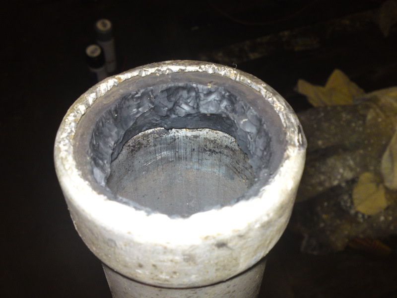

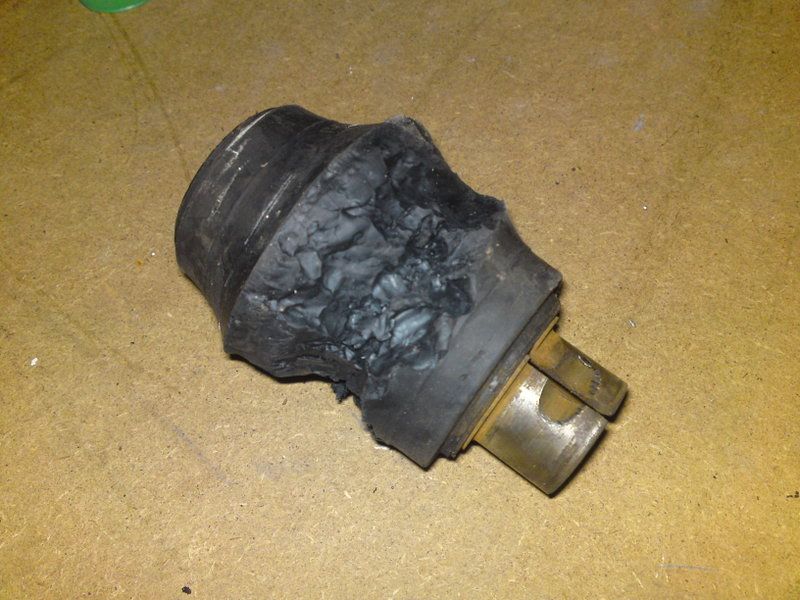

I have some propshaft pics now, the removable part was inside the prop, i pulled it out.
Adam
Posts: 5471
Re: Please check rear gearbox mounts on 340's!!! *Disaster!!!*
Post by classicswede »
Glue or blue tack?
Post by filthyjohn »
Same thing I did to the vario props. You'd have to call it weak design really, from a tuning point of view. Adam, have you managed ok using standard props with the F7R?
Posts: 3657
Joined: 31 Mar 2005 09:01 pm
Post by 340GLT »
Yeh fine, this was only caused because of the gearbox monting.
Adam
