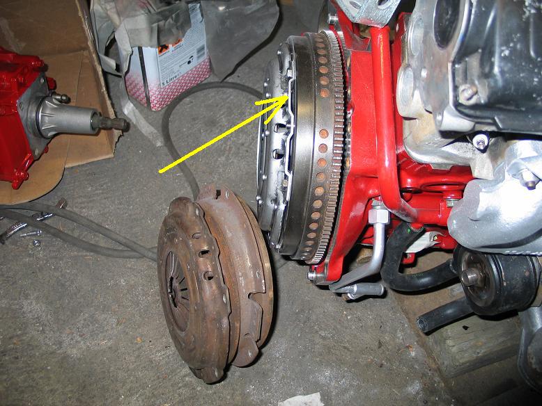

Well I got the Sachs race clutch and it looks the part, thicker finger springs and retainers than the 940 one I had, about 30% uprated. Also got a new original release bearing after much searching.
Anyway the clutch pressure plate is a little different shaped than the 360, there is so little clearance that if the clutch bolts are not fully tightened the bell housing does not fit. I can't turn the engine at the moment as the cam belt isn't on. Will I need to trim this down a bit? its just the edges sit up more, the 360 clutch is flatter at the edge.

Make sure you use the 940 pressureplate bolts, not the allen-key/imbus bolts off the 360. Seen on the top right of the first picture.
Besides that, there is the possibility that the pressureplate will still hit the bellhousing. I think Nimminz used a spacer to free up some space.

The 360 bolts are hex head M8 x18, I had to use them. The flywheel was provided with M8x25 which were too long, they where new so I don't think they are whats fitted.

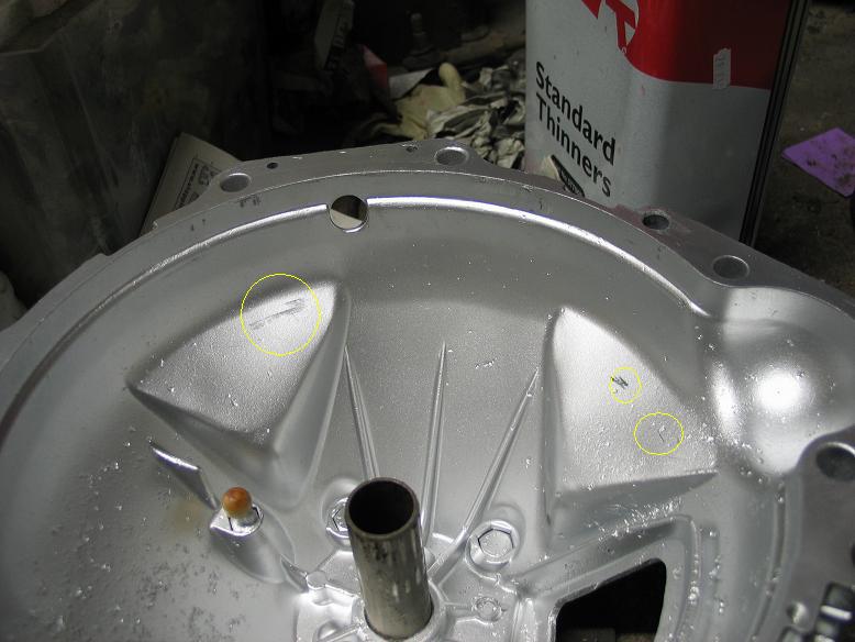

I did turn the engine a little and there was a slight touch at one point so I ground down the edge. Seemed to be the very edge of the clutch that is lumpy at the outer edge when the 360 is flat and close to the flywheel.
Comparing the dimensions the 940 main lump of the pressure plate is smaller/shorter than the 360 plate by 2-3mm, but the edge is about 3mm higher.
The bell housing has 2 big rub marks from when the plate was not tightened up, but I think the touch point was really the little thin line on the right of the picture.
