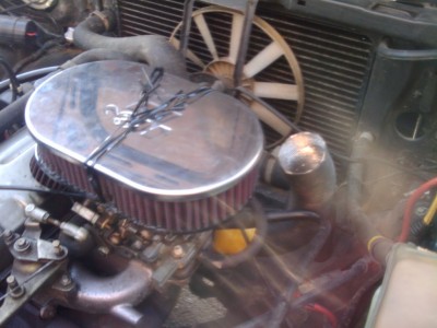

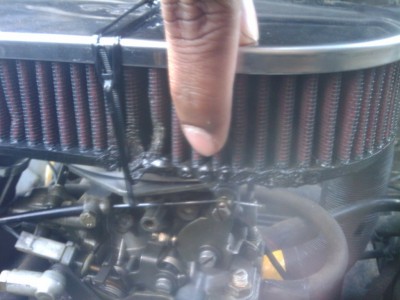

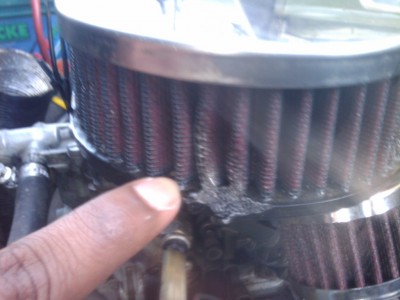

Did 60 miles yesterday going to Uni and then to my Badminton club in Manchester. Drove through some horrendous roads in Manchester and unfortunately the filter decided to pop out again and like always rest on the manifold :x To be honest I think its the only place it would obviously land. The journey was trouble free nonetheless :D
Cable ties came to my rescue :lol:
Filter now secure, used about 10 ties to hold it down. Put the ties through the holes for the original 'frying pan' air filter.
Will be using this forum to kind of document stuff with my 340.
*****IF I AM DOING SOMETHING STUPID PLEASE PLEASE STOP ME. I'M NOT VERY CLEVER*****
Check the pics out.

Cable ties now securing the filter.
Melt incident 2 (Slightly melted underneath too)
Melt incident 1
Melt incident 1
