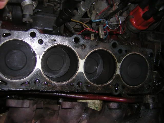

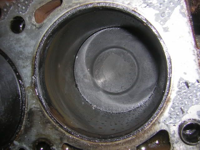

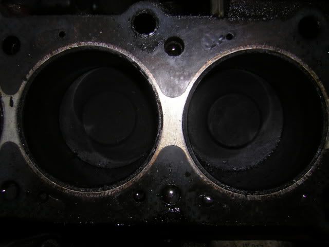

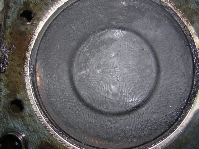

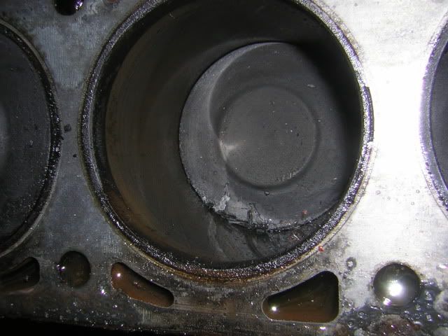

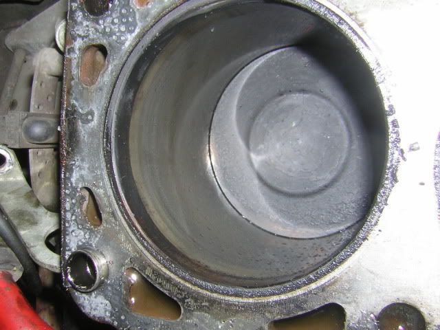

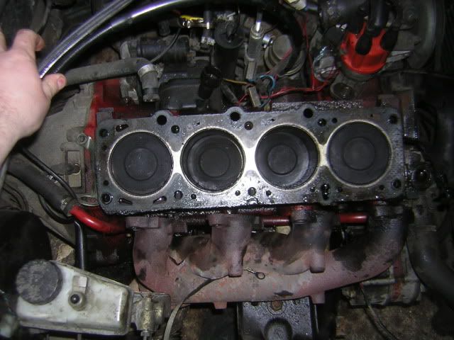

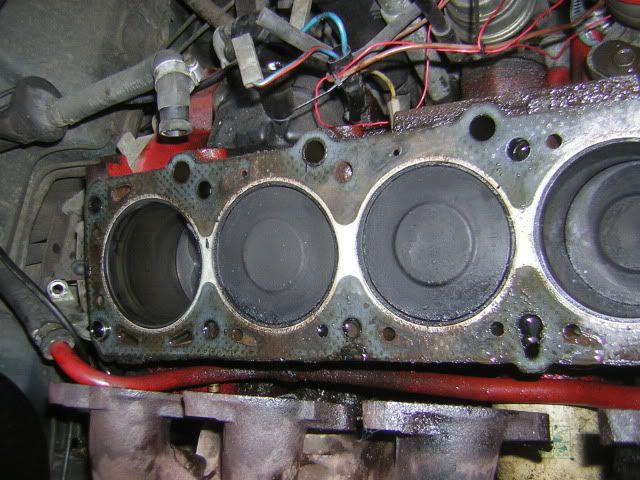

hope you can see what i mean by them, pic 4 (or 6 depending how you read them!) shows the brassy colour on one part of the piston. after a better look now it appears as though i can move all the pistons round, but im not sure how much/what the tolerances are!

Re: b200 problems (Again)
Is it my imagination here or what, but some passages looks like if they were being blocked by some soot in channels?
i did knock some sooty stuff about in my fiddlings today. it will be properly cleaned out tomorrow or whenever i next get a chance.
If those channels have been blocked, it might be partly reason for problems too, imo.
yea i was thinking that.
does anyone know the clearance that the pistons are supposed to have in the bores? they seem to sit central in the bore, however there seems to be more movement in the forward-back motion (ie shaking towards the front of the engine and back again) compared to side to side. like the bores are oval.
im reluctant to believe that the hole engine is foobar'd given the reliability of the redblock engines. and the fact its only done 68k vs the 500,000 odd on our old 240! (which is still going strong!)
Green book should have that info, if not I think that my Haynes had some numbers, which I could look up tomorrow (book is in garage and I'm already in bed

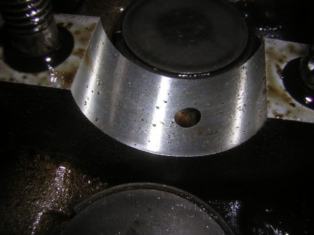

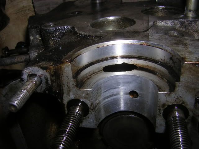

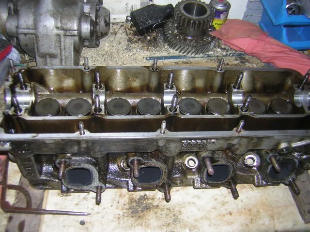

well i removed the cam from the head a few mins ago, there appears to be no wear on a tappets, shims or whatever.

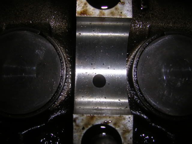

however there does appear to be a crack/a bit missing on the journal in pic 2. is that supposed to be there or no?

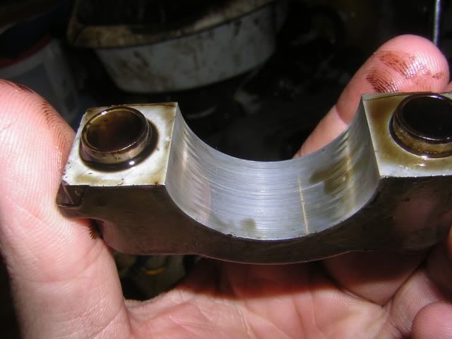

there is also some pitting and scoring on the cam journals pics 3 and 4.
I would think that is a goner, if I see correctly there are some metal chips, so oil filter failure, low oil level, oil pump failure, or something, if filter is gone bad and metal chips have run across the engine it has lot more marks at bottom end.
But I would like to see what other's have to say about this, my experience is bit limited with this level of motor stuff.
edit: I don't at least remember that crack being there when I did undo my cam and replaced the seal, I can be wrong of course as my memory is not the best, but if anything I think that there should of been just small hole if even that.
id be inclined to agree, this is the first time ive had an engine stripped down so all new to me.
dad seems to think that that crack is just a poorly formed oil return. ive worked out the hole goes into the oil ways inside the head, if i stick a screwdriver through it i can see the blade in the oil feed holes by the head bolts.

I'm not unsure that the hole you showed is not abnormal, ie could be ok, I have a vague recollection of a similar thing but smaller in one of mine. Don't worry about piston movement, sounds pretty normal, its the rings that do the sealing. The specs in the manual are for groove clearance and ring end gap. Either you have to remove the pistons or have done a compression test with engine assembled.
