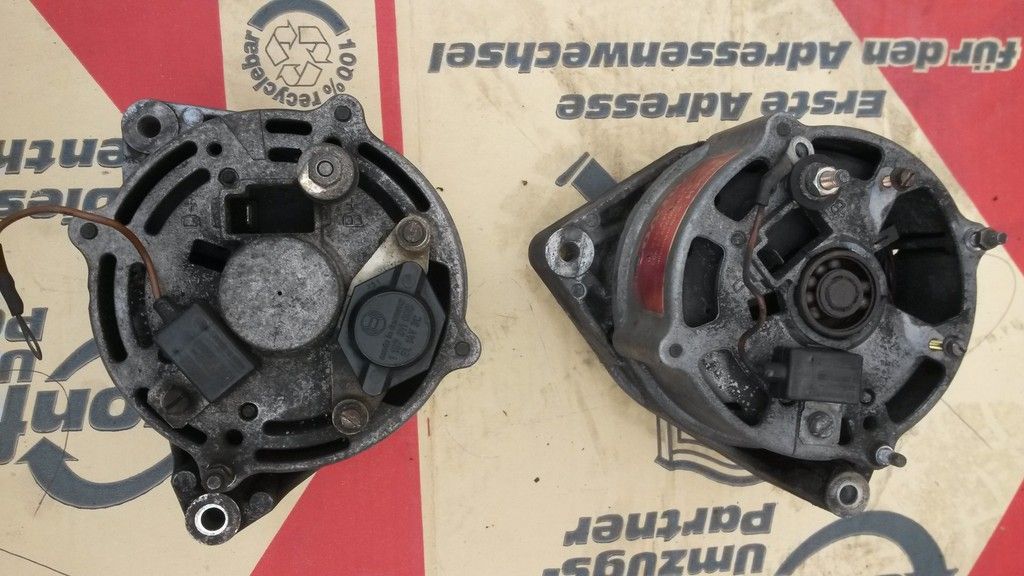

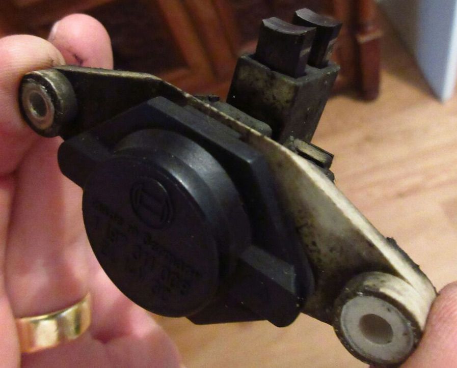

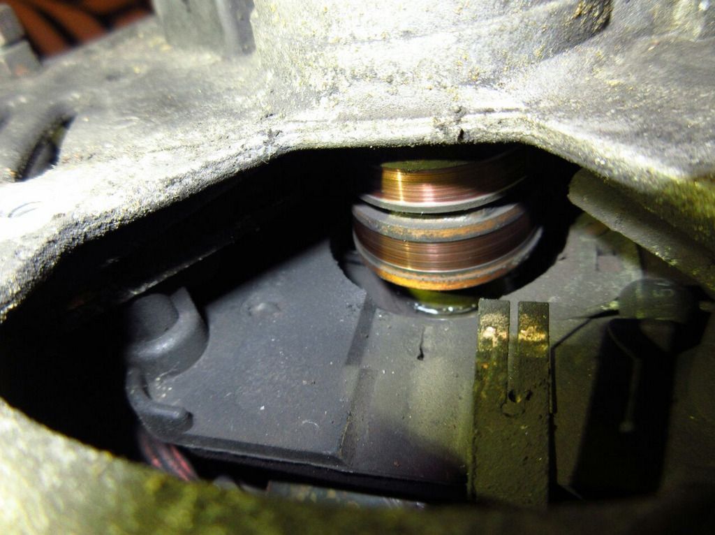

OK, the "new" alternator is up and running, with 14V arriving at the battery terminals with the lights, rear window heater, fan, foglights etc turned on. The carbon brush holder now has the voltage regulator built in, I've left the old one fitted to the inner wing, just to remind me of how it used to be :-)
Anyway, here are the pictures:
Regulator and carbon brushes (8mm long, should be good for a few more kms)
The condition of the slip rings:
Alternators "new vs old " (Bosch 0 120 489 065 and Bosch 0 120 400 932):

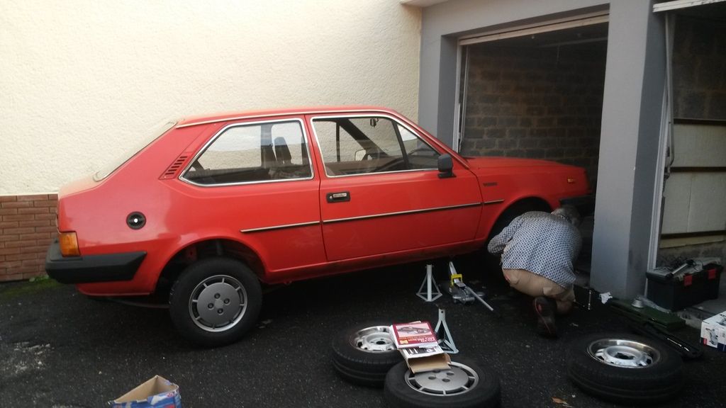

One problem that I hadn't reckoned with: this car doesn't have a drivebelt tensioner for the alternator. Replacing the alternator on my '88 360 a few years back was much easier, but on this car we had to ajust the tension manually with a crowbar - I'm not really sure how else to do it!
Fitted some winter tyres on Hercules alloys while we were at it, the original Michelin summer tyres on the steelies were from 2001. The Vredestein Snowtracs are from 2007, so not exactly fresh, but 4-5mm of tread should be OK to be getting on with. The 13" alloys aren't quite fitting to the model year (AFAIK they came out in '84 along with the 360 saloons) but I'm not too fussed, it's legal and can be changed pretty quickly.
Yes I know the car isn't standing great, the axle stand is just for security, there's no real weight on it ...
The next trip (a repeat effort after limping home from the last one) will be at the end of September - lets see how the car gets on with a 700km round trip.

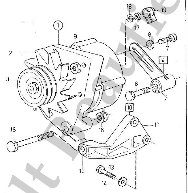

I'm sorry, I've been using the wrong terminology. The tensioner is there, it's the adjusting screw that's missing from it on earlier cars. Here are the pics from the parts catalogue:
B19:
B200:
Earlier cars don't have the adjusting screw (part 10 on the second pic), which means you need to need to pull at the alternator, making sure the drivebelts are tight, and tighten the screw (part 7, first pic) holding the top of the alternator in place at the same time. With the later versions, you can just use the tensioner adjusting screw slowly add tension to the drivebelts - much easier!

Post by volvodspec »
yes it's much easyer on the later versions, luckaly it's an easy retrofit, though many of the later style tensioners have the adjusting bolt rusted rock solid wich is why i did it slightly different for my B230 engine that's in the 343..
all stainless :) with the correct anti-seize SS grease this is a great solution

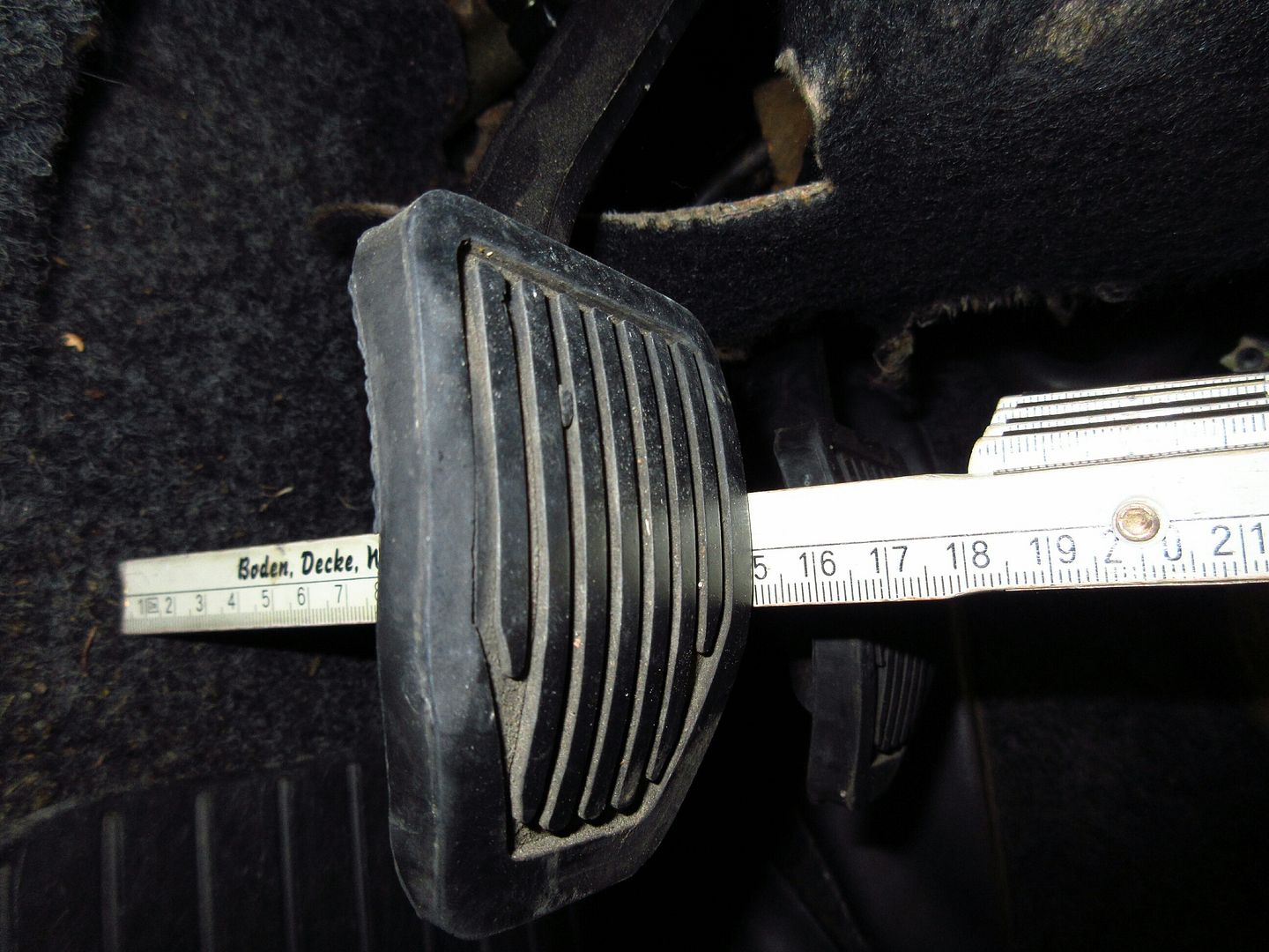

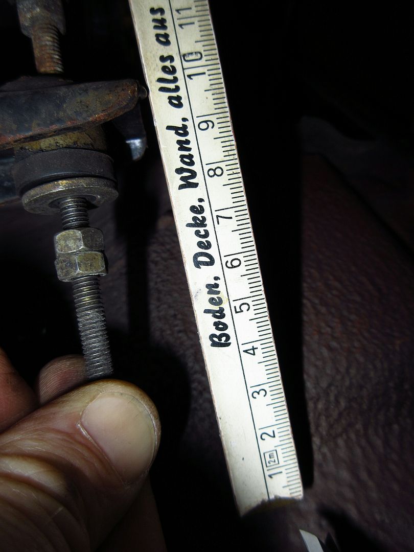

Just finished some more random work such as clutch ajustment according to "green book" measurements and thank goodness for my old external voltage regulator! More on that later.
The play was around 11mm (the value for RHD cars)
so set it to the correct LHD value, something between 7.5mm and 8mm...
... and now all is well :-) Clutch pedal distance from pedal to floor mat raised from 11-12cm to around 15cm.

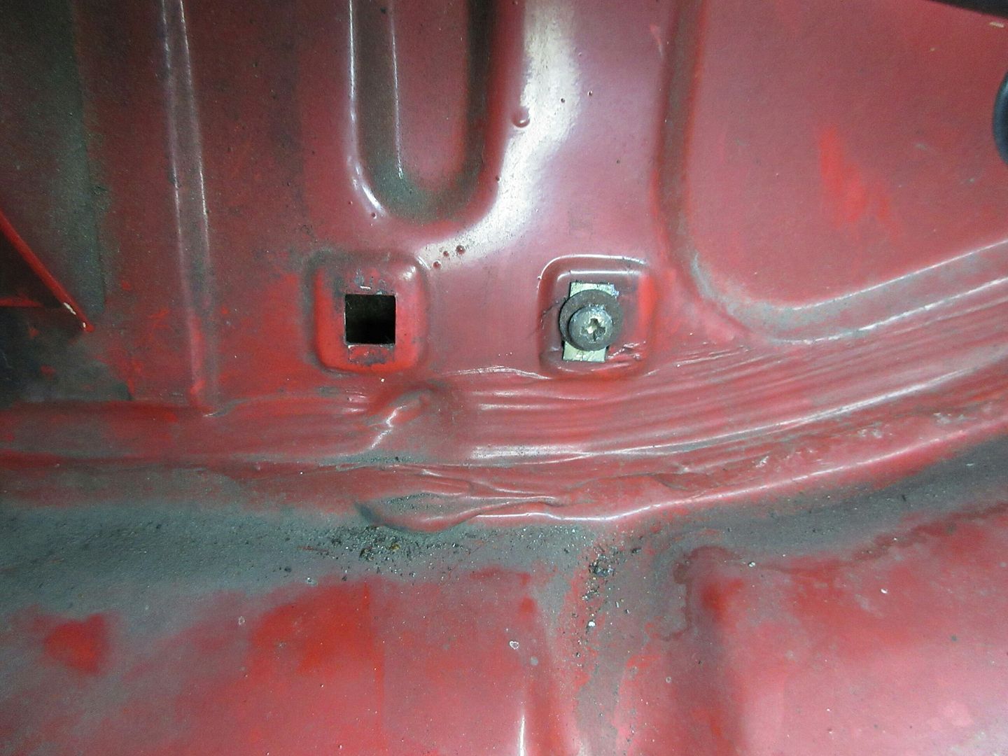

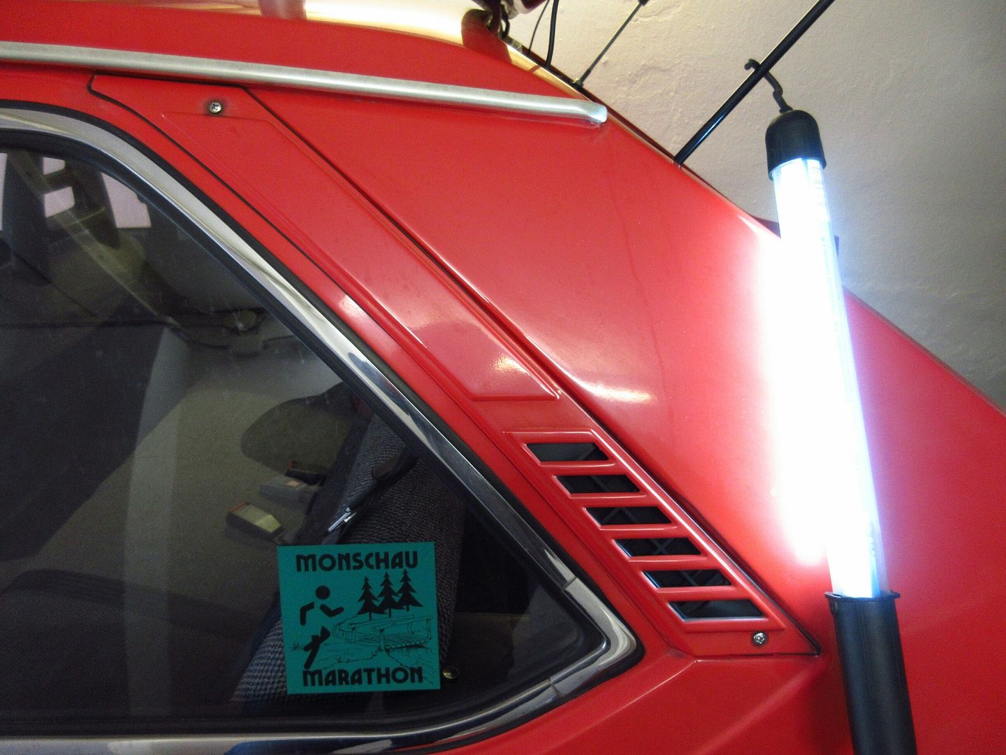

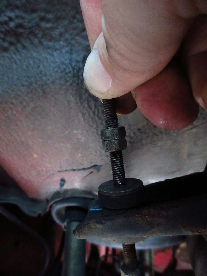

The second job: refitting the C-pillar panel. One of the two sheet nuts holding the screws in place had disintegrated, they look a bit like this close up ...
... meaning the cover was only held in place by the top screw. The part is NLA at Volvo and I couldn't find anything on the internet willing to sell me a 9mm nut in tiny quantities.
However, the parts catalogue is a great help, the only other place part number 3269355 is used on my DLS is for fitting the external voltage regulator to the inner wing! Since I no longer need it due to the newer alternator: off goes the voltage regulator and out comes the nut.
That's better!
A most satisfying lunch break, and we're all set for the repeat test run on Sunday! Let's see if we get further than 190km this time around.
