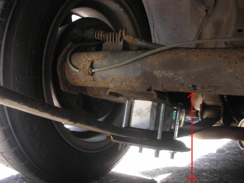

just to check.. get the rear axle on straight tarmac or something similar, then measure this L + R if it measures the same, its the leafspring and then i would replace them by pair. haven't seen this before on a 300 though

No, no double springs for me, thought i was missing a leaf.
Your right the drivers side i.e the side sitting lower doesn't seem to have much curve and i think thats whats causing the problem.
Although the rear hanger looks wonky taking a tape measure fron the axle to the bottom bolt on either side gives a different measurement of about 2mm so i don't think it's that, i reckon the spring has had it.
Do you mean if it measures the same, or was that meant to be different?

that measures if the axle is still straight; that could potentially mess up how the leafspring sits too, oh yeah. make sure that L+R is exactly the same tire pressure
if the measurements from axle to the gorund L + R are the same the axle is straight and you need a new pair of leafsprings
if those measurements are off it's the axle

Ah i see now. Well i've just moved it to a flatter part of the drive and guess what, it's now sitting somewhere more like level.
I did just pump the tyres up aswell while waiting for the reply
Edit: The measurement is the same on the axle from L-R.

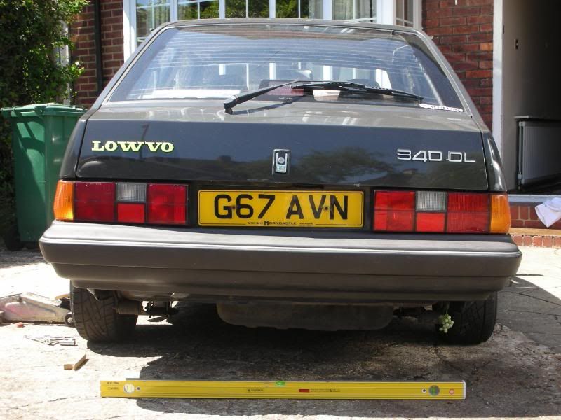

Right just to clear things up, no i didn't mess with the shackle (hanger) bolts at all, i just removed the driveshafts then took the bolts out of the spring plates, fitted the blocks and bolted it back up again.
Sometimes i do think i'm just a little bit retarded, well from this pic, clearly that lean is not right am i correct?:
Bearing in mind where it was on the drive, the floor was only out by 1/2" or so, but the suspension difference from side to side was almost 2,1/2". I had already jacked up both sides and lowered it back down, plus jumped it up and down on the springs to maybe try and settle them a bit, but it still stayed wonky. So i moved it to a flatter area and it seemed to square itself up. The shocks that would not return to extended position over night, then decided to work, so i reinstalled them and took it out for a drive.
Everything seems fine, not a dodgy angle in sight.
So after asking for all the help, removing shocks, replacing them, putting it all back together it seems as if there was never a problem!

when your front right wheel is in a ditch or your left front wheel is on a bump when you park it there, that could explain everything
