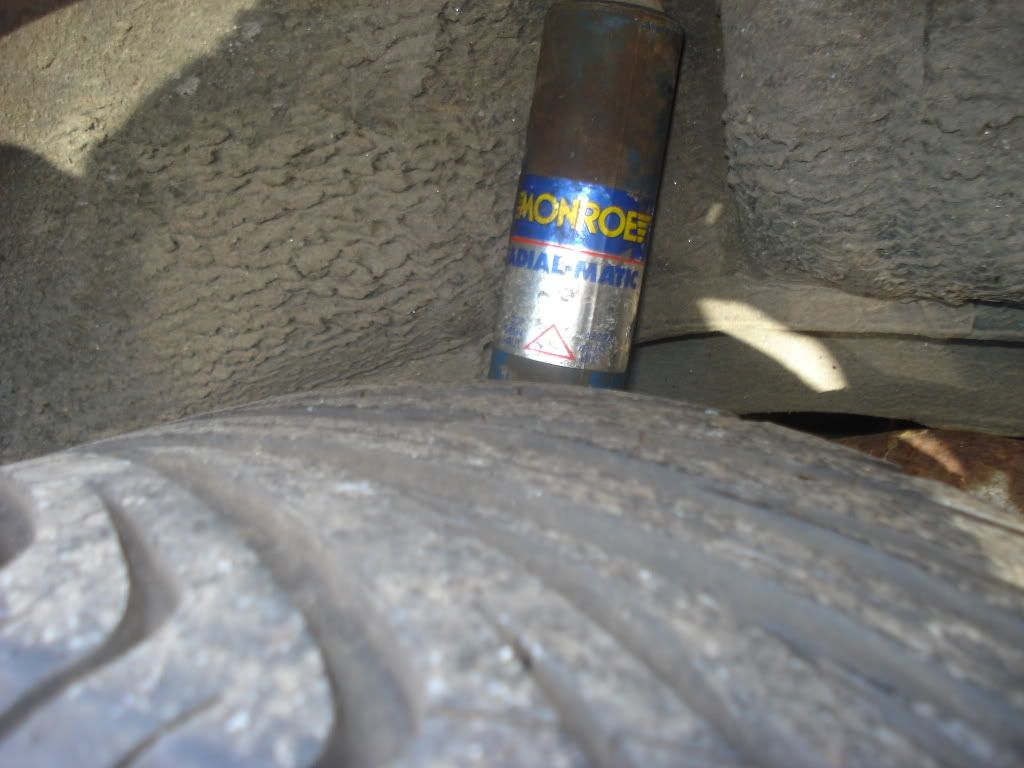

Re: Kessy mk2 340, Monroe shocks
Post by theo2468 »

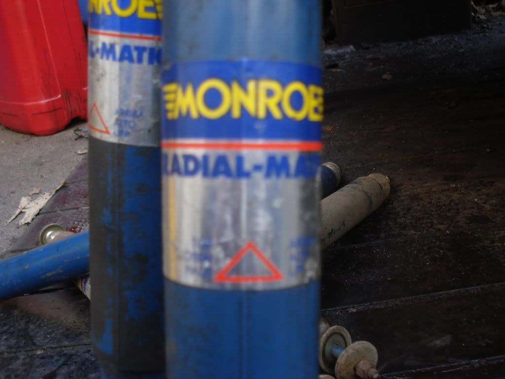

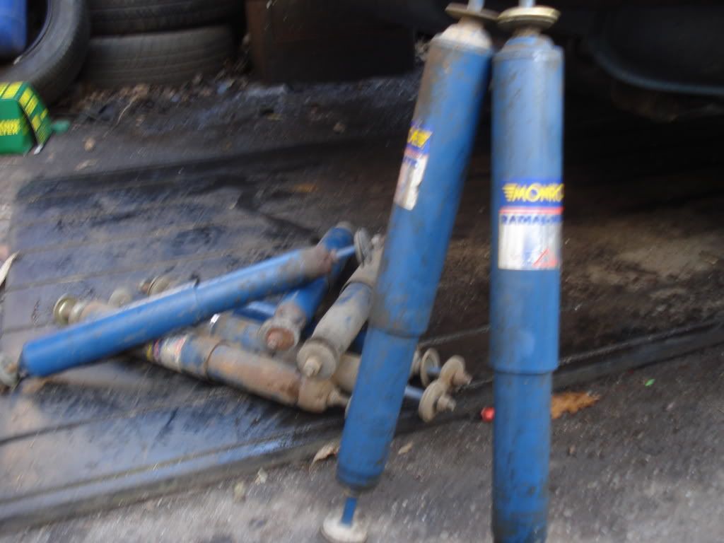

Changed the shocks today dug a load of monroe ones out the garage and it solved the leaning problem

Re: Kessy mk2 340, Leaning!
Really?
Thought it was the leaf spring nailed on.
Whod have thunk it. :)
theo2468 wrote:yeah im chuffed
still might try get some glt leaf springs tho
Yeah, good result man. Was the shock that came out completely done in?
Post by theo2468 »
volvosneverdie wrote:Yeah, good result man. Was the shock that came out completely done in?
yeah was fooked, changed the over one aswell.
