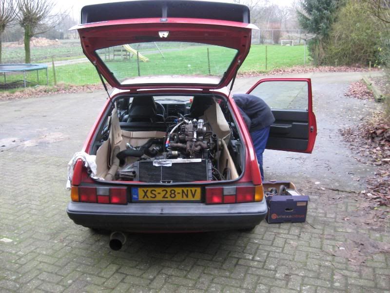

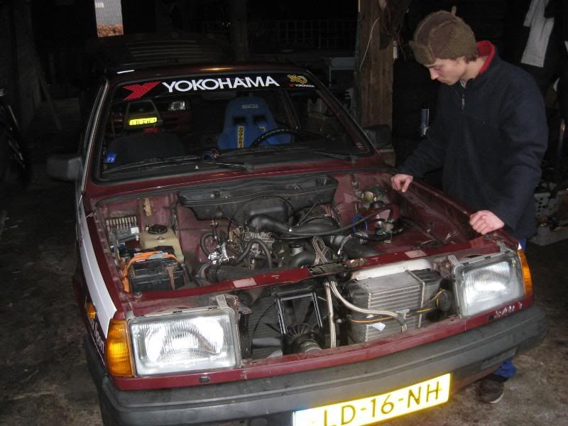

Yeah 340 is running again. The new owner of the 1400 turbo engine will pick it up in a few days. This way he can see its running great.
So I can already start making the F3N Volvo ready.
This must be called "hobby" lol
Post by volvodspec »

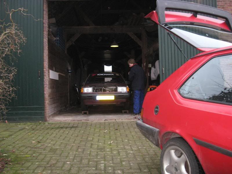

and the lucky new owner of the gtt engine is me :twisted:
tomorrow the gtt wil find a temporary new home, the trunk of my 340, and very very soon i'll put the engine where it belongs, under the hood!
Frits
Posts: 725
Joined: 04 Jun 2006 07:58 pm
Location: Netherlands
Post by Frits »
And its gone...

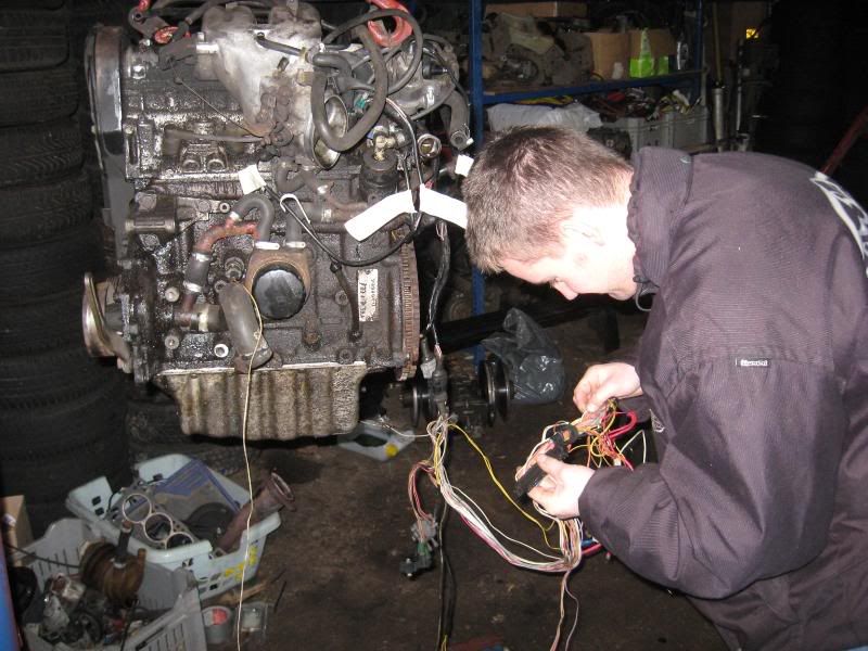

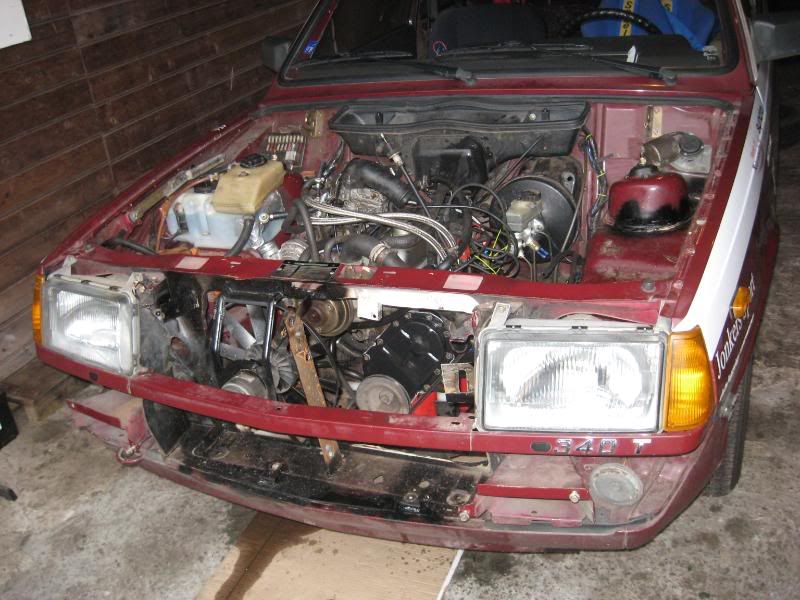

Directly started on the F3N. I found out its the 109hp version with fenix ECU.
Fitted the 1700 crossmember:

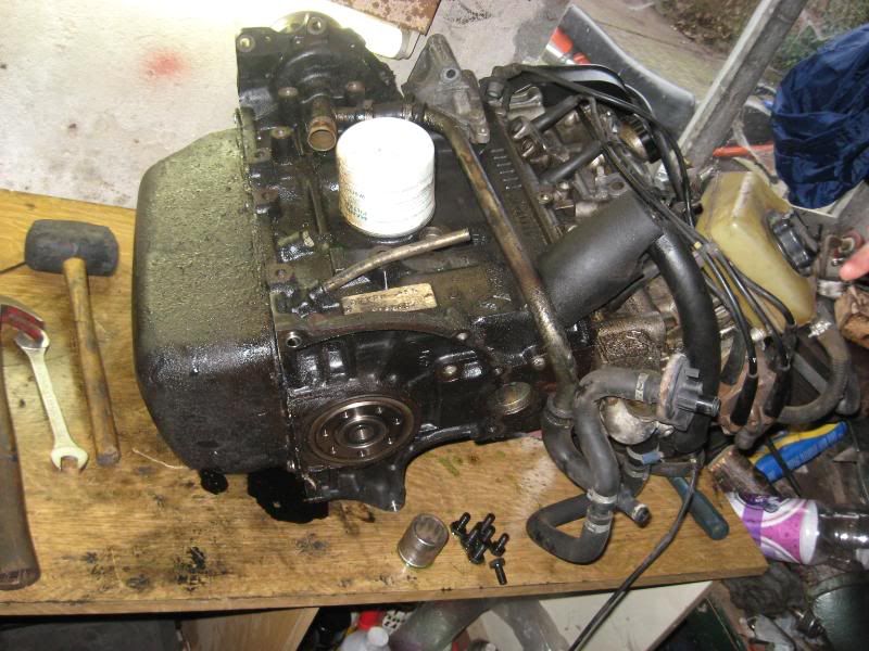

The old 1700 engine, sump already switched:

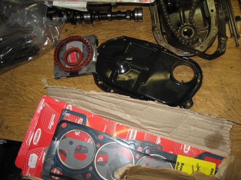

clutch parts:
The prise-bearing is fitted in the crank, I did'nt know. So I was stuck on not having a bearing. After Xmas I 'll buy a new bearing.

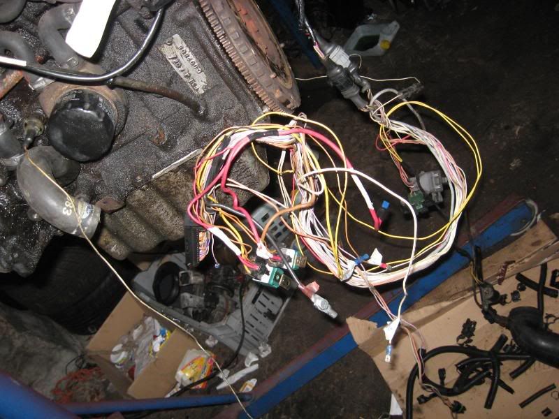

So what now? Electric stuffsss.. I'm colorblind, so a mate helped me out. Afterall the colours didn't match any book, or scheme. Demanteled the whole electrics.
Lambda
Knock knock sensor. take a look at the original heat exhanger
Exit old crappy electrics:
Wiring is ready for use. Engine is almost ready to fit the 340.

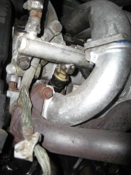

The intake is positioned wrong, so a mate is gonna reweld it. It will also be prepared for a 16v throttle bodie
The GTT engine was strong enough to brake both rear enginemounts

Frits wrote:The GTT engine was strong enough to brake both rear enginemounts
allemamachies (dawm!)
good thing you spotted this frits, i haven't even noticed it when we were taking out the engine, but i dit examine the frontbeam to see if the rigid enginemounts wouldn't make the steel tear..
looks like it ripped purely by torque, but thiss could still be the result of the stock front rubbers being tared all the way at your rally day? I will have to find a way to strengthen the mounts, just in case.
good to see that the F3N is making good progress!

Well, I also didn't notice. I noticed when I had to change the left one because of the 1700 engine.
The front crossmember looked good. Strange because only the front mounts where stiff and should get the most stress.
Don't forget I abused these mounts for about three year. And two times the fronts mounts where complete gone, so the rear got al the stress.
