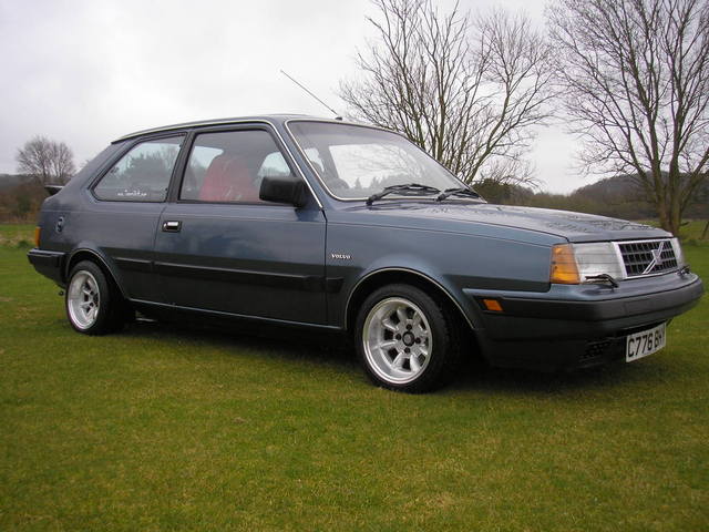

I got a blow out (hit a brick!) on the way to the scrappy a few years back. They put the larger profile tyres on the rear to get me home.
In this pic the car is pre lowered i.e stock height. Even if the front was down it would still look cack.
What profiles are they? 45 on the front?
ben..
Soz for slow reply. No they were Yoko 175/50's, i wouldn't have run them myself but they came on the wheels i got off a Mini forum so just used them until bald.
The backs in that pic are cheapo Camacs in 185/60, which i run all round now but Yoko's again.

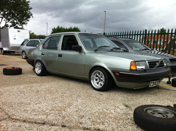

By slammed my own take on that would be like the pale green saloon on the previous pic, that looks pretty much slammed, but like the poster put ignore it, it's undriveable as the rear spring hangers scrape the floor.
Got pics?

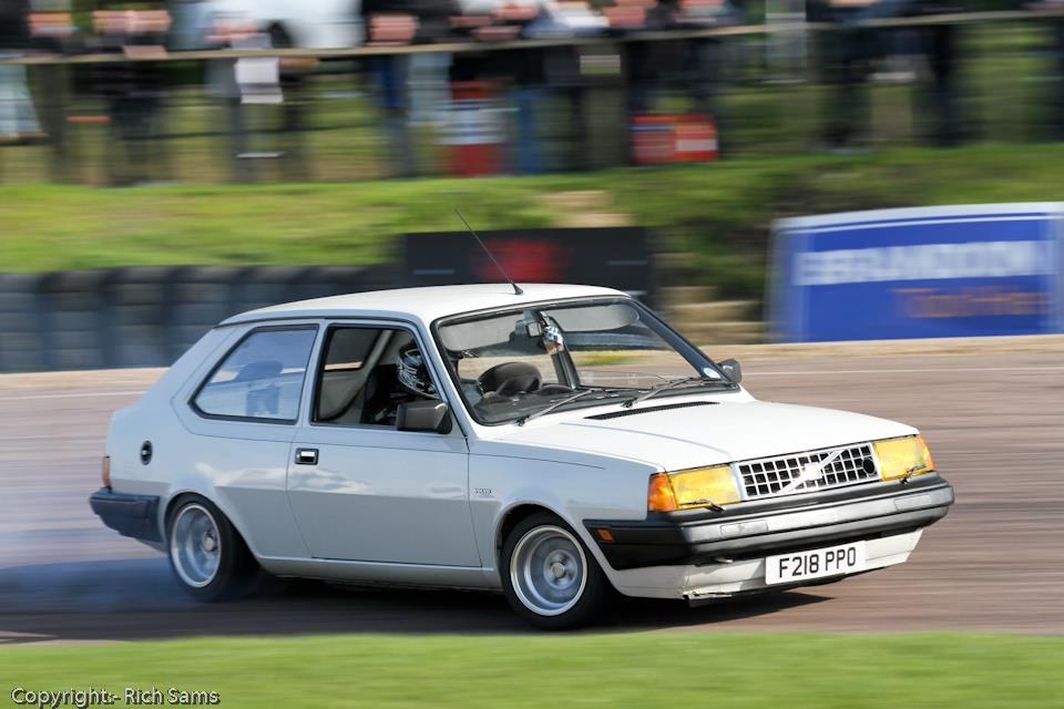

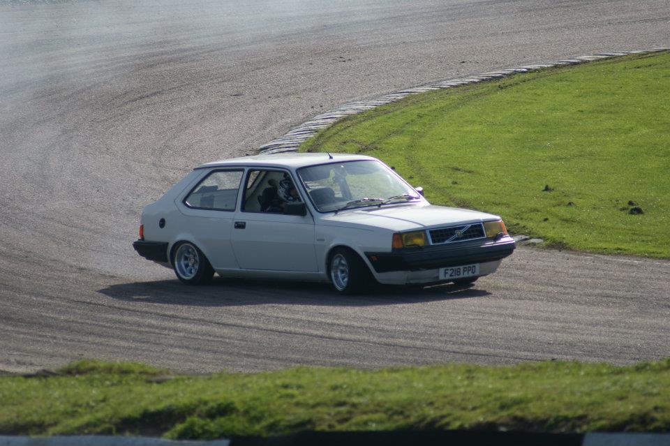

No obviously not that saloon because its un drivable on 4" blocks lol!! There is this one tho thats pretty fucking low on 13's:
Ben..

Fair enough, that white one is pretty low. Do you know if it's used as a daily or just a drifter? I think what i mean is yes you can slam them then, but it would be a right pita to use it like that what with the state of UK roads and amount of speed bumps we have.
Pretty sure my rims are 7". The pics you ask what size are the tyres, at a guess i'd say the same as the front ones in my pic on previous page, i.e 50's.
At the moment i run 185/60 but i personally don't like the rubber band tyre look, i'm old skool. It's lowered 3" allround, the fronts are fine, but the rears rub a little over big bumps/dips in the road and pretty much continually with my birds fat mates in the back , thats with rolled in rear arches too.
Yeah thats his daily! :) I am planning on getting 3" lowered all round and then get 13's and run 185 50 or 55 tyres if i can. Whats the standard size tyre for a 7j wheel? is it 195?

The white one is used and abused. The underside of that car will not be pretty in the slightest. Although now its running a 5 link backend, he still runs it so low to the floor, which is not the right way to go about the set-up. The pics your looking at of 13inch minilights will more than likely all be 7j, and running either 175/50/13 or a 195/45/13. The front of the green saloon is on 195's :) Im guessing that the blue one is on 175's.

We have already established this rob. You cant run 4inch blocks with 7j 195/45/13's, the dampers touch the floor! Thats why he had it on 14's... 3.5inches is pretty much the maximum, but then the dampers will still hit the floor on big bumps, oh and you'll have to look at relocating the exhaust below the axle :)
