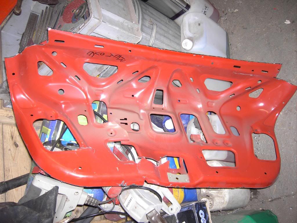

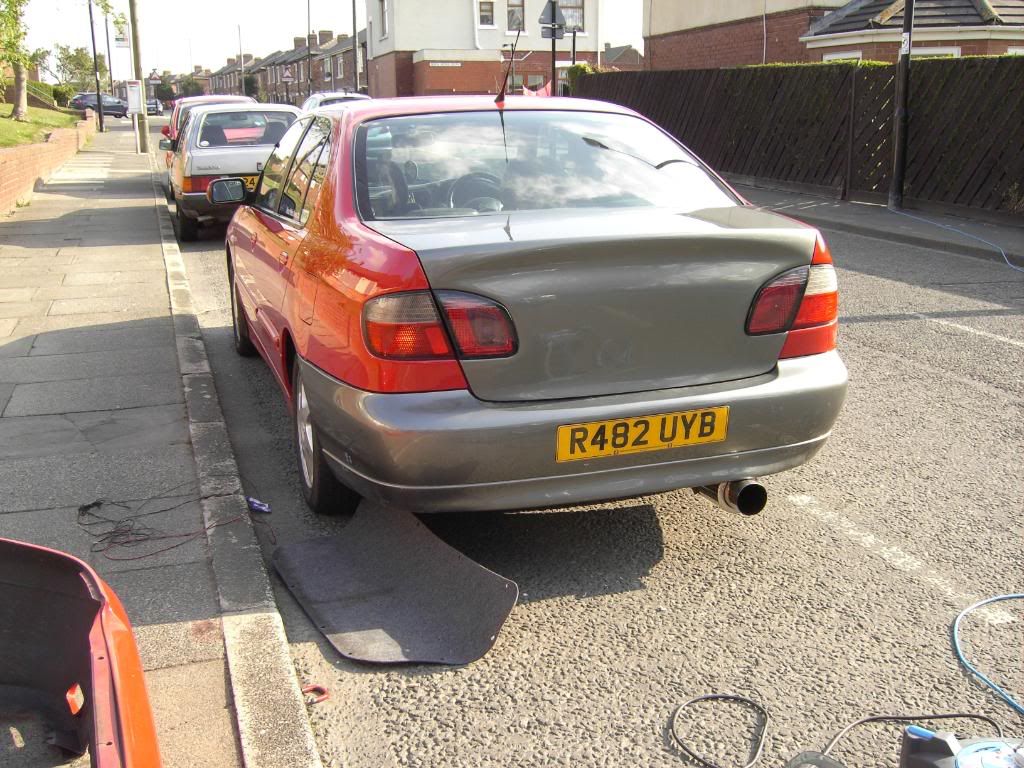

Update for B & J - damn those initials don't go well

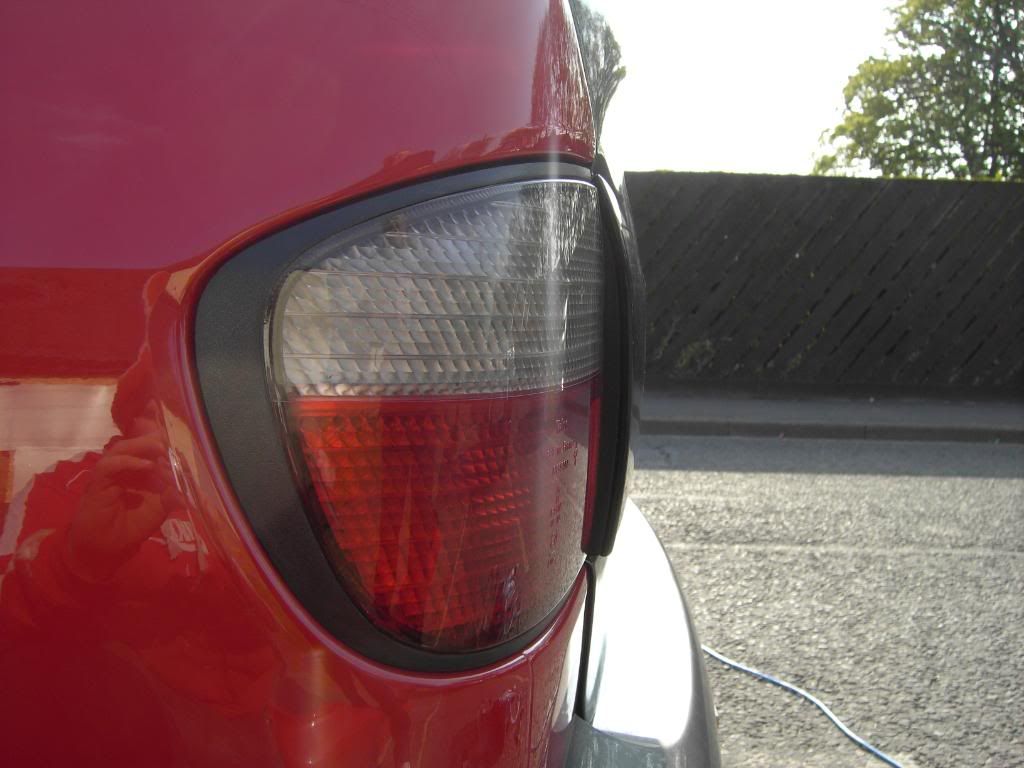

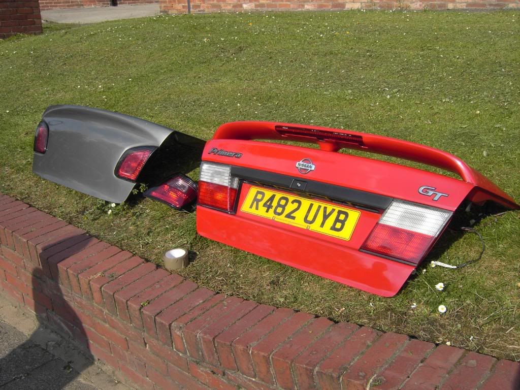

As said earlier, I want the car to have it's original look so persuaded my mate to swap boot lids/rear bumpers earlier than he had planned. We would have swapped outer tail lights today too, but due to me disecting one to fill with LEDs there is only one he can use lol
I aint gona miss them lol. Never looked right and although they are 'euro' they look dated in my eyes - probably sick of seeing them lol
Looking daft from all angles for now

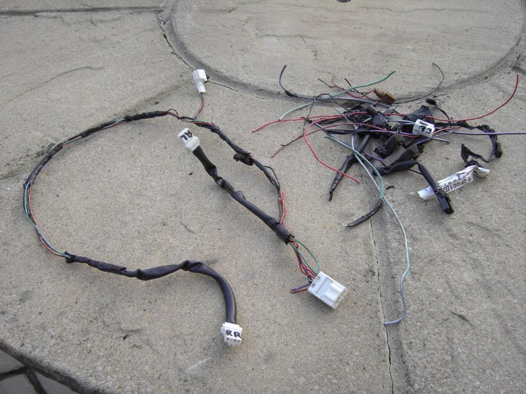

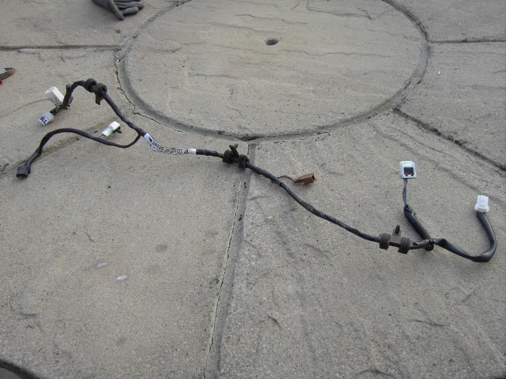

Boot loom stripped down to essentials

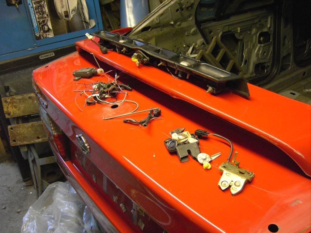

More for the bin/bay

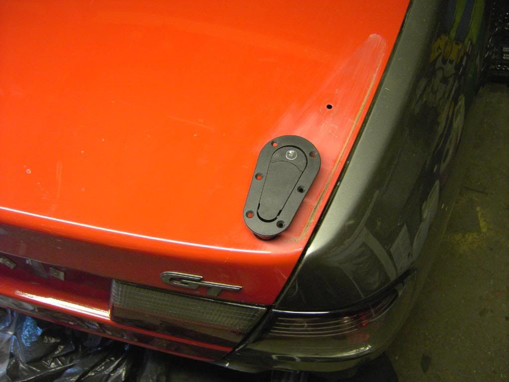

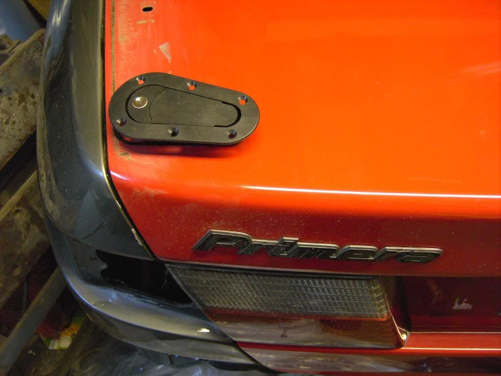

Unsure on aero catch placement, although I prefer the left - right mounting the most. I also need to still be able to access their locks when I find a spoiler

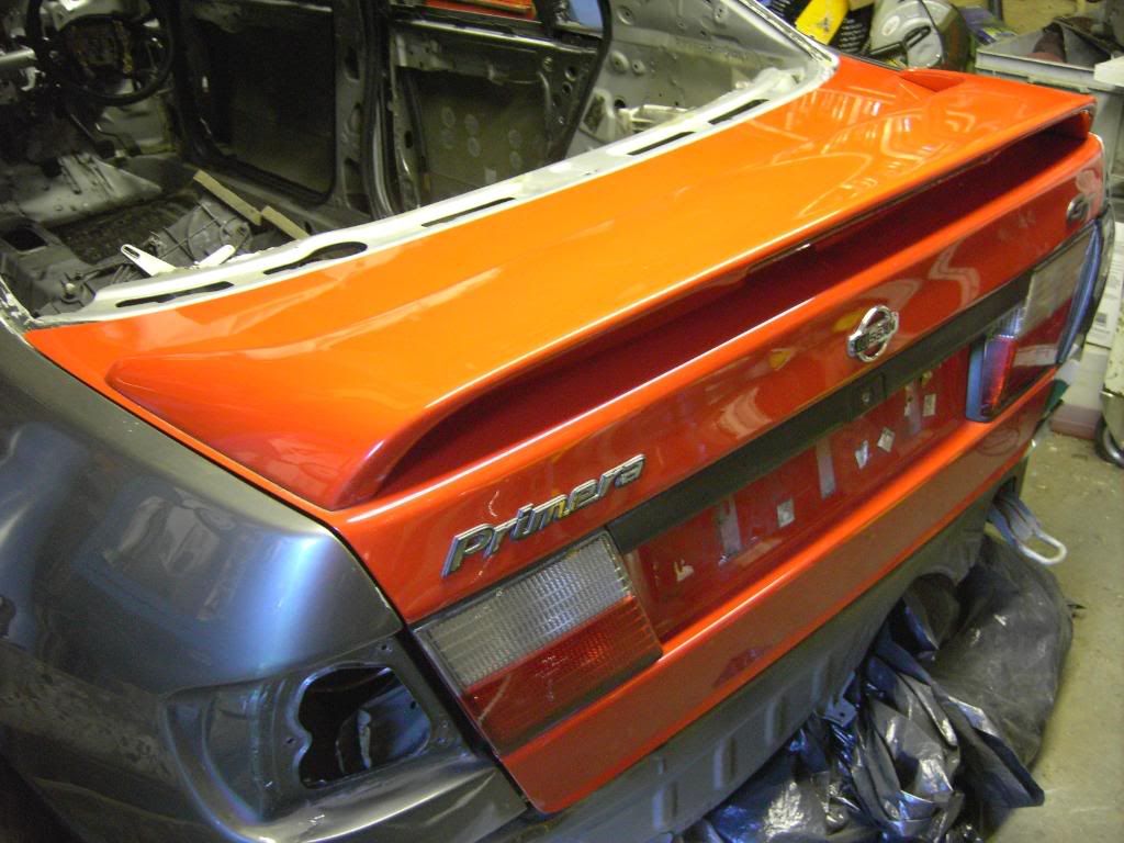

Here's how I intend the boot to look
As can be seen it doesn't need much work to look like the STC cars

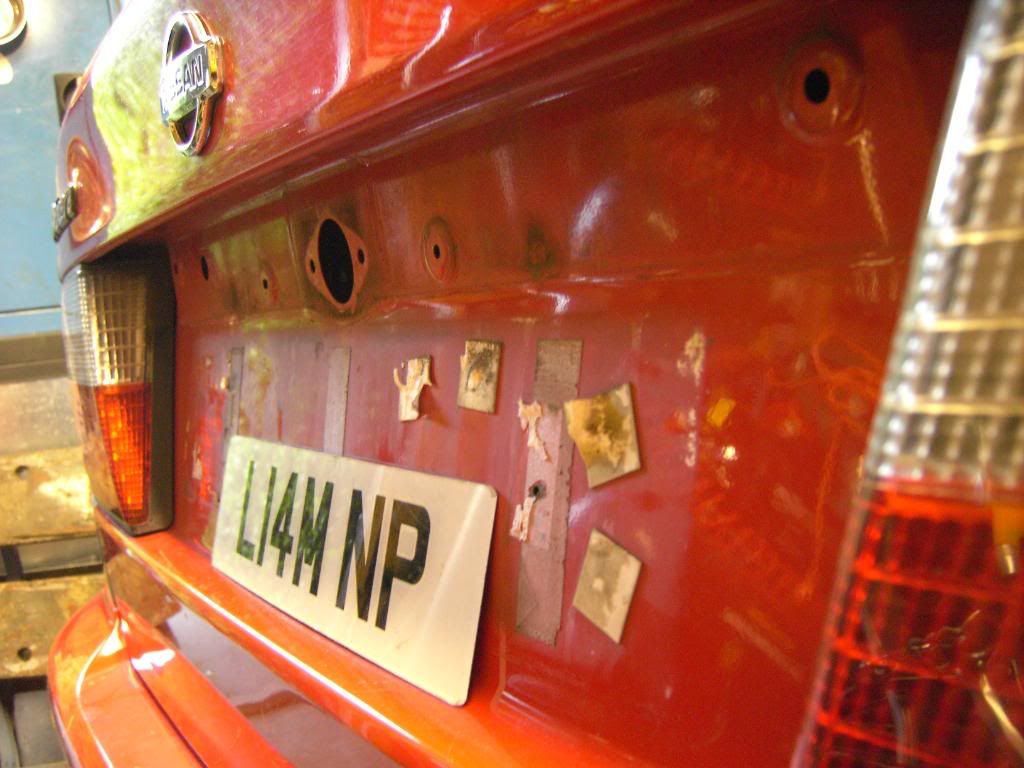

Spoiler/Grab handle & lock to be removed and holes welded up. I will flush mount no. plate lights like the one below

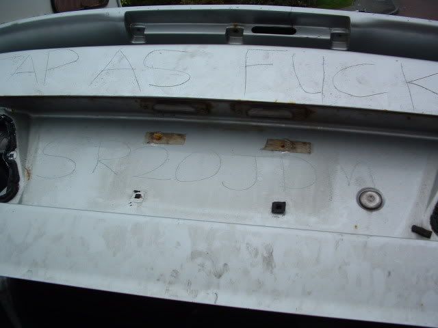

Damn I wish I had kept that JDM boot lid now because as can be seen, the UK boot is anything but flat beneath the grab handle
I may yet leave the lumps and bumps and just weld up the holes, although I would prefer it smooth.

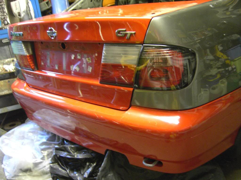

Final gay pic - this colour combo is growing on me. Bad I know
This week/weekend I will sort the boot out. Bumper is only being used so I can line up the tow eye that I will be fitting.

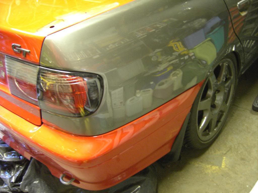

Aye new (old) boot is miles better. I will get another of the facelift ones and the lights too but will only smooth over the handle this time. The handle would be at home on an American fridge FFS lol
Closer to resembling how it left the factory now. Square FTW. We do like angles on here lol

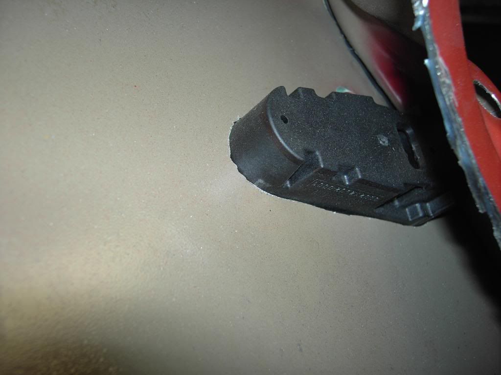

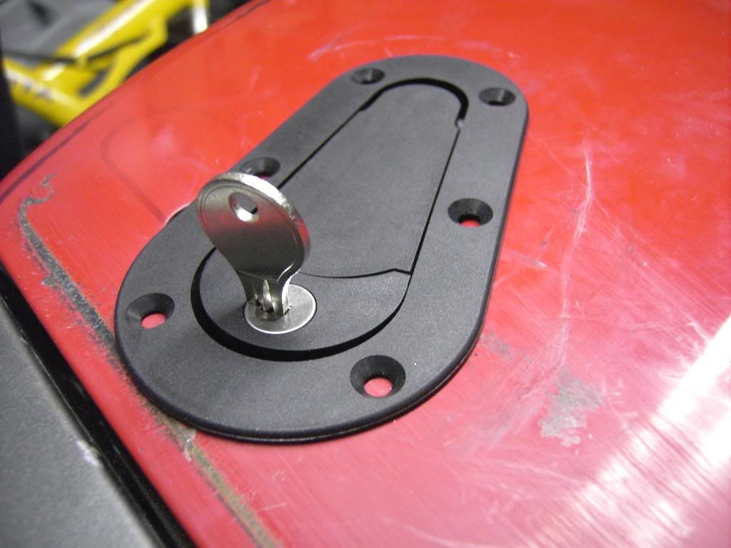

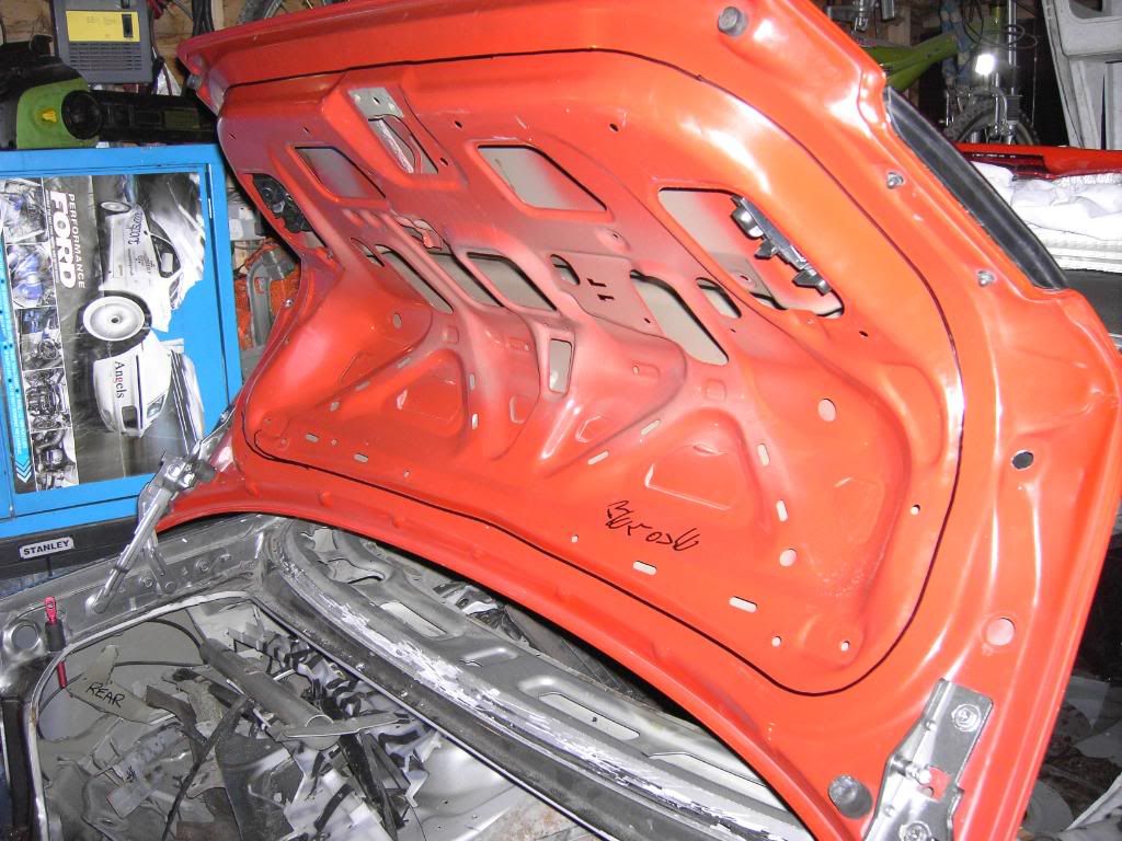

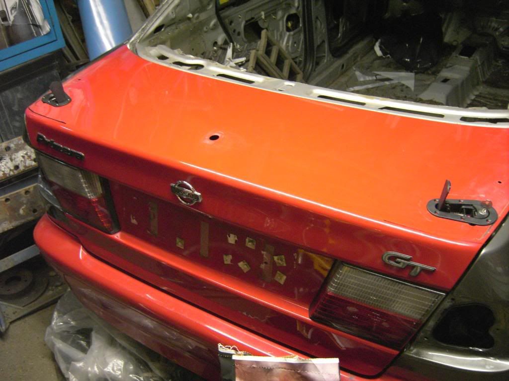

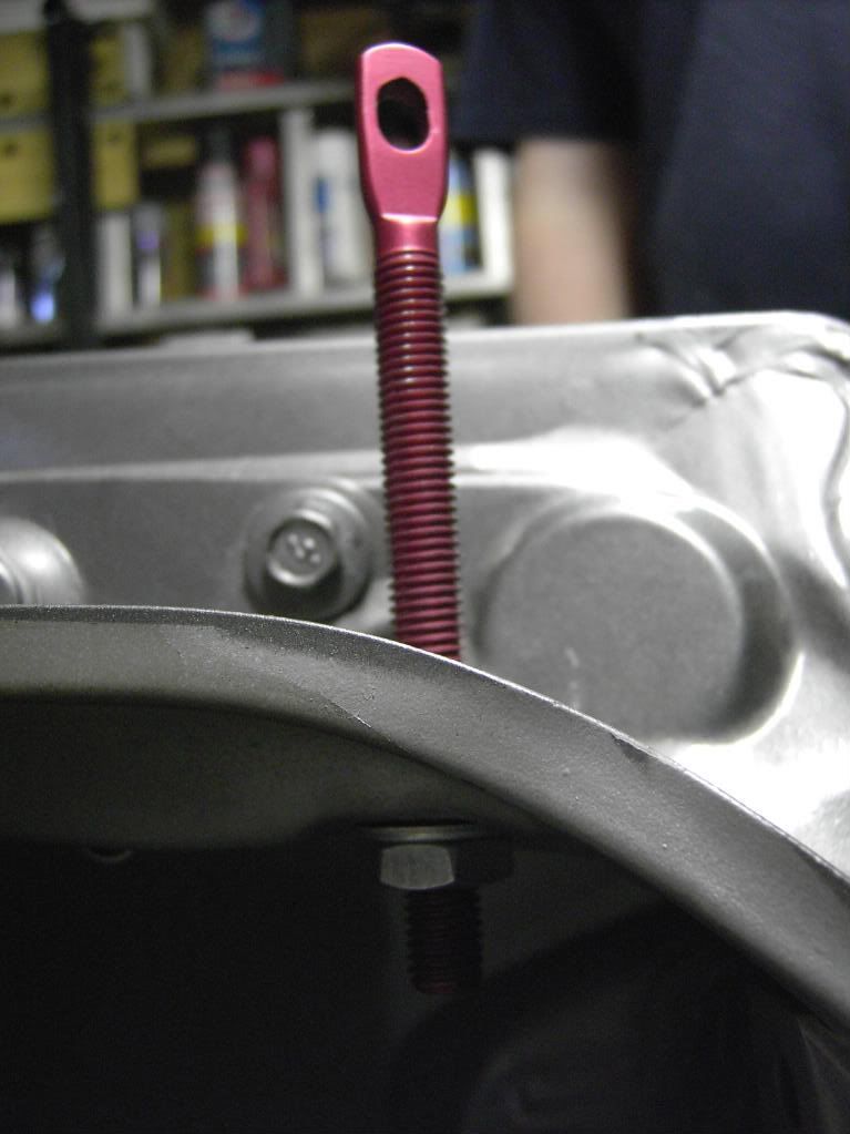

Done a bit yesterday. Aeros fitted.

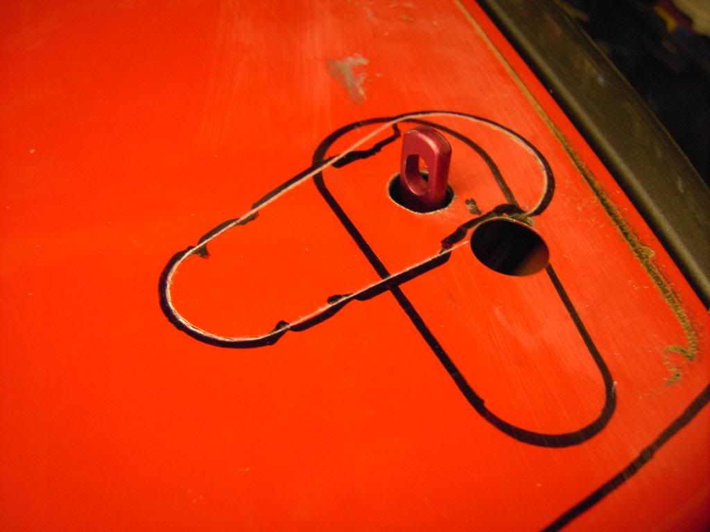

Strike pin gos through where one of the original bump stops were

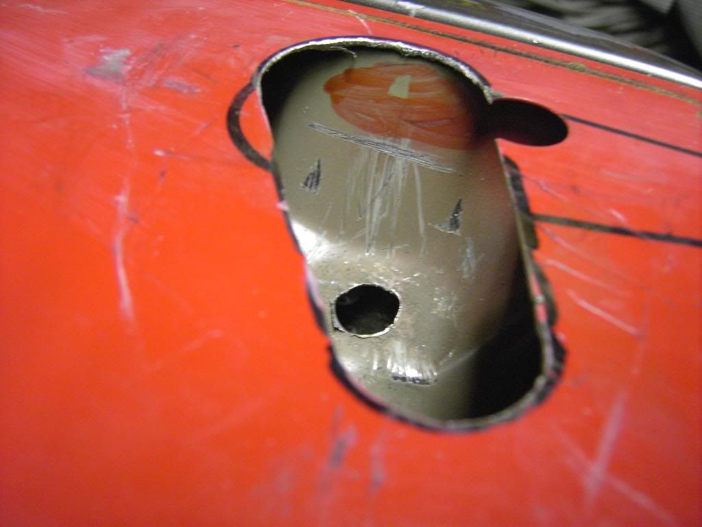

Can see here where the catch was fouling the inner skin. A couple of sharp chisel blows and the clearance issue was soon sorted.
Looks decent where visible IMO. I nitially considered cutting a section out. Can just see at the bottom of the pic where it's been hammered out. Strangely it's twice the width of a cold chisel lol
Fitted - still need to bolt in but the holes cut are almost perfect so it is a good tight fit anyway.

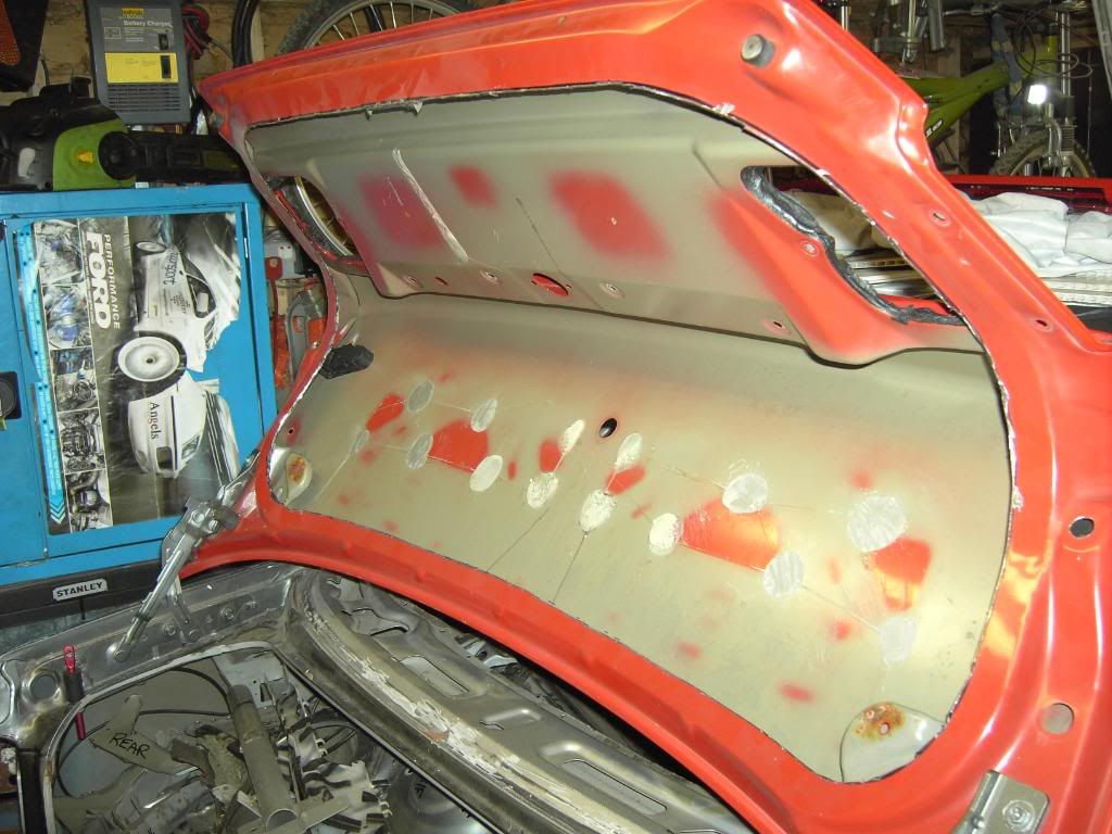

Then I went up to see a mate but he wasn't in so I turned my attention to hollowing out the boot. I don't think the garage wanted me to though lol
Not bad IMO for just the grinder and a little ghey clip on bulb light as the main garage lights had fused at the time but I didn't want to stop lol
For the win. I mean bin.
More mincing next time

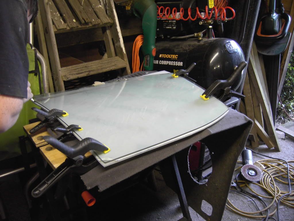

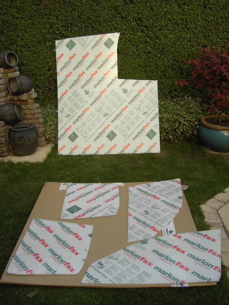

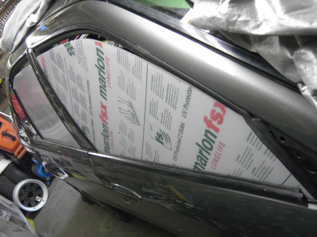

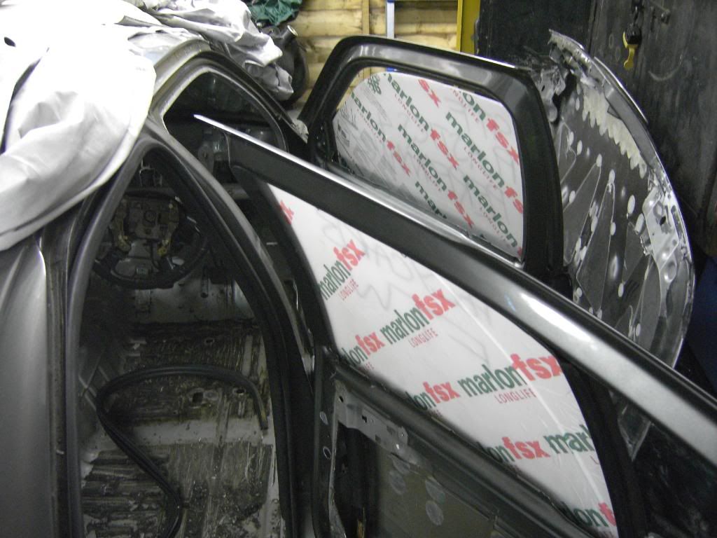

I can has plastic windows
I have had to use 5mm polycarbonate to make my windows as the original glass was over 4mm, and my mate who ordered me the sheet can only get 3mm or 5mm. So 5mm it is. Nowhere near as awkward to make as I expected.
The original glass has a wicked curve so I clamped the poly down to acquire the correct shape.
Don't have enough left to make the rear window lol - typical.

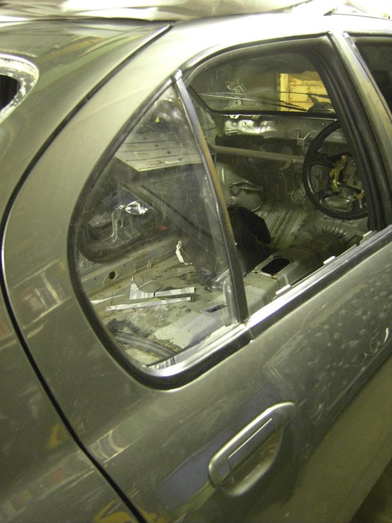

Thinner glass here. Made this from 3mm the other week
I'm waiting on another sheet (A3) of 3mm polycarbonate to make my other side 1/4 window and I also need to work out how I am going to bolt the 5mm to the window frames. I initially was going to affix it at that bottom, to the inner door skin but the sheet actually bows out and there isn't much or a chanel at the top of the window rubber to prevent that.
So I will be attaching them using this method.
Anyone know where to get the correct fixings from? Don't really want to nut and bolt it when it is on show.
It looks like the front window in that car won't go fully up but if it did, it would have holes that locate into pins in the clip that is under the rubbers, like the rear window.
I want. lol
