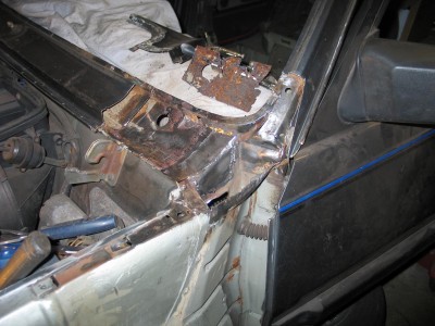

Made some progress with this difficult shape.
Repaired the windscreen curve
Let in vertical and horizontal patch to the inner corner
Layer 1
Layer 1
Used carboard template to work out shape for layer 2, aswell as diagrams above to work out what I am connecting, then cut out in metal

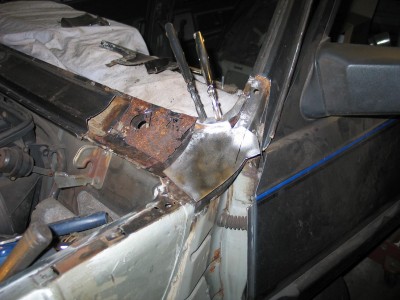

Attached layer 2 patch to the curve with mole grips and beat it down to the required curve (not critical as hidden).
Layer 2 cut out and beaten
Still a bit of trmming and shaping, but hardest bit over.

Chris_C wrote:I'm really not looking forward to the day I have to do this job. Good metal smacking skills RideOn!
Honestly it was easy, I have no bashing skills. Generally I can only repair flat parts, anything with curves or bend I often just weld it in partially then beat it down. Only tools - anvil, shears, claw hammer and mole grips, and lots of grinding equipment. This curve was easy because its just structural internal, no cosmetic aspect. The hard part was knowing what to connect to what because there was so much loss. Anything more complicated I cut from a donor, or weld flat parts together.
If the outer skin is not worth recovering, you can buy repair sections.

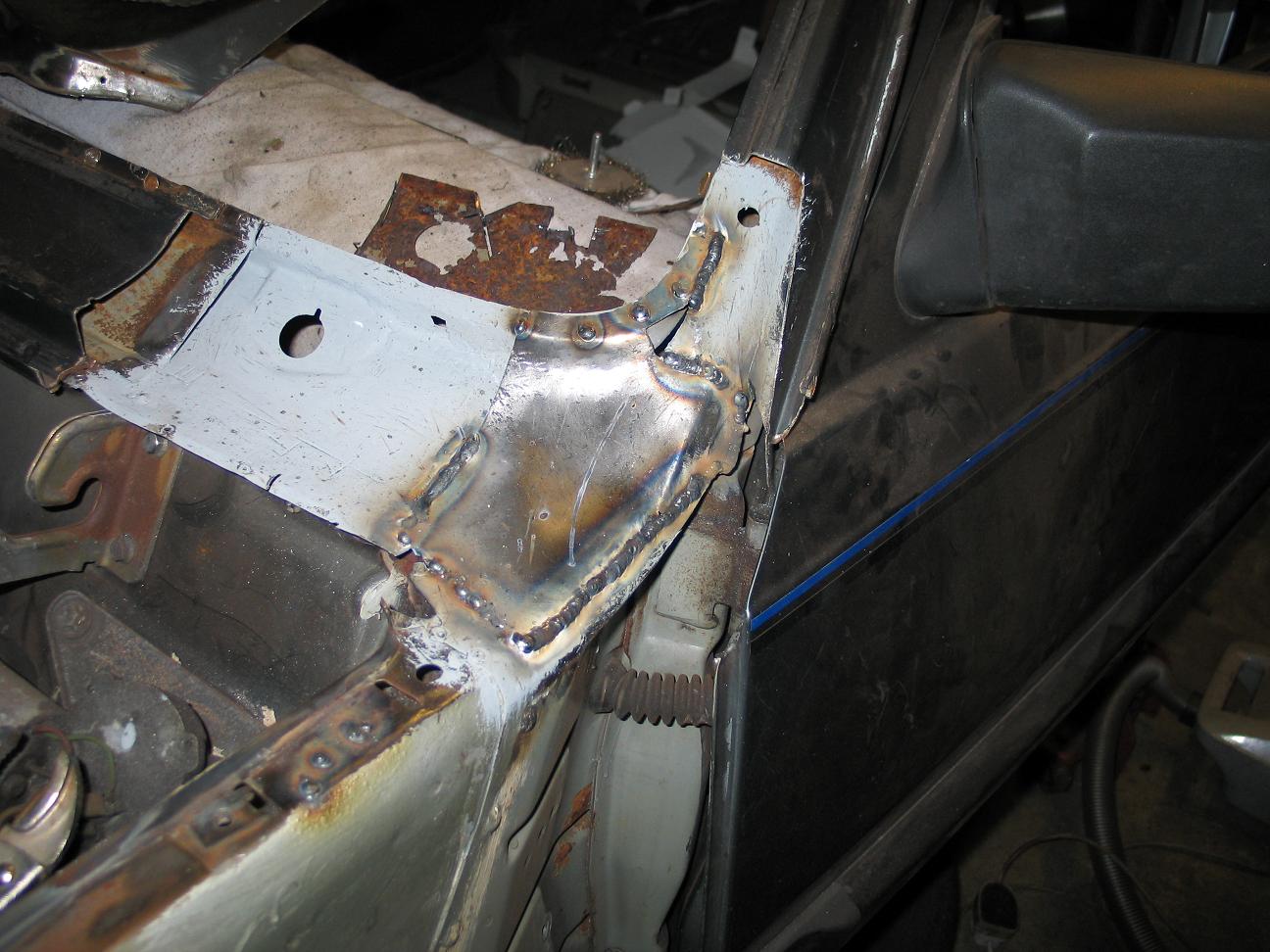

Some more photos to keep you interested
layer 2 welded
layer 2 welded
layer 2 finished and starting to add outer skin

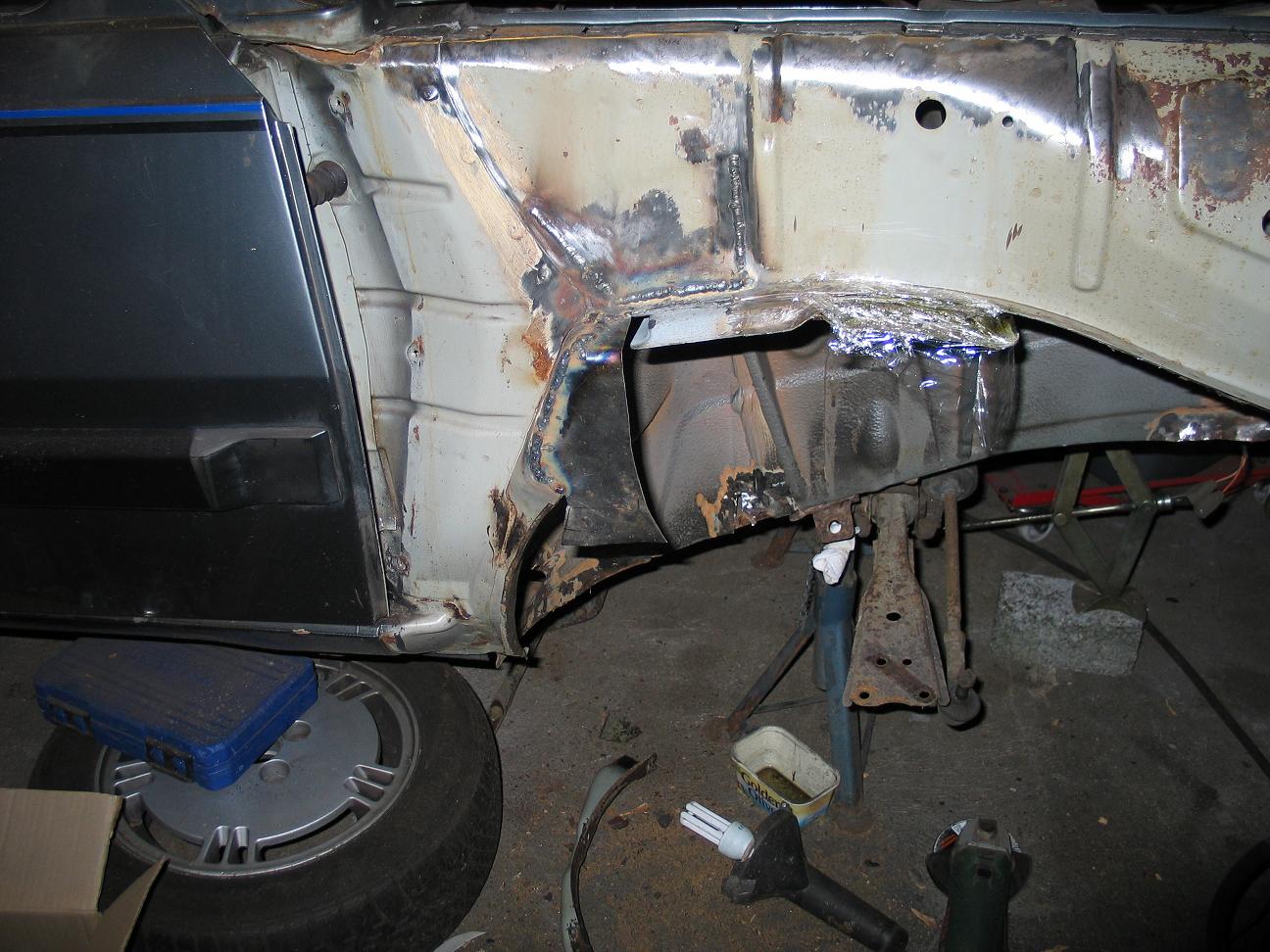

Inner guard repair
Inner guard repair
Inner guard welded (from Mchudd's car)
