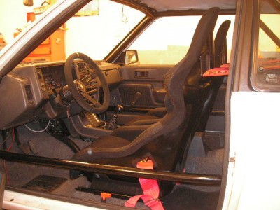

Seats :)

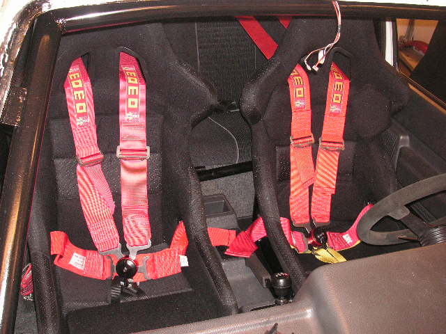

Post by peter schmidt »
Now can you take corners on the track.

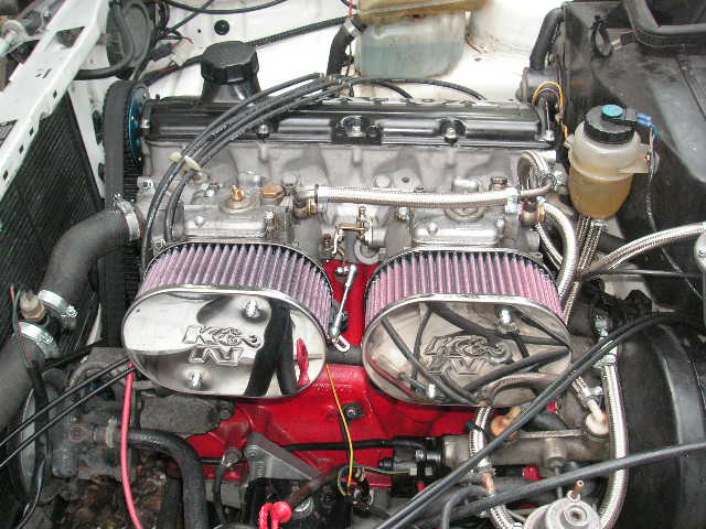

Engine
B230 block
Marin crankshaft 86mm strok = 2500cc
H-rods
Ported 531 cylhead with bigger valvs 46-38mm
camshaft 316 dur 13,2 lift 106 nock
Dubbelsprings
Home made exaust sytem
Twin weber 50 dco
aprox 240 hp

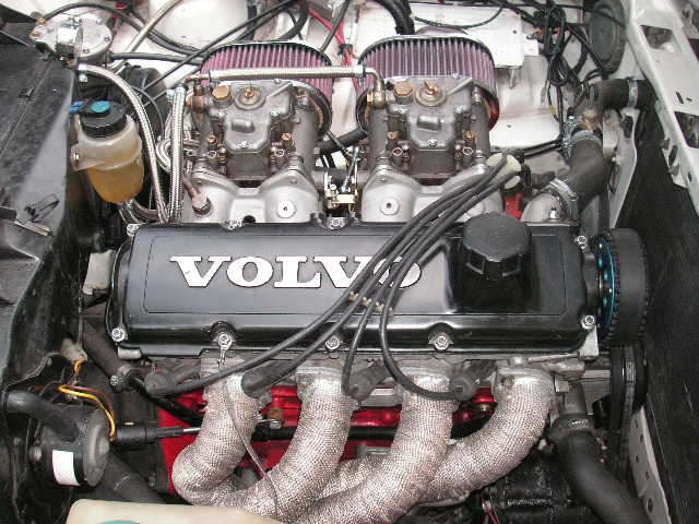

pic
Re: Peter Schmidt's newest build
Post by jtbo »
I spot adjustable cam gear, relocated master cylinder reservoir and power steering?
Have you been on dyno with that setup yet, what kind of torque curve it has?

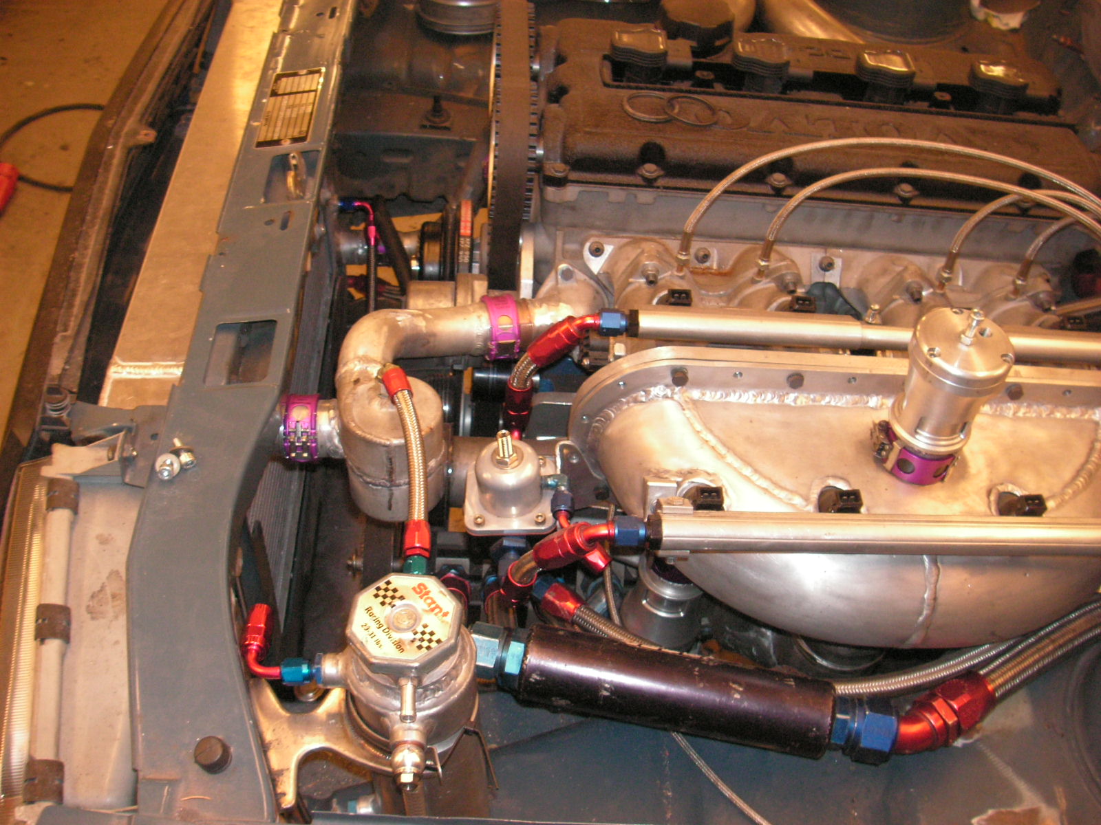

Here are som pic off my engine :D
