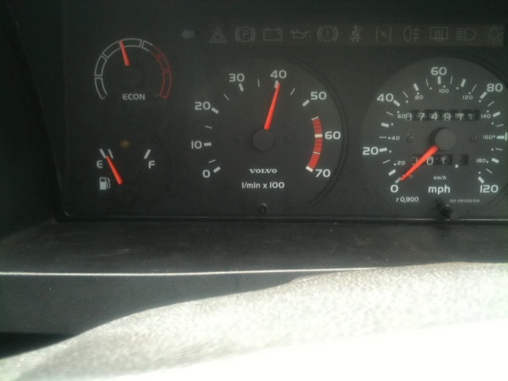

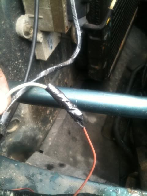

Re: Kessy mk2 340, Rev counter finally counting

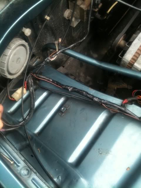

Had a day of college so thought i would get this rev counter sorted for good!!
So spent an hour first going through the wiring diagram=head ache.
The grey wire i had found was spose to wire up to a black wire further up the loom but i couldnt find it.
So taped it back up and ive and have ran a wire from the grey wire along the loom and to the back off the dash joining the black wire( 5th pin) on the dash connector and it was success!!!
Pics!!
The grey wire which sends the pulse from the rendix!
Grey wire connected to this brown wire to reach the dash, joined with blue connector and taped slightly (not finished)
All tidied up, can see the brown wire coming down the loom.
Brown wire going into the dash connector joining with the black wire(5th pin) probably could of taken the black wire out but thought it was best to leave it there.

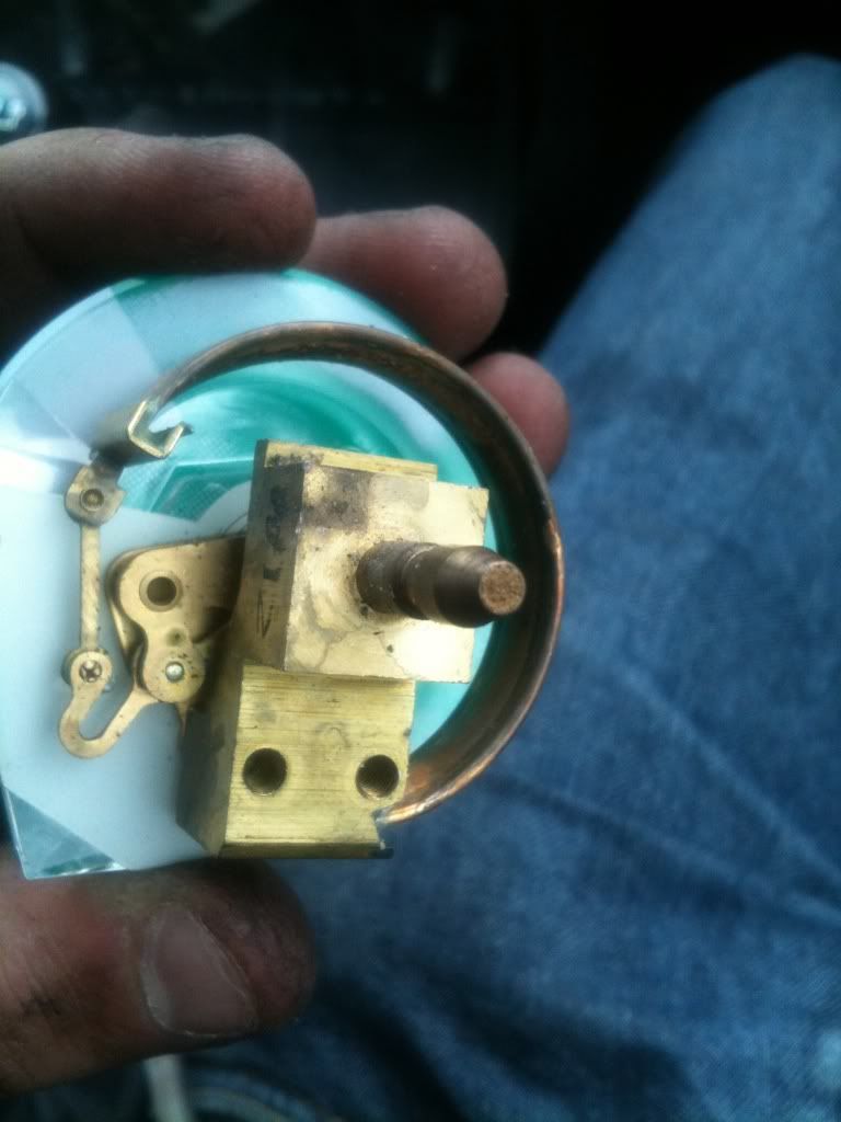

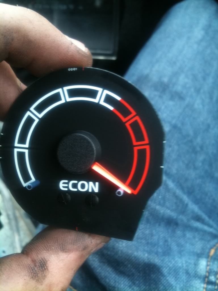

And while i was here thought i would spoil myself and put my preferred econometre in!! and if no ones seen how the econometre works heres a pic of the back.
And heres the final result! the dash is now in my eyes perfect.
How is economy measured then?
Well done! More gauges, more fun
Rev counter and econ are the ones to have - the ambient temp gauge is always wrong, and I've never really needed voltmeter, oil temp & pressure either ...

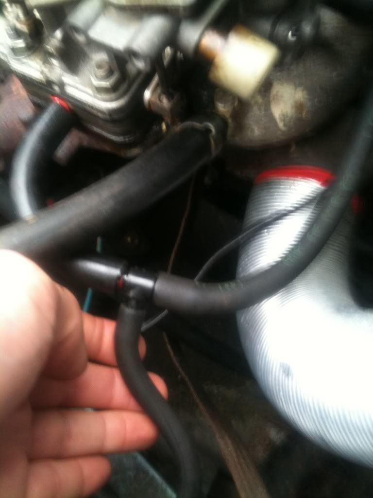

vacuum off the carb, theres a pipe coming off then it goes into a "t" piece (as pictured) the bottom one is the pipe for the eco metre.Speedy88 wrote:How is economy measured then?
the vacuum pulls this mechanism down causing the needle to move. there is some fancy name for the eco's mechanism but ive forgotten it!
yeah i like gauges with needles that move alot! so the econ and the rev counter are defiantly the ones for metrabitom99 wrote:Well done! More gauges, more fun![]()

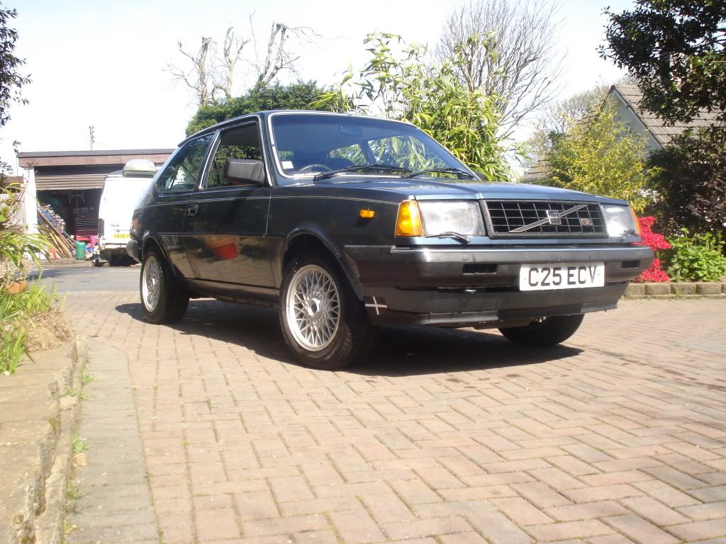

Re: Kessy mk2 340, Few little tweeks!
centre caps, not bad for 3:50!
The old moose
personal touch whick i think looks bit more retro!
And a few pics.
The old moose
And a few pics.

Re: Kessy mk2 340, few little tweaks
Those wheels work really well. Cars looking good in that cornish sunshine
Fantastic car theo. I like the black headlight inserts, makes a load of difference. Glad you got the rev counter sorted too. Wheels and centre caps look fantastic!
shame i took those photos before i put the center caps because they some how make such a difference!
Really like how this is coming a long, with the right tyres and a bit of lowering it'll look fantastic. Great colour too!
dawm, those new hubcaps are a BIG improvement! looks good
