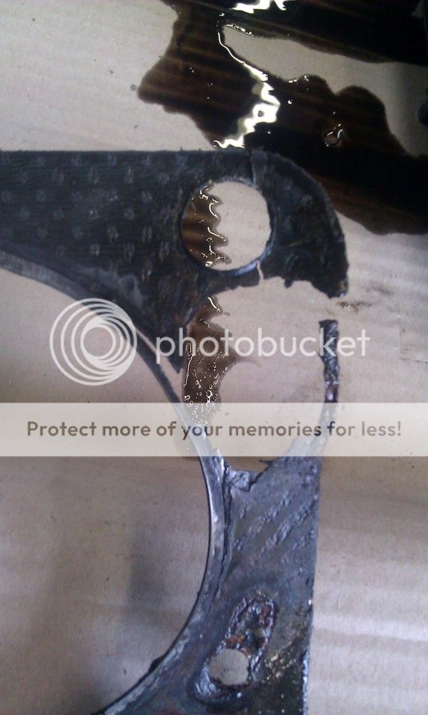

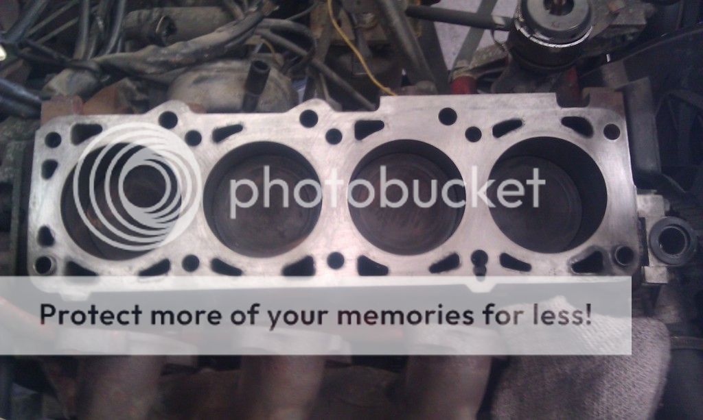

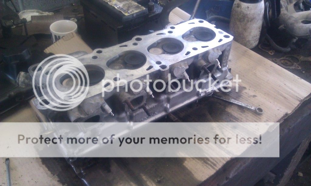

I got started on it today, had a close look and it was clear that it wasn't the water pump so off came the head. Funnily it had gone in the same place as pettew's had. Cleaned and inspected it all up, both block and head are fine but some corrosion on one water jacket. Next Job is to do the valve stem seals, then I can start putting it back together so progress has been good
Ill post some photos later
I took the valves out and cleaned them, change valve stem seals and the cam shaft seals.
I lapped all the valves
This is where it had begin to blow through and is alittle corroded and cleaned it up.

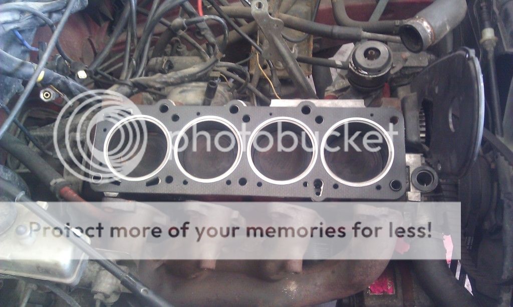

Re: Evoman's 360 GLT [New Wheels]
I got it all back together it runs really nice, much nicer than before although it seems a little underpowered, is there any kind of bedding phase or it could just be my imagination
