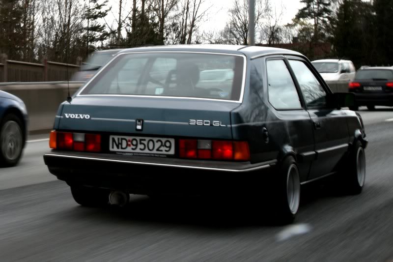

This got sppacers on it? Looks like theres a bit of poke for 7j?
Ben..
Attack2001
Posts: 1015
Joined: 05 Jun 2011 03:45 pm
Location: Rochester, Kent
Re: Minilites
Post by Attack2001 »
Benfraser wrote:
Ben..
Thats cos its running low offset 8j alleycats :wink: And looks savage!! :twisted: :twisted:
