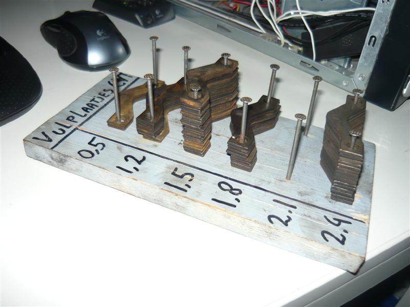

volvodspec wrote:adjusted the clutch:
airgap was waay to big. now with 2mm of adjustments plates the airgap is perfect and driving is way better. also noticed that the gearleverplay is in the primary gearbox, too bad. that means i'll have to keep selecting P first before going to R..
I may have to adjust my clutch real soon now (when the frost goes away). Do you have a source for the adjustment plates? Or can you scan the outline of one, as I have good contacts to a company that does lasercutting...
Also selecting P first is already like second nature to me... I don't even think that it's a hassle anymore. :lol:

well i spend a few minutes on google and all i could find were these with a pricerange of at least 90 euro's, but now i looked again and noticed another one of 36 euro's, that's more like it :D
as for the adjustment plates, i filled the board below up myself sm4 sm4 so yeah, i adjusted a few :lol:
P1000808 (Medium).JPG (63.26 KiB) Viewed 10570 times
and i have about 18 plates lying loose wich require measurement before going onto that board, including 2 sets of 2.1 i believe. it's now become the v3c stock so at technical days and such we can instantly provide the correct plates and i confiscate the old ones :lol:
most of the time removing one set of plates is enough to get the airgap correct, i haven't got a scanner but maybe i can sort something out in the following week. and if possible, i would like to get a load of plates made!

Nice pic of the adjustment plates, Anjo :-) AFAIK, the thinner plates are the harder ones to come by these days.
nomead: Danny from dafhobby.nl is sure to have some plates for you!

trabitom99 wrote:nomead: Danny from dafhobby.nl is sure to have some plates for you!
I'd need to measure the current gap first... But the point was to "future-proof" even this small part. I'm not sure I can match the exact thickness range of factory-made adjustment plates, but a few different like 0.7 1.0 1.5 2.0 should be easy.
