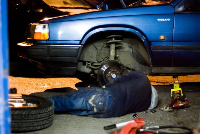

:shock: Jack lean
Re: Derrick the Volvo! (Much pics! P34)
Post by volvosneverdie » 09 Nov 2011 09:54 am
^ just add axle stands.
For added staying alive.

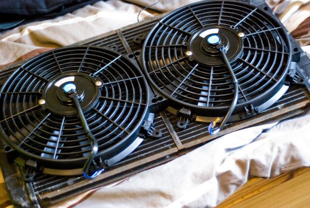

Got a larger rad I bought off MCHUDD ages ago, and a dual rad set-up. It won't be in for awhile, as money is tight, and I need the car for driving. That, and it'll involve re-doing pipe work to make it neater. The rad on there at the mo is in dire need of replacing, as it's been leaking slightly ever since I put the F7R in. As it's coming up to winter now, I'll need to get it done soon.

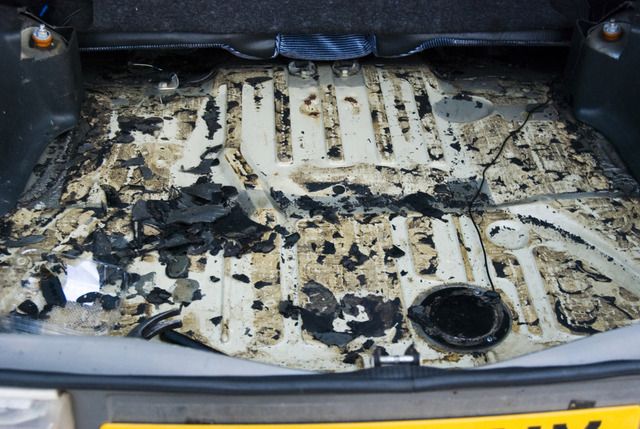

Where I got rid of some terrible crumbly sound deadening! :D

[quote="jon-ovlov"]ha ha haaa! VND, brilliant.
im going to make the same thing on mine i have one fan atm looks like the same one aswell will get another i think how are u fitting them onto the rad? cheers

Charlie, The clips that go on the rad are the perfect size for the rad's height. I'll space them out a little from the rad, and drill through the top and bottom rad lip (not part of the water ways) and bolt it there. I'll make a small bracket to support them in the middle too.

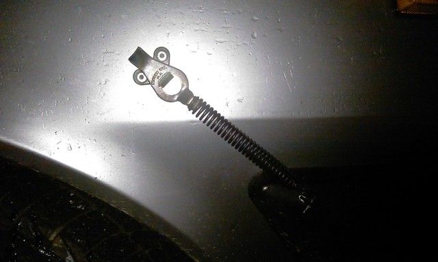

Fitted some QR bumper clips today, bargain, and it means I can wip the bumper off quick without faffing with removing the bolt covers and undoing 4 bolts. Wasn't sure how they'd hold, whether it'd be really loose. but it's really not!! It's not coming off any time soon of it's own accord! :lol: I'll get some pics when it's day light and not raining.
