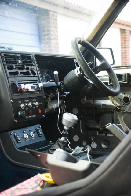

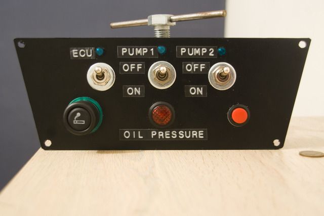

Cheers guys! Always great to hear comments like that! Mr Nimminz, I tapped a thread through the plastic, wasn't sure how it would work at first, but does the job very well! I've now done a mk2 version of the top panel. This time it has two pump switches, and a different horn button (easier to push) and a cig lighter (not because I smoke, I can use it to charge stuff like phones etc.) I left the wiring for the cig lighter in there when I did the first panel, so won't be hard to wire in!

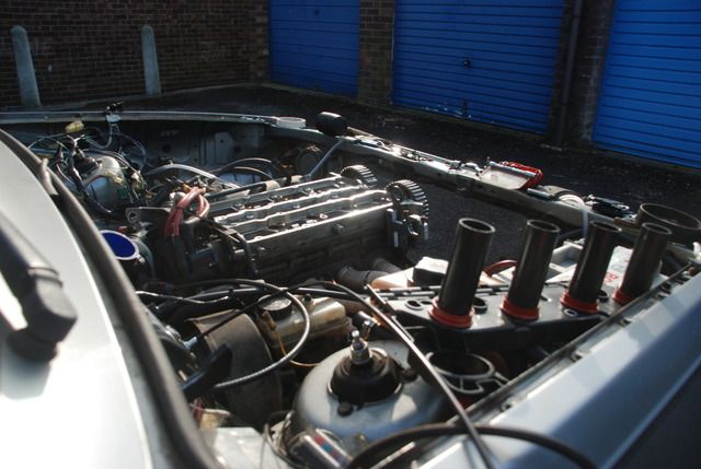

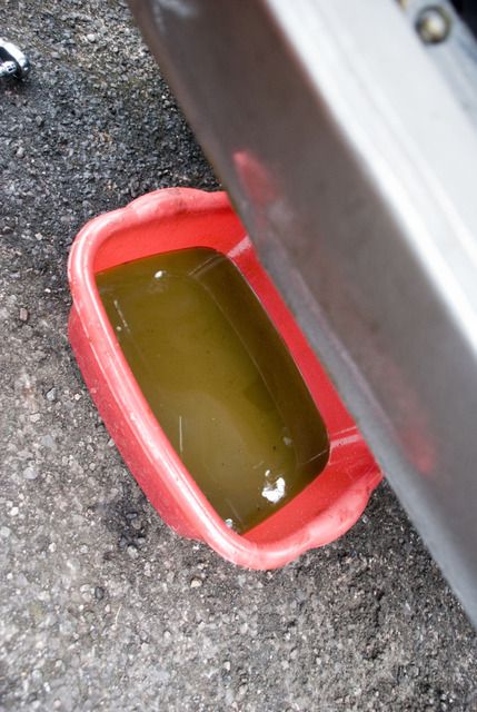

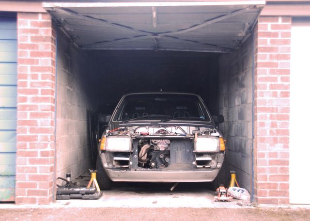

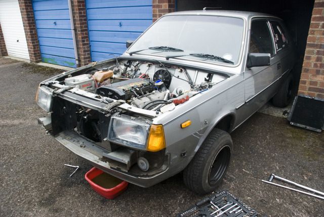

Meanwhile, I went to the shops in Derrick, and came back and started up, to find A LOT of smoke/steam coming from the exhaust. Thought it would burn off. It didnt. Ahhhhh! Panic!!! Got him home ok, as the temp started to creep up. Shed loads of steam, and a tiny amount of oil in it. Opened the bonnet to find a boiling header tank, over flowing.
I found out the next day the thermostat had stuck closed, causing coolant to back up and just boil on the spot, warping the head (as far as I'm aware). No head gasket split, just enough gap to let coolant through. This was confirmed by the removal of the stat housing, bone dry one side, soaking the other side. Guh. A little miffed, as it seems as though the head gasket was only recently done, as it looks pretty much brand new! Still, needs to be done!
Benefits of the head being off is that I could give it a nice good inspection. Honing marks are gorgeous, no cracks (thank God!) and the biggy . . . fully ported and polished head! Winner!!
So I'll give it all a clean, dry out the pistons, skim the head, replace the stat and water pump, put it back together and change the oil. Sods law I serviced him only a few days before! *Facepalm* It'll take a little while to get him going again, as I'm taking the opportunity to do other stuff on him, like fuel cell stuff, new fuel lines, and new brake fittings and stuff. Finally got a new master cylinder ordered, took me ages. I'll also plumb the hydro in since I'm doing that. Got a lot of work to do! :lol:

While I'm getting everything to sort the HG out, I finished off the new switch panel.

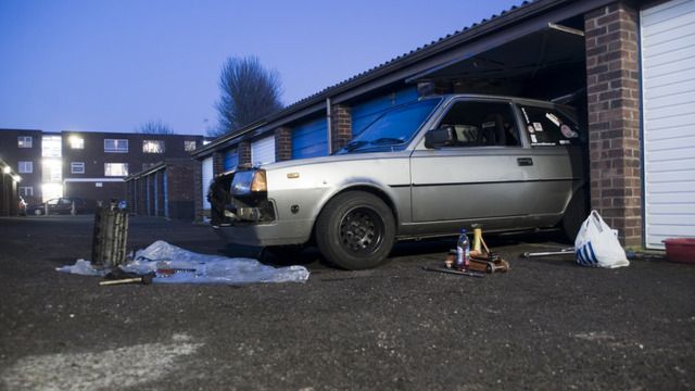

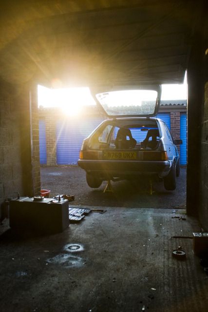

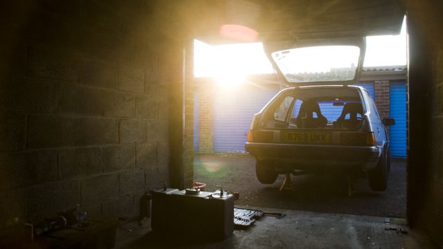

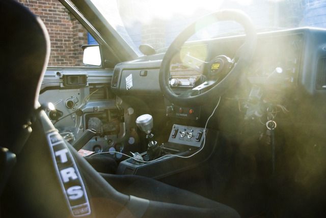

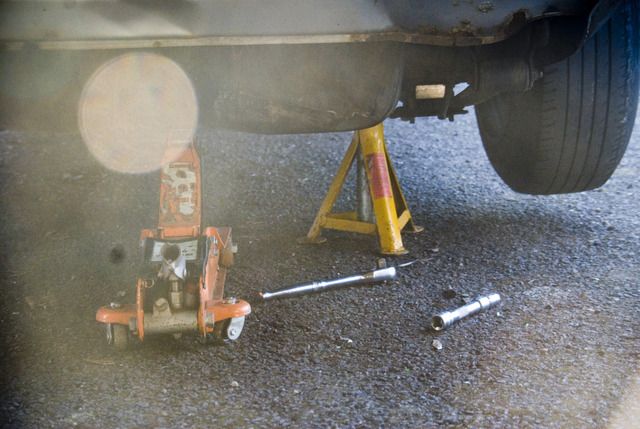

Had a good day working on the car today. Wired in the dash fully, so everything works (bar the pressure light, can't seem to find where to get a signal from), took off the old fuel tank, and measured up the in-car one. The old "empty" fuel tank ended up having 11 litres in it!! A fair few squash bottles later, and its empty. Also got the indicator stalks on, and seem to suit it pretty well.
(Don't worry, had the jack supporting the tank as I un-did it, the axle stands are taking the car's weight!)
The only downer today was finding that the water pump bolts are a random size and pitch. Grrrr. That and I didn't do any coursework. Woops :lol:
