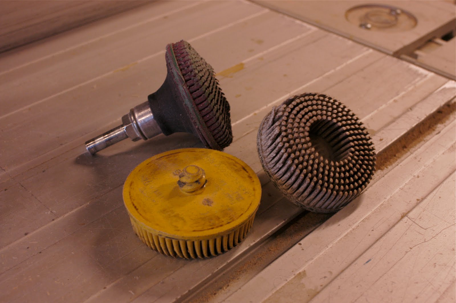

that goo on the ends or any gasket residu can be very cleanly removed with these kind of brushes from 3M:
even residue from the original paper gaskets will easaly be removed with this. the beauty of these brushes is that they don't damage the aluminium surface, there are different colors for the hardness. i generaly use white (soft) and purple (harder) brushes
i would reccomend taking the rocker arms apart for a cleanup or swapping it over from the old head, would be a shame if the oil port was clogged somewhere
